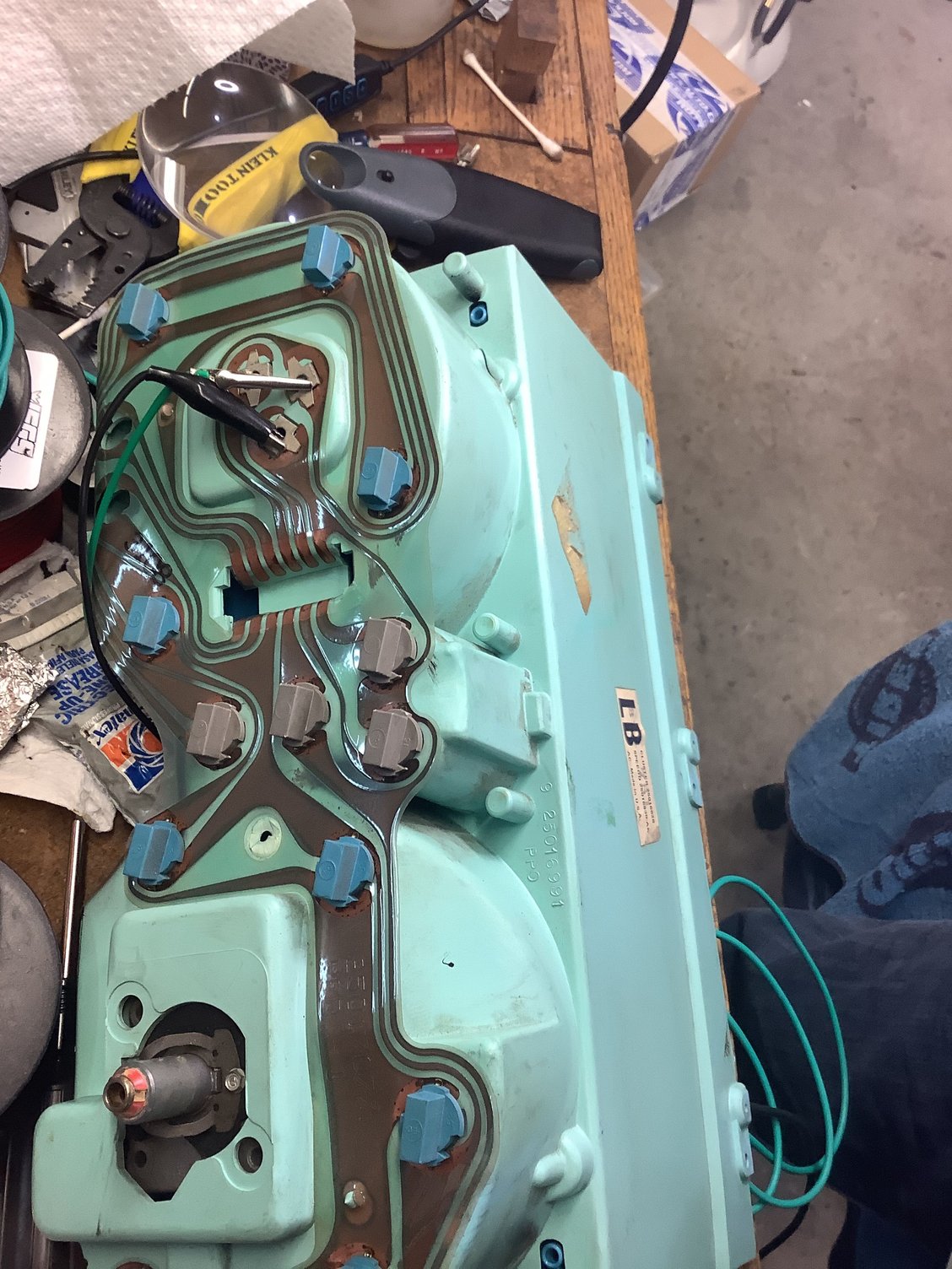

From: Greenville SC
Why have you got those alligator clips attached?
Old Apr 6, 2021 | 03:33 PM
interpon's Avatar
interpon
Joined: Jun 2019
Posts: 7,658
Likes: 2,470
From: Indiana
to reset '0' calibration
