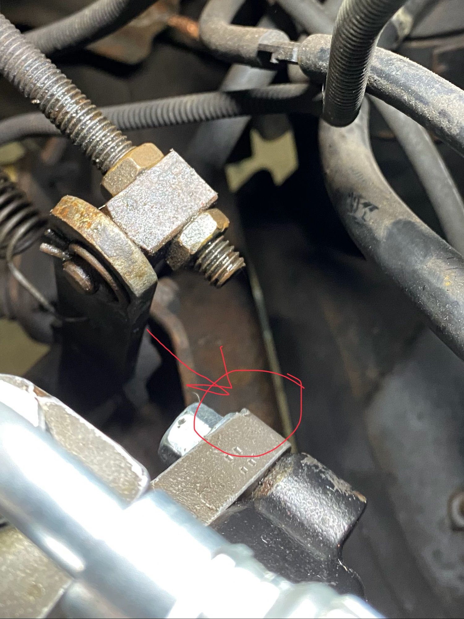

Here is a better picture of the issue. If you look close you can see where the Z bar made a little dent in the metal of the steering box.

You are within 1/4 inch. I think there is to big of a gap where the hinge point is. Right where the other end of the arrow is in your picture.

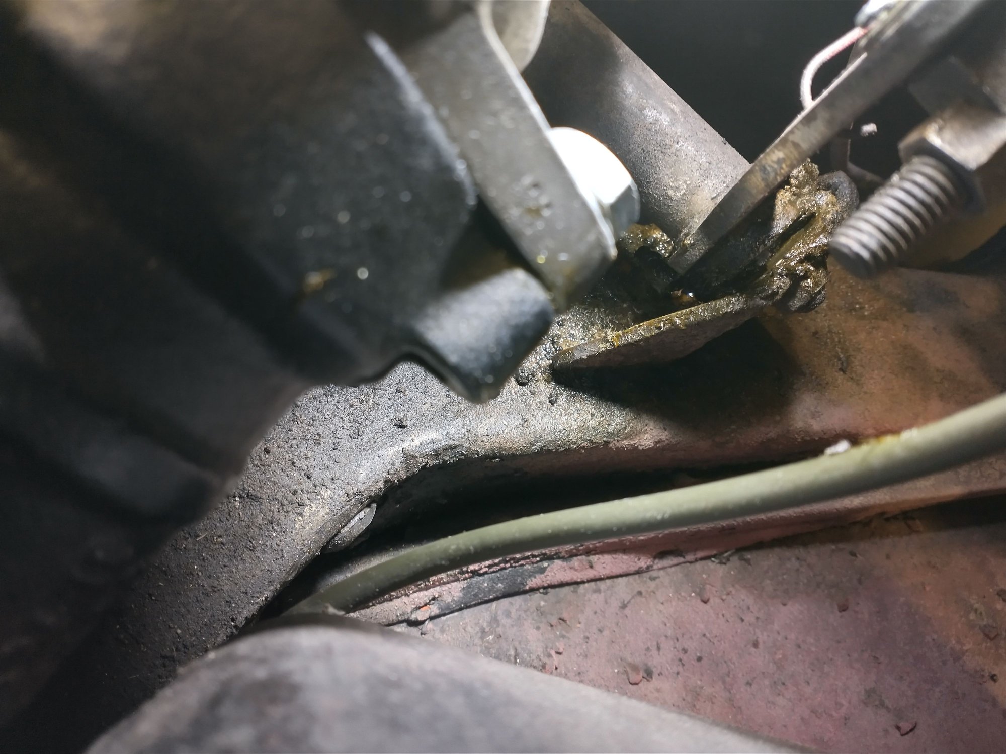

Old Apr 9, 2021 | 09:52 PM

I'll have to take a close look at the Z bar tomorrow and compare to your picture

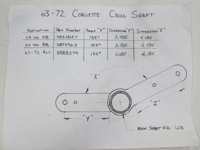

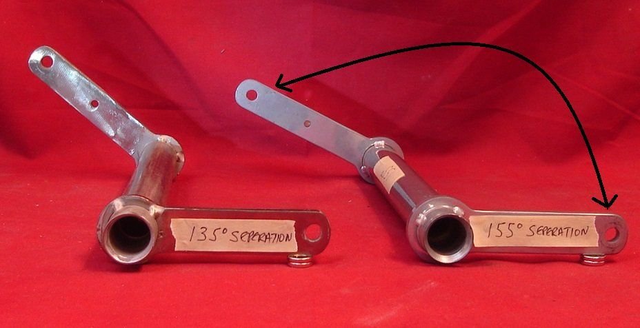

Maybe this help and compare to what Z bar you have.

Good idea, I’ll check that out
