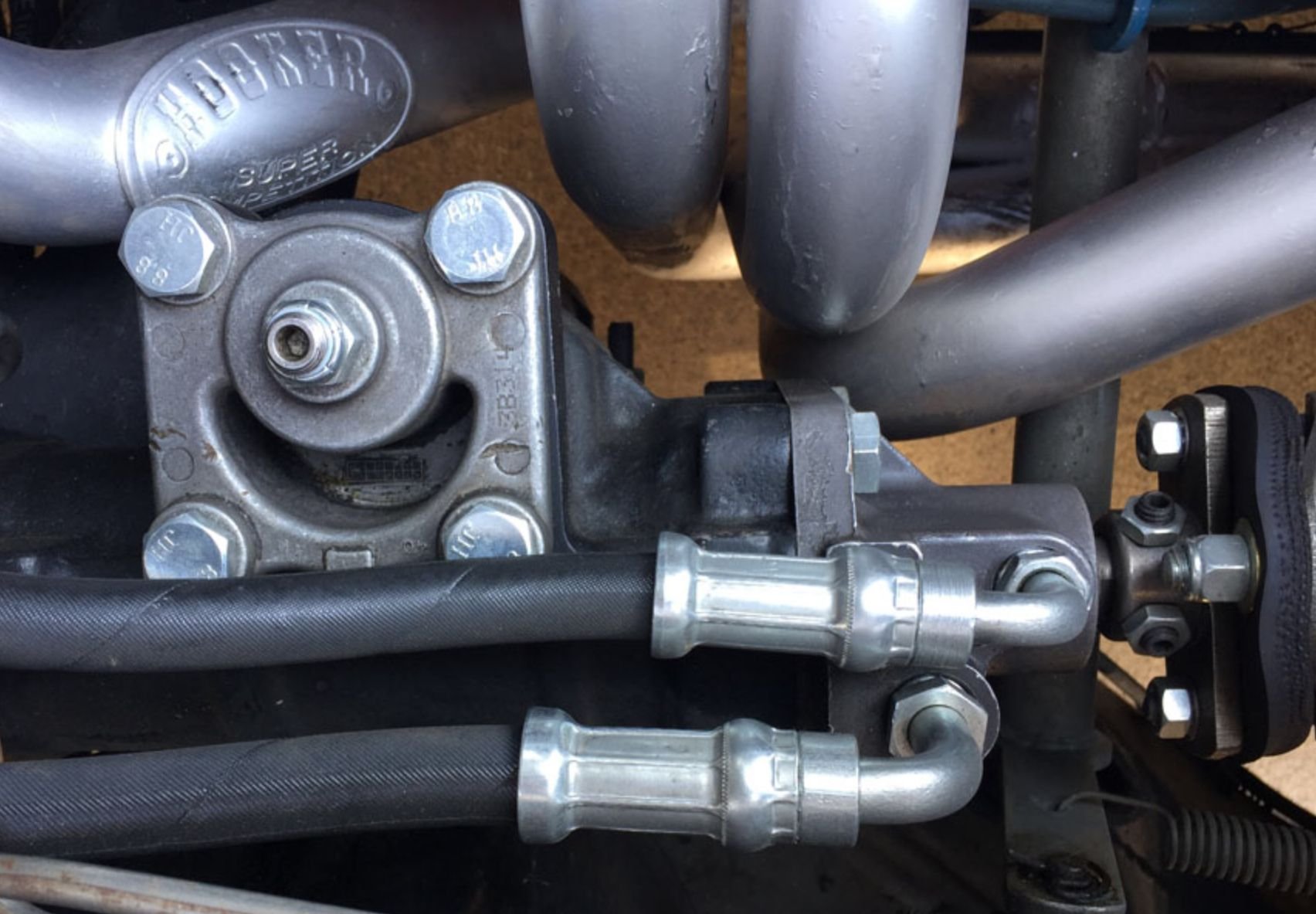

For what’s it’s worth, here is the Borgeson steering box in my late 1969. No clearance issues with the Z-bar or the Hooker headers. This was a non-power steering car.
