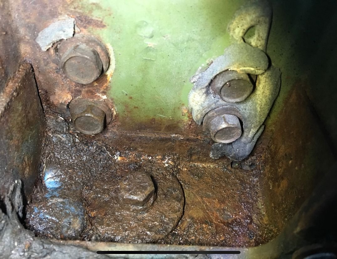

Hey all,
I'm still hunting down some vibration and I was wondering... behind the kick panel, shouldn’t there be a rubber bushing above the birdcage as well ?
This is a 1969. Is it possible it didn’t come on this year ?
I also heard that in 1969 the bushings under the cage were made out of aluminum. Is this true ?

Searching around on other posts... it seems to be correct. There isn't supposed to be a bushing above the birdcage.
That leaves the question about the aluminum...

I pulled my kick panels last weekend and my ‘69 looks just like yours, with less rust, but the same configuration. The bolt and washer clamp against the birdcage which sits on top of a large aluminum bushing that sits on top of the frame.

Yes there is no rubber bushes on 68 to 72 Corvettes. You both have original set up body mounts. But there will be shims on top of the aluminium bushes under the sill panels.
Of course badly rusted cars can just have a big blob of rust that were shims originally..

Dorian, to be clear your rust is not horrible in fact it is not bad at all and does not look to have impacted structural integrity at all. Removing the bolt may prove to be a bit of a challenge if you were so inclined, but I don’t want our comments to cause you to think your birdcage is about to fail!

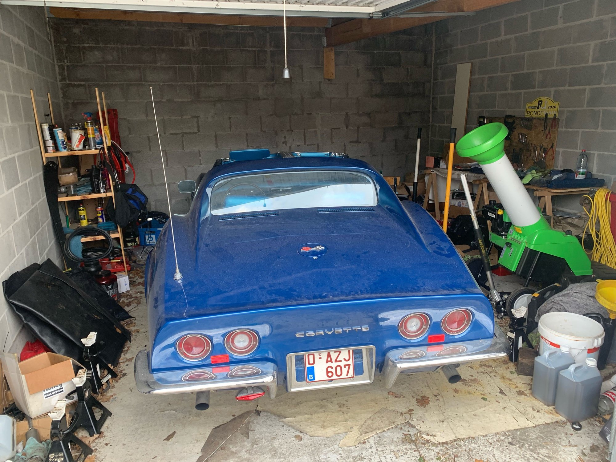

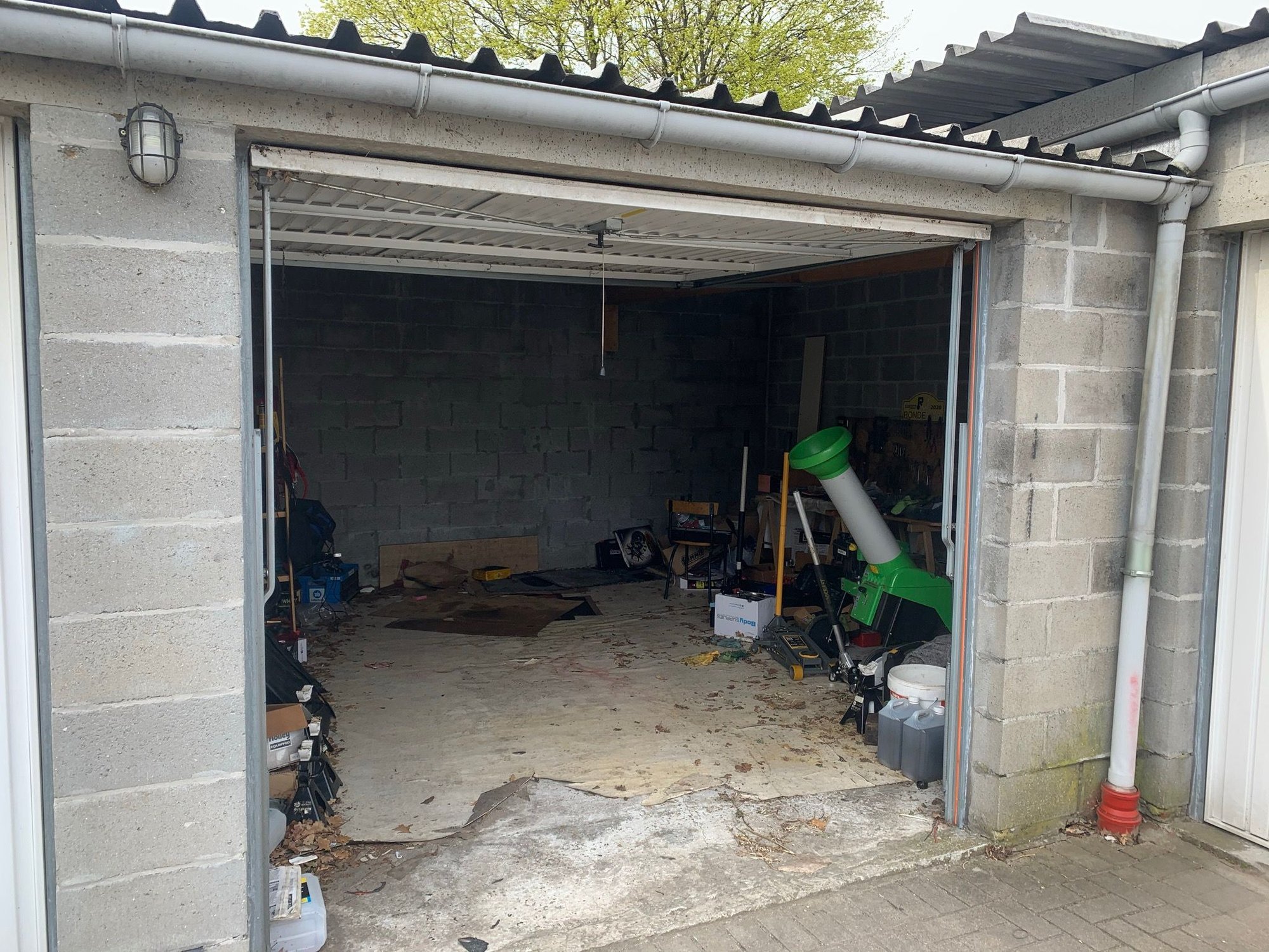

Don’t mind the mess

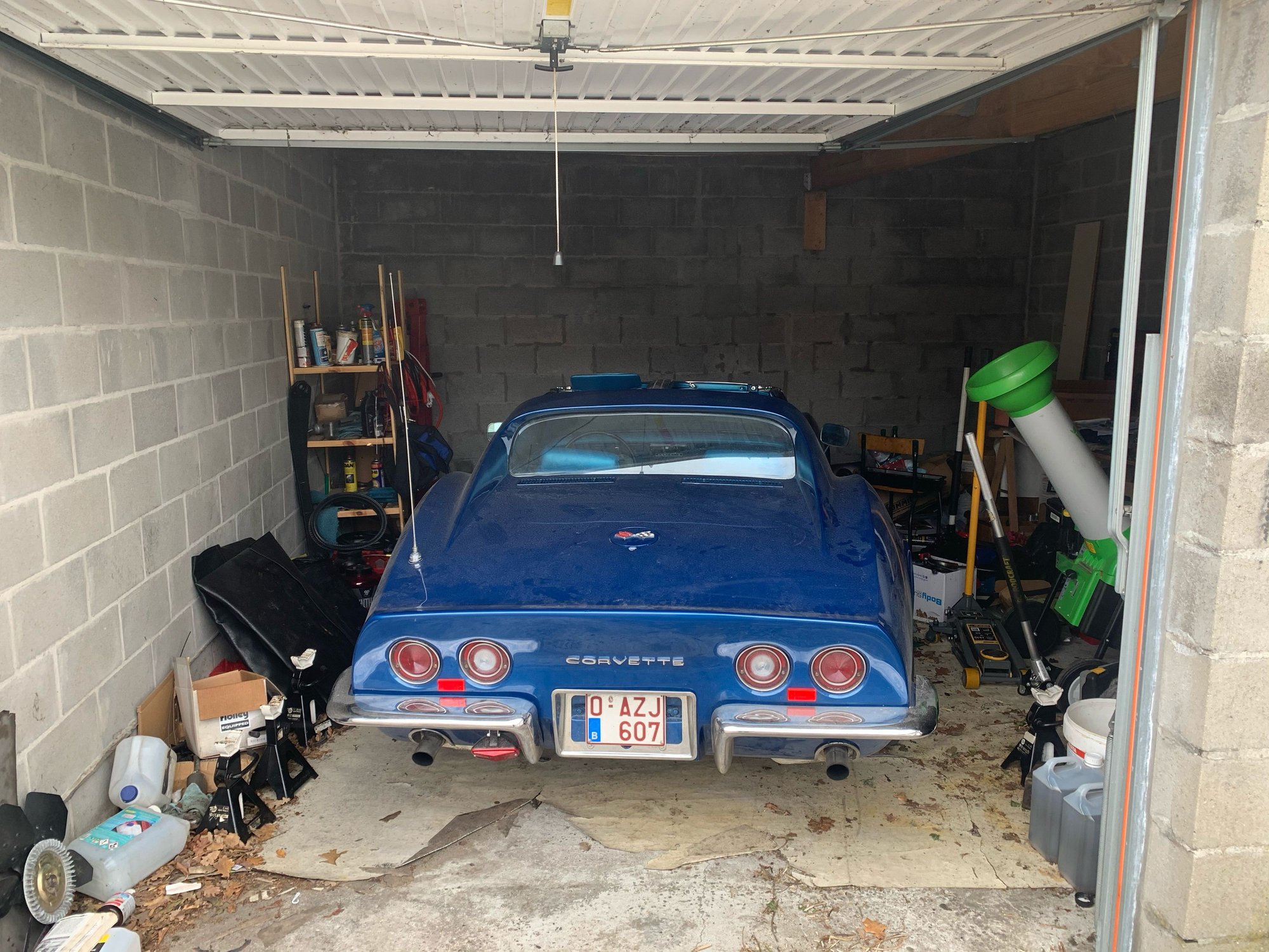

You actually have enough room to work on the car if you enter the garage closer to the right side of the door frame.
And you would have even more room to spare if you installed shelving on the right-side wall....and /or wall anchors with hooks to hand all the "stuff" up high out of the way

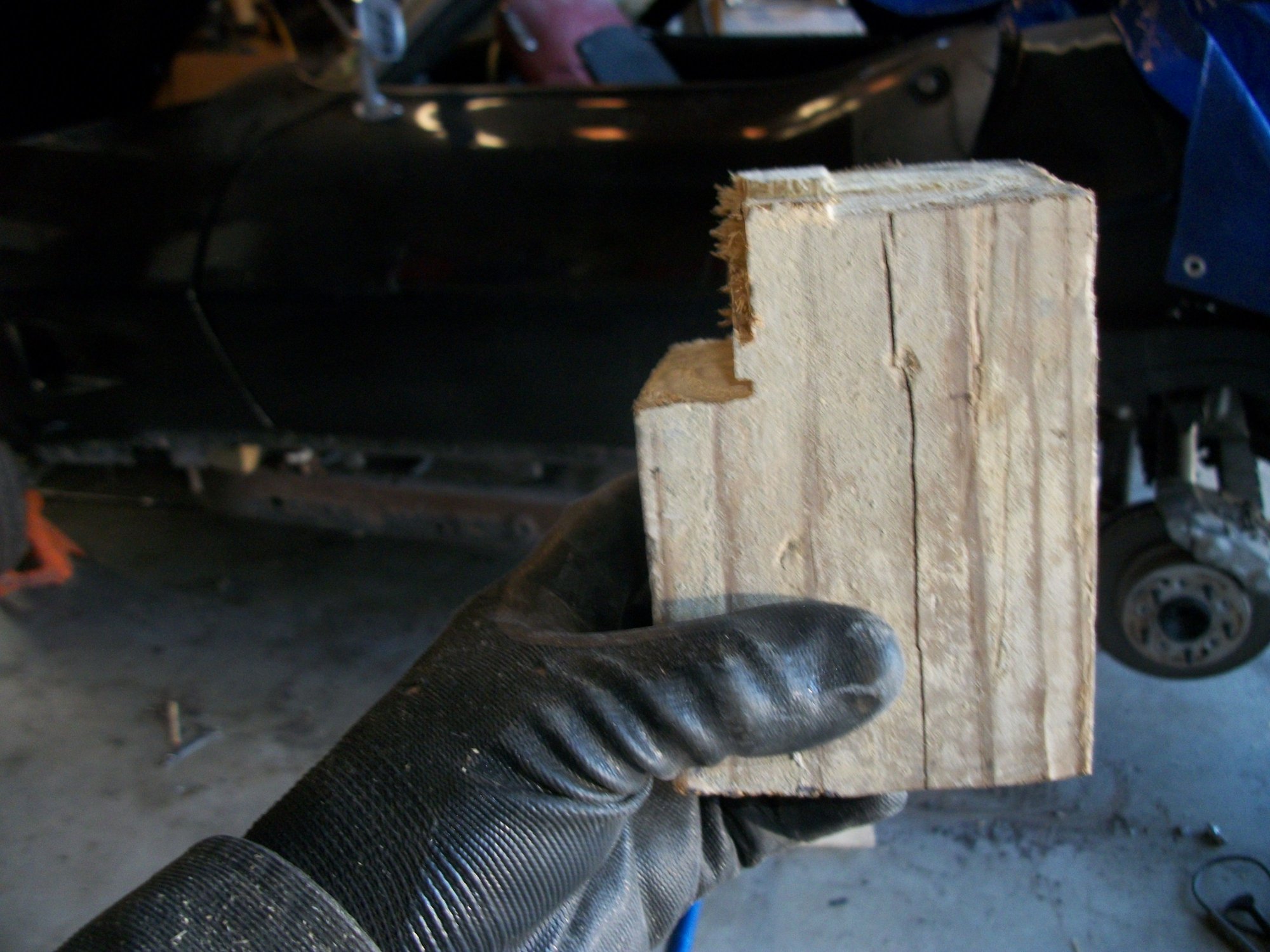

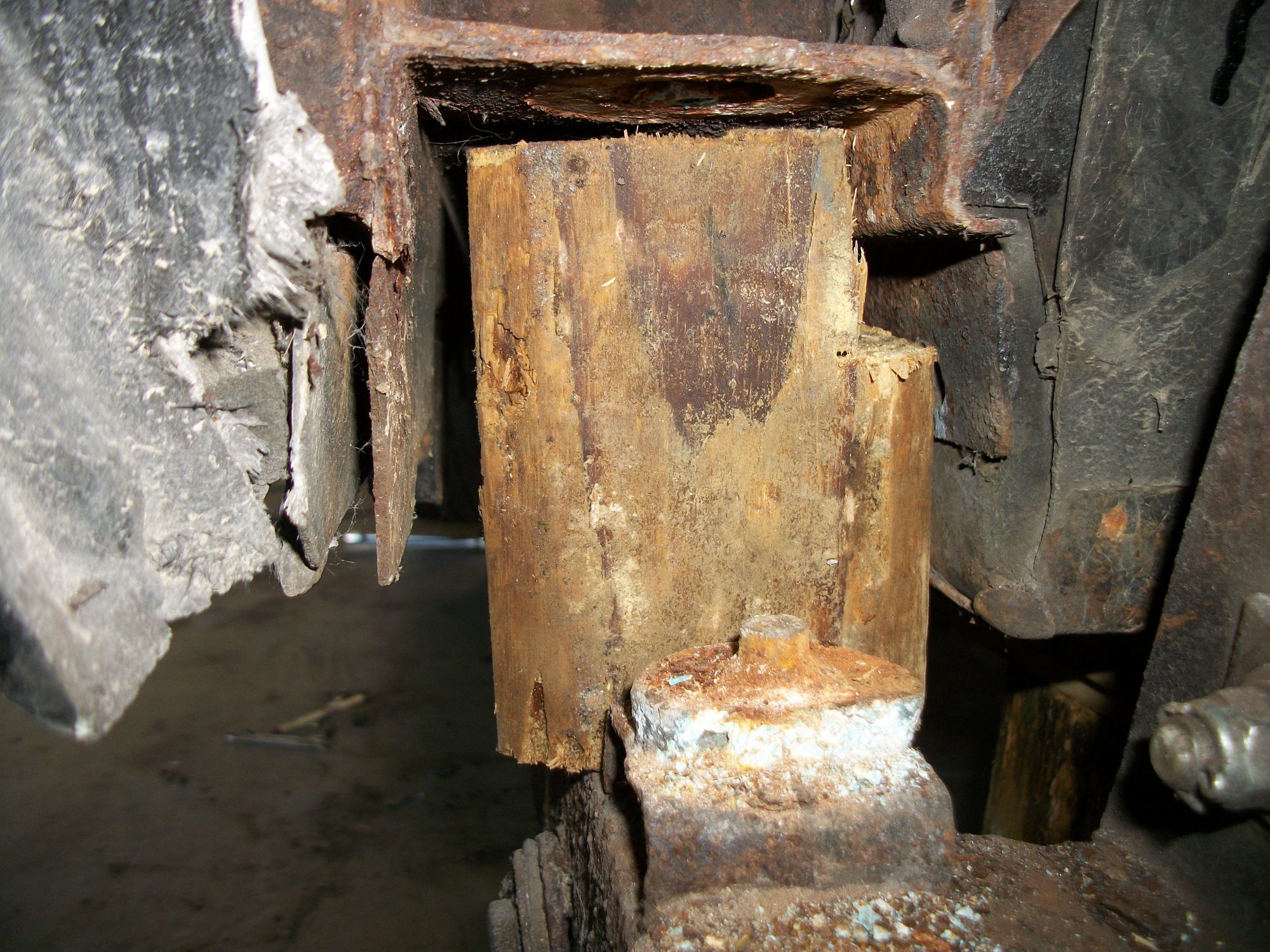

Actually...you can cut some 4" by 4" by 4" tall pieces of lumber..slowly lift the body and place the pieces between the body and the frame.
Then cut some 4" by 4" by 8" tall pieces of lumber....lift the body higher and replace the 4" tall pieces with the 8" tall pieces....
Then you will have plenty of room to make repairs/weld braces in place/etc
These are "rough-cut" 5" tall pieces....I was able to make repairs, but 8" tall pieces would have made repairs much easier.......
NOTE: THE NOSE SECTION AND THE REAR SECTION OF THE CAR WILL HAVE TO BE SUPPORTED ALSO TO PREVENT FIBERGLASS DAMAGE FROM THE WEIGHT OF THE SECTIONS DURING THE REPAIR PROCESS.

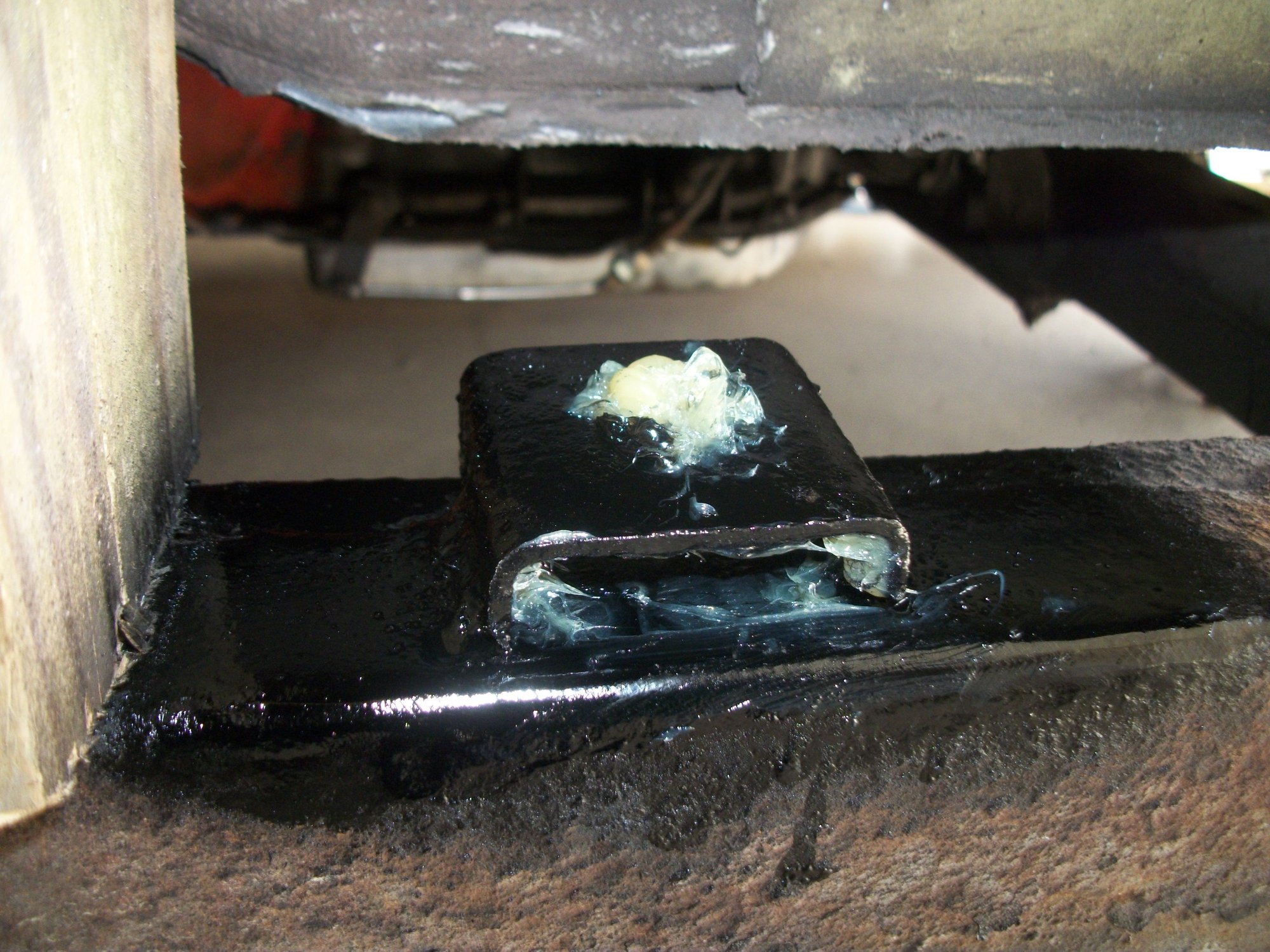

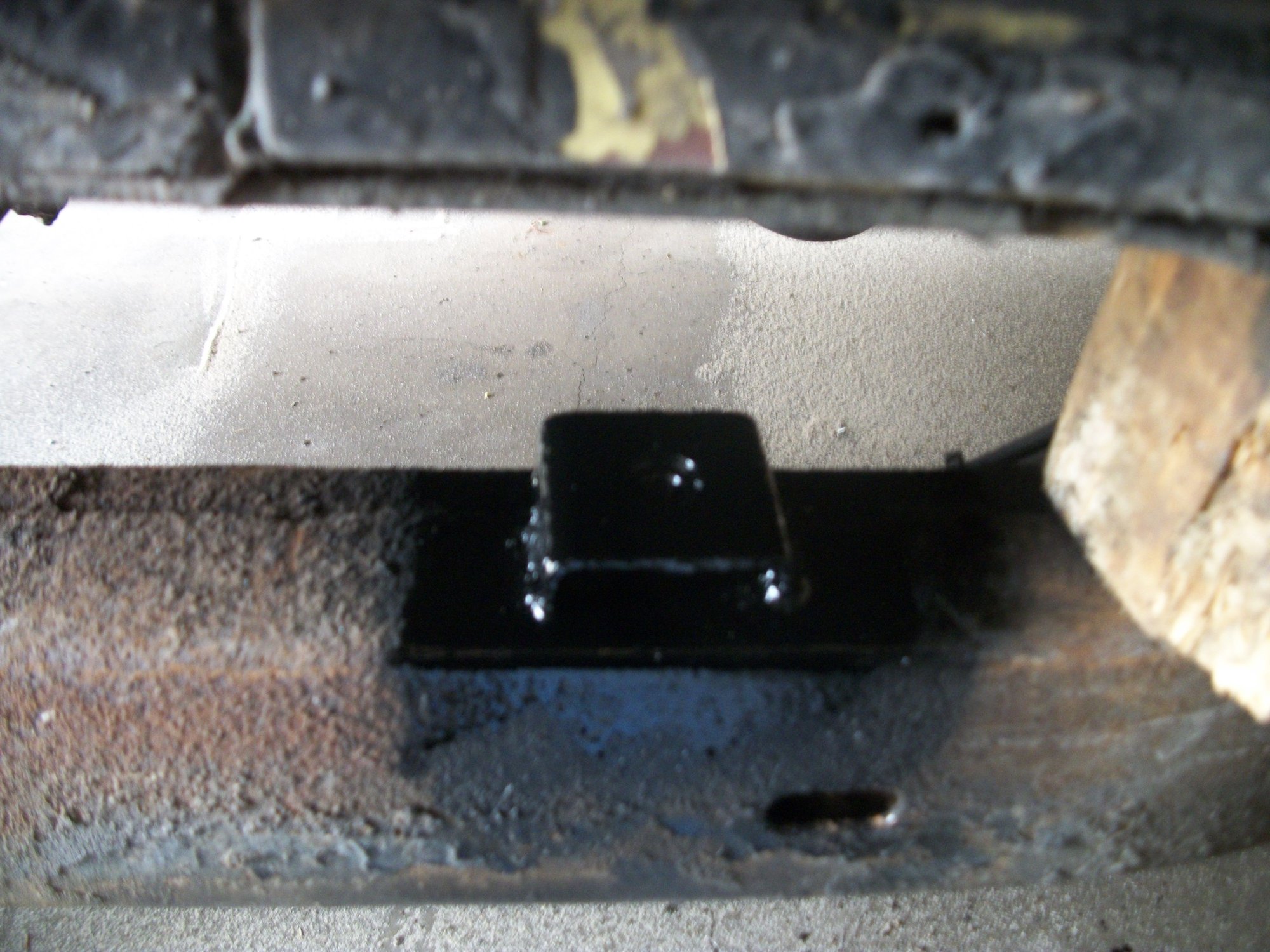

How about that Aluminum spacer?! I found one that wasn't rotted. Because it's a Resto-Mod I rem oved the original floating cage nuts and welded Wwld-Nuts in their place...then welded the original brackets w/ Weld-Nuts to the frame,,,,,,,,and coated the repair with bearing grease......
