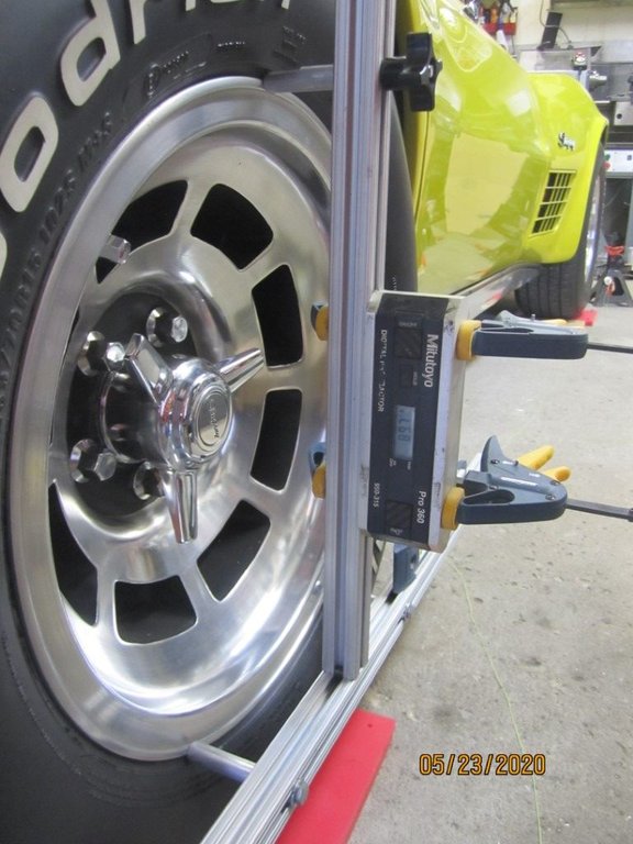

Well its not that hard to take DIY alignment measurement. With simple tools it can be done in ~ 5 minutes.
Basic items needed.
1. smart phone with an angle app.
2. DIY straight edge to mount to your wheels.
3. laser level (toe readings)
4. 2 tape measures.
5. 4 equal length spacers (the longer the more accurate toe readings)
here is my detail DIY alignment measurements.
When I worked on this process I used my dealership alignment rack to confirm process. The dealership charged me $30.00 for them to take measurements only.
Since you have you alignment print out, you can see if you get the same results. If you are able to get similar readings then you are ready to make adjustments and feel comfortable in the DIY Alignment.
My DIY Alignment method - CorvetteForum - Chevrolet Corvette Forum Discussion
You can take all readings.
1. Thrust angle
2. Caster / Camber
3. Toe.

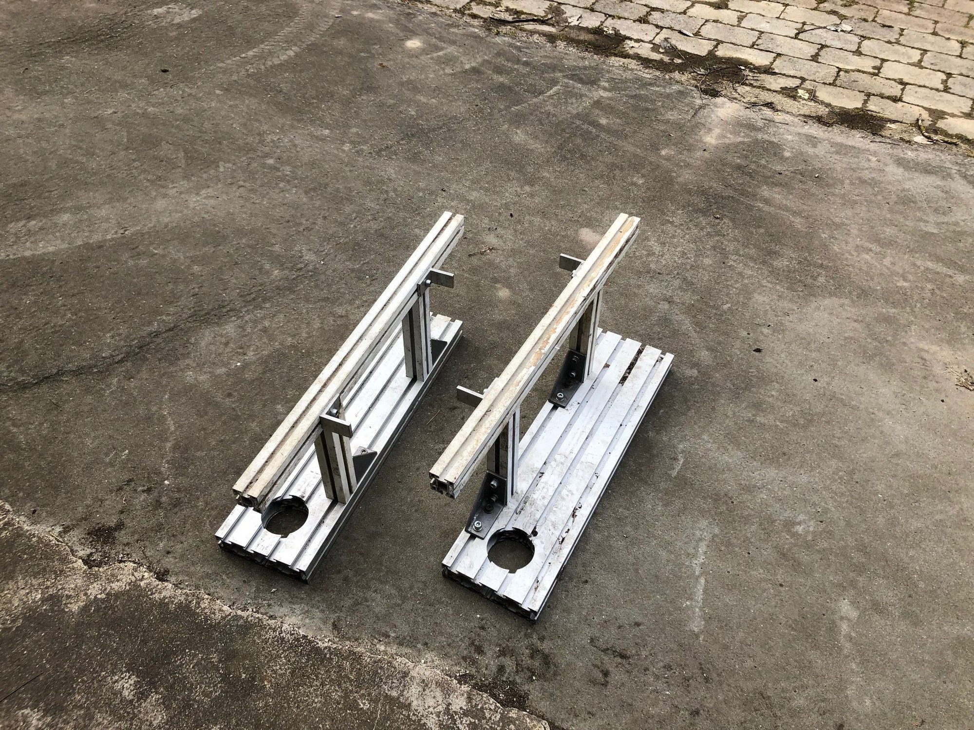

Great post - It inspired me to make two toe measuring tools out of some left over alu profiles.
I just need a pair og longer profiles to attach so I can get a more accurate reading.
I also did a camber tool out of a digital spirit level a while ago.

Always handy to have some 8020 around
Made these up last year while trying to get the alignment dialed in with much help from cagotzmann and others
https://www.corvetteforum.com/forums...ocation-2.html
M
