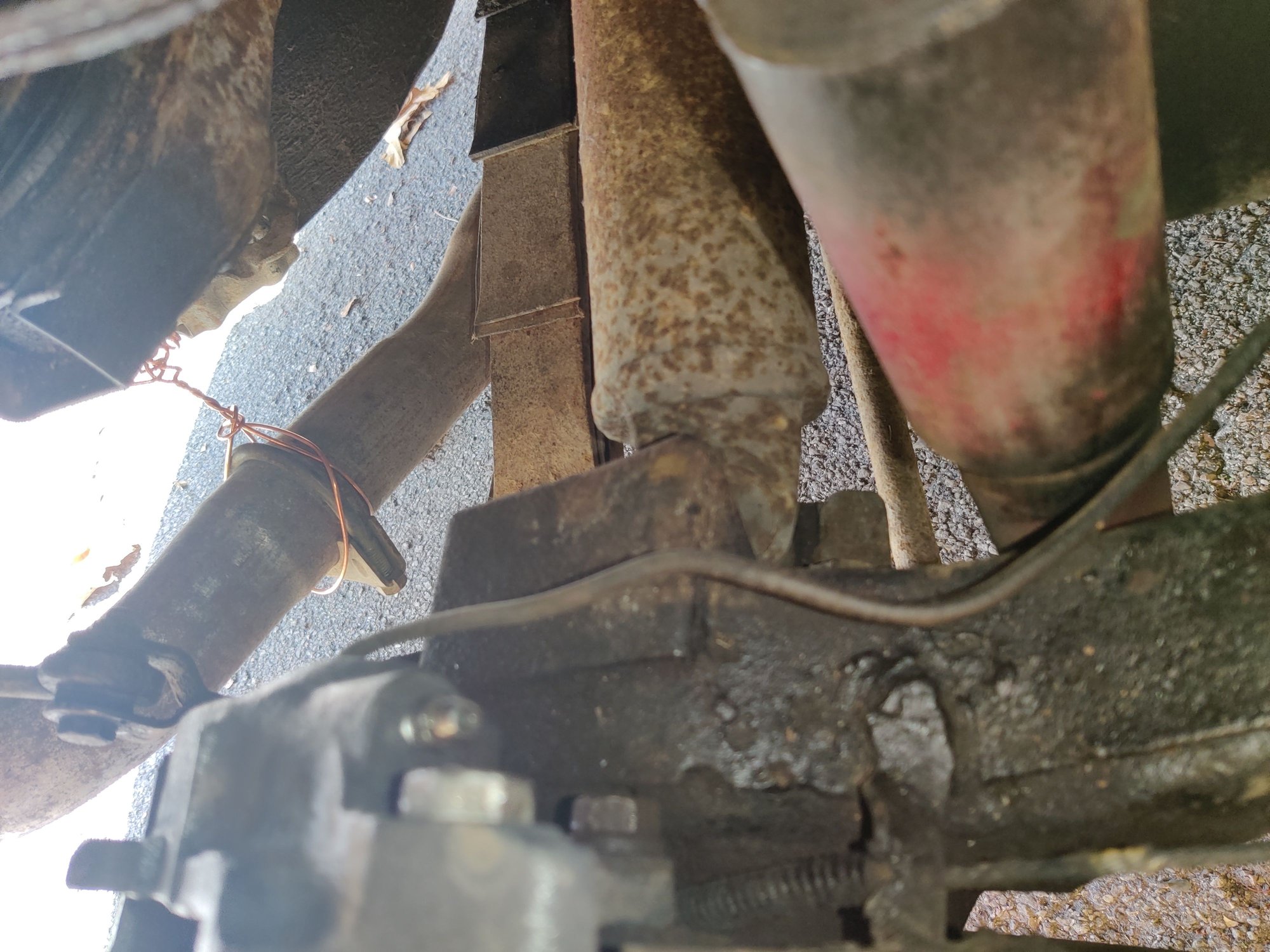

Bouncy, or vibrations in the rear? I'll bet you need new shocks. Almost all C3s do unless the have a fresh set of Bilsteins or better. Vibrations could be a siezed U-Joint.
It took three tries rebuilding the parking brakes of my 79 to get them to pass the VA safety inspection. Hopefully yours are in better shape. You can remove the calipers without needing to disconnect the lines and re-bleed, but I bet you need new brake hoses in addition to tires.
Please post some photos of the rest of the car!

You can unbolt the calipers fom the mounts. Two bolts hold them on (the smaller inner bolts, the larger ones hold the caliper halves together).
Where the steel line meets the rubber hose, pull
the clip to let the union slide out of the mount on the trailing arm. Then you can ubolt the caliper and hang it out of the way with string or a bent clothes hanger.
I cut a piece of wood to slide between the pads to keep them apart, and make getting the calipers back on easier.
You really should replace the hoses, and flush the fluid, too, but hopefully this helps for the rotor and parking brake!

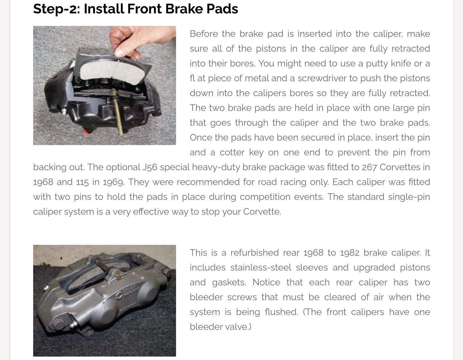

Quick question if all four pistons are pushed out on the caliper how can I push them back in and slide in the pad? I can push 1 side in for a pad but then i cant get the other side in the slide the pad down.

https://www.chevydiy.com/brake-syste...oration-guide/

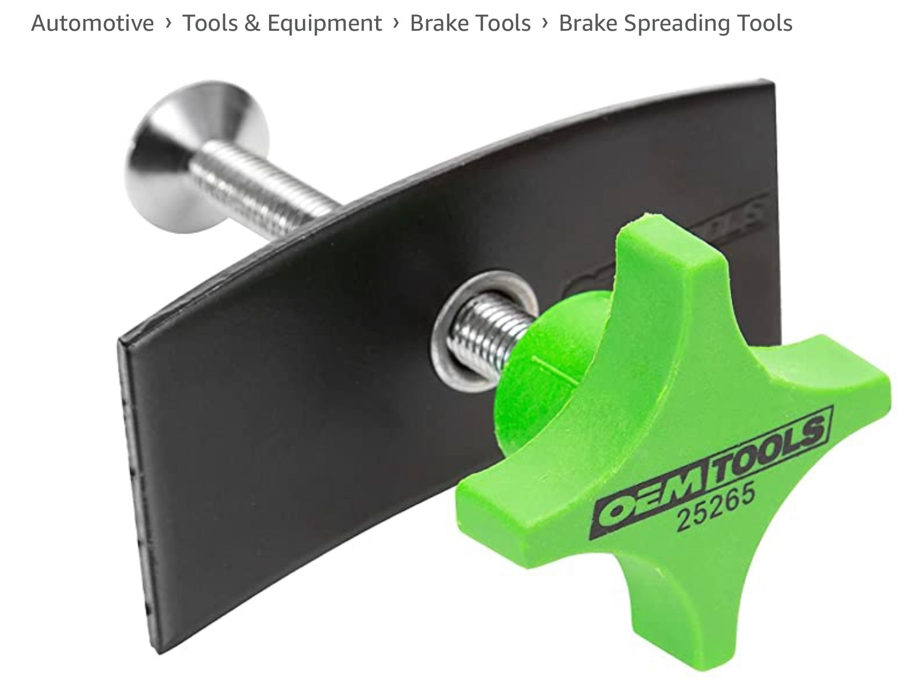

If you’re a tool geek like me:

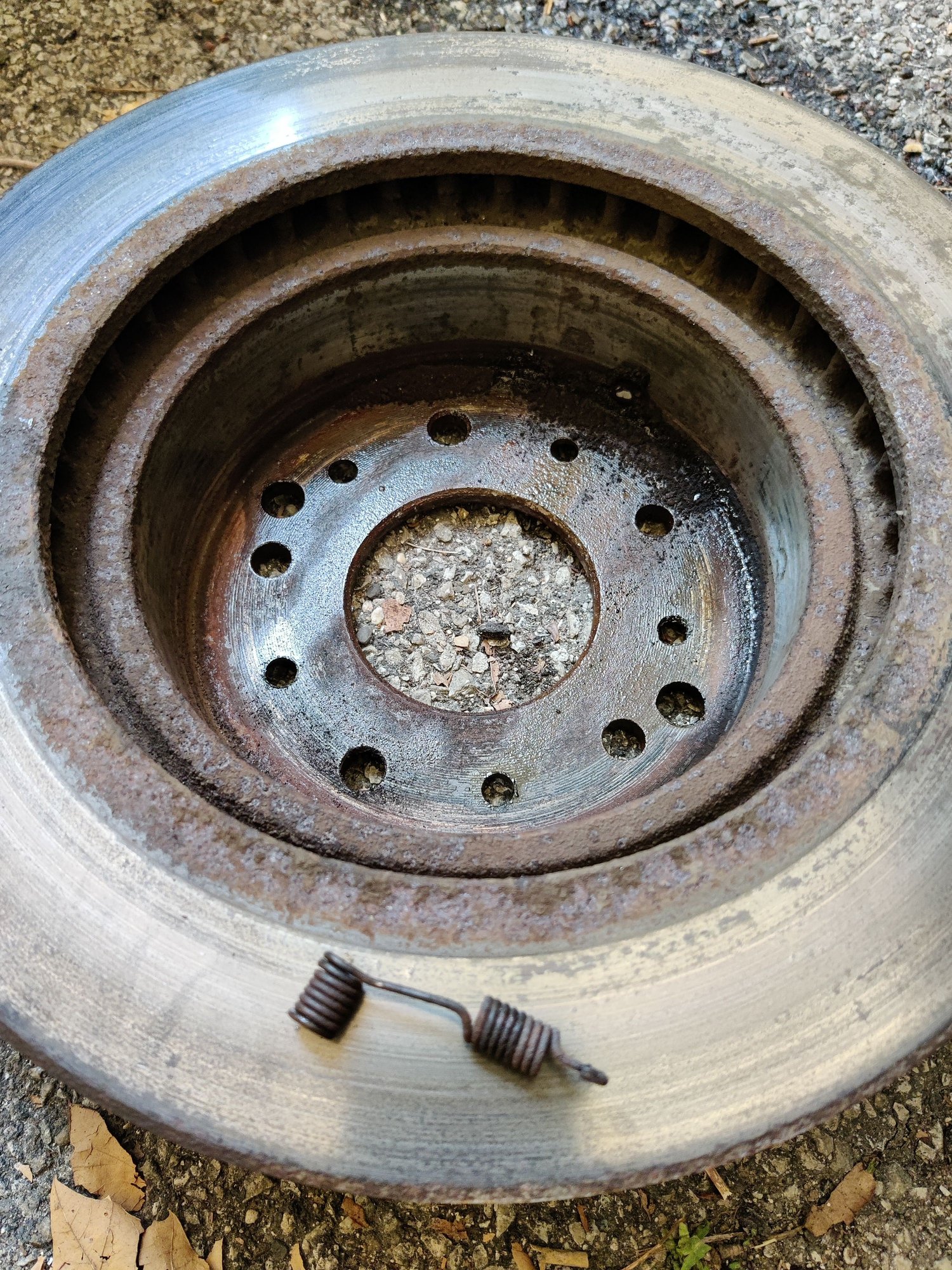

I was able to get the rotor off and I found what was scraping in the hub

Now i just need to figure out how to pull the shoes off
Get ready for one of the most hateful jobs possible with a C3 Corvette. Though that looks like one of the shoe linkage springs. You may be able to replace it without taking the shoes off, if you have a good pair of needle-nose pliers.
When you get a bit deeper, there are arrow-tipped pins that hold the retainer springs. One of them cannot be replaced without removing the backing plate, which requires removing the hub. So don't damage it. Search for "dental floss trick" on this Forum.
Good luck, and don't go deeper than you need to!

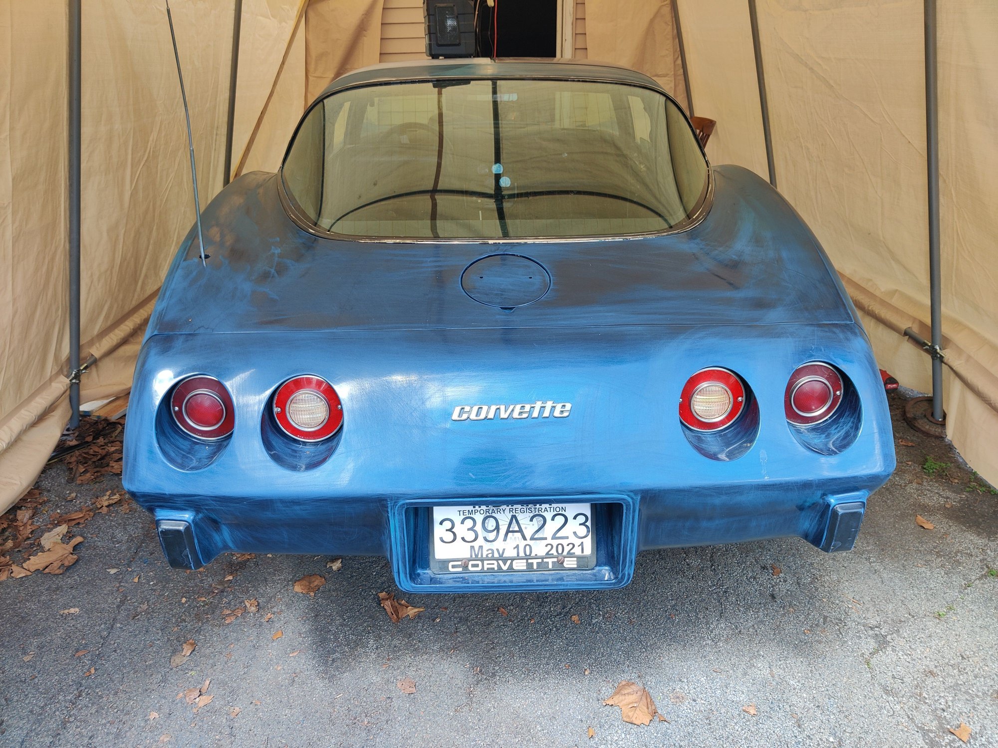

I'm having an issue with the right-side headlights. the right side turns light works just fine but the right side headlights both the low and high beam both don't work. I'm unsure where to look to figure out the issue and I don't think it is the bulbs because both low and high arent working.
I'm also having an issue with removing the rear emblem I have removed all the others without issue but I can't figure out how to remove this one.
Lastly, I am wondering if someone could point me to where I could find these style tail lights

i also suggest not touching the rear emblem..i tried..lost a nut ..no clue how to access without removing bumper
