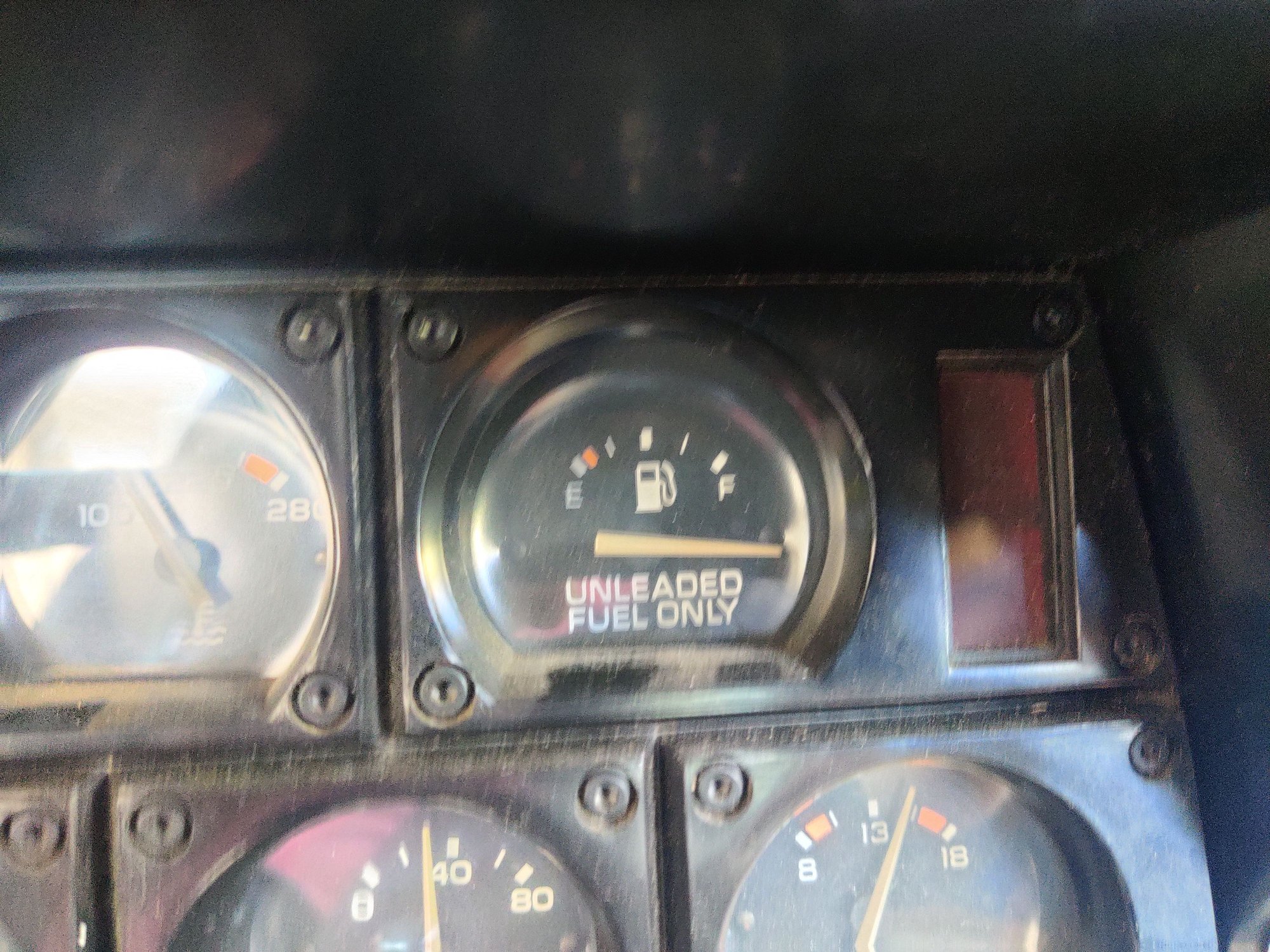

I'm sorry I meant gauges, not gadgets. mainly the fuel gauge it bounces all over the place.

Need further troubleshooting on the fuel gauge (do a search) may be the tank sending unit.

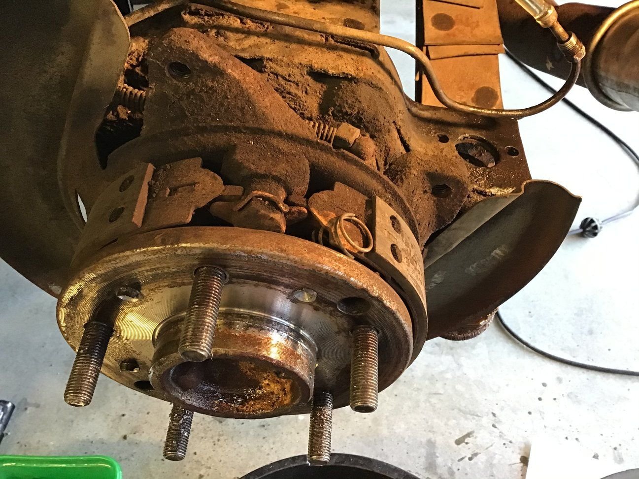

These are some photos. I have some videos with the sound coming from the backside and a sound coming from the engine but I'm not sure how or if I can upload videos.

I'll throw a dart at the squeaking as the brakes,,, shot pads or parkbreak parts fallen off into the drum,, have you pulled a wheel yet???
and put some 15x50 wally world mobil 1 full synthetic with zinc in it as motor sounds like mine and drive it after repairs..
brakes sounded like mine here..

79 L-82 4 speed 15 year owner here. Your wheel bearing noise might be the caliper moving back and forth on the rotor as the wheel spins. Mine has made that noise, and taking the caliper mounting pins out and greasing them fixed it. You might try that first, as that's really easy an cheap. My fuel gauge also bounces, but only about a quarter tank, not past full as yours is showing. I haven't gotten to the bottom of that yet. As others have said, the smoke sounds like it needs further investigation to see if you're leaking oil, or whether the head gasket is bad/cracked head, etc. Keep us updated and we'll see what we can do to help out. Oh, and REPLACE THOSE TIRES, yesterday!!!!

YEP! I see that spring gone arye , 👀 ,
Mine sounded like that, then a spring fell out. No more squealing,,😂

What tools would I need to fix the parking brake besides wrenches and sockets? Like how should I remove the rivets on the hub?

read the link on mine.. i put it in the reply above..including removing rivets.. read the many other threads on your issue(s) after you plan your fixes and or inspections..

@interpon ahhhhh is see so you have to drill the tops of the rivets out. Do you have to do anything with the ends of the rivets or does it matter if they stay in.

toss them..don't need.
before you remove NOTE how it cam off in case of any run out issues..put back on same way.. i use a punch and put a couple dots to align

Usually if a fuel gauge is pegged on full it is a bad ground

I was able to drill off all of the rivet heads.
