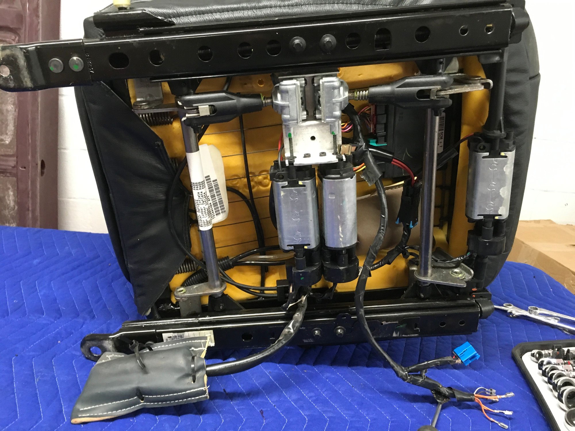

OK. You can get to the seat tracks without disassembling the seat. You just need to work a wrench up between the padding and the seat frame.
I already drilled out the front mounts that angle the seats back and removed them. When I trial fit the seats, they were still way too high.
There are four small nuts that hold the tracks to the seat. You can get a wrench in there and remove them without disassembling the seat bottom. I had already replaced the seat covers with my new seats.
You can see the four small silver nuts threaded partially onto the seat track studs. While I would lose the powered functions, I wanted to retain the lumbar and bolster functions. I carefully traced the wires and removed all connectors and other components that supported the seat track motors.
I then cleaned up all the wiring and secured the pumps in place. I used the original seat track mounting holes for four bolts. I used two thin nuts to retain the new rear bolts and two 1/4” spacers on the front bolts to recline the seat slightly and to provide a space for the wiring to pass under the seat frame.

If I was you, I would drill out the eight rivets on the original tracks and remove the four mounting brackets, reinstall the original tracks and see how they fit. I needed about five inches and got two by removing the four mounting brackets. You will have four inches with your drop and you may be able to fit and preserve the power seat tracks.
