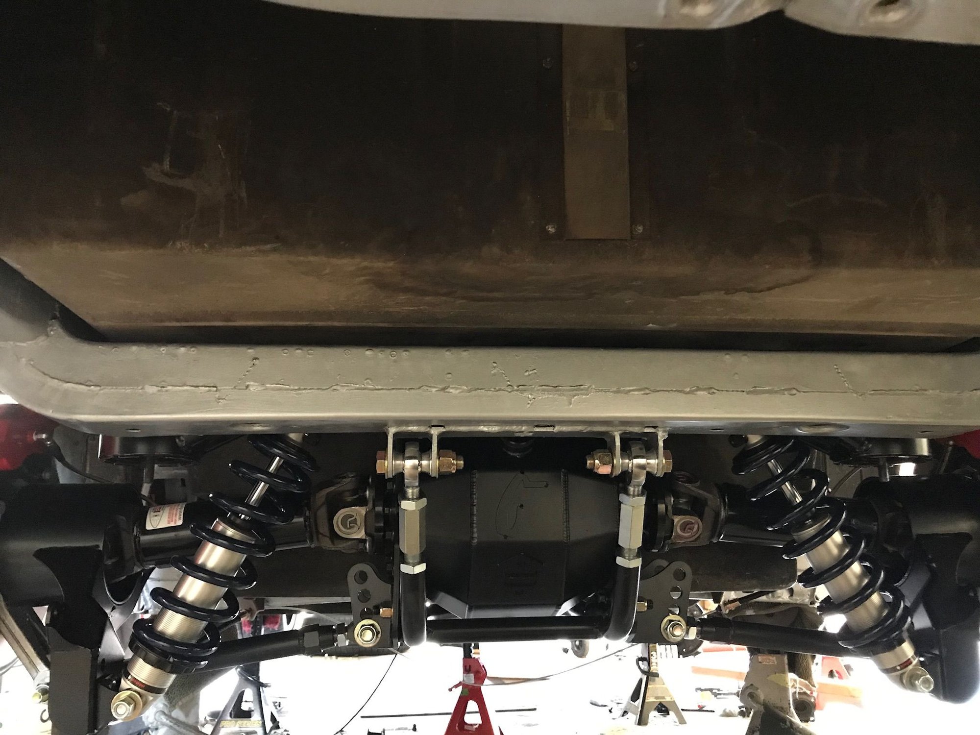

This is the Ridetech set up on my ‘64. Forget the diff mount, that is part of the Track 1 set up. Ridetech uses an upper coil over mounting frame that bolts into the sombrero bushing mounts and angles the coil overs for better geometry. Van Steel uses reinforcement for the upper shock mounts that are functional, but not ideal from a geometry perspective. However this really only matters for all out road racing. VS gives you a great solution for a more reasonable price.
I did not know that you could angle the coil overs on the Ridetech. I'm going to try to find this setup and price it for my 77. Man, that looks good!

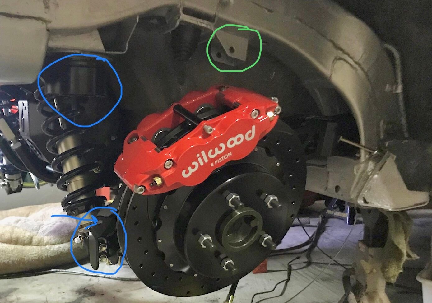

Here is a side view to compare the geometry.
VS coil overs sit ahead of the axle. Ridetech sits aft of the axle providing better geometry and range of motion. You pay a premium for Ridetech’s engineering and beefy extra components.
The green circle is the oem upper shock mount. VS includes a reinforcing bracket and this is where their upper coil over mounts. It is ahead of the axle as is the oem lower mount meaning the TA has a leverage advantage and it requires a stronger spring with less travel range. The upper blue circle is the sombrero mount and one end of the Ridetech upper coil over mounting frame. The lower circle is the lower mount at the end of the TA. The arrow shows I am using the lowest ride height.
