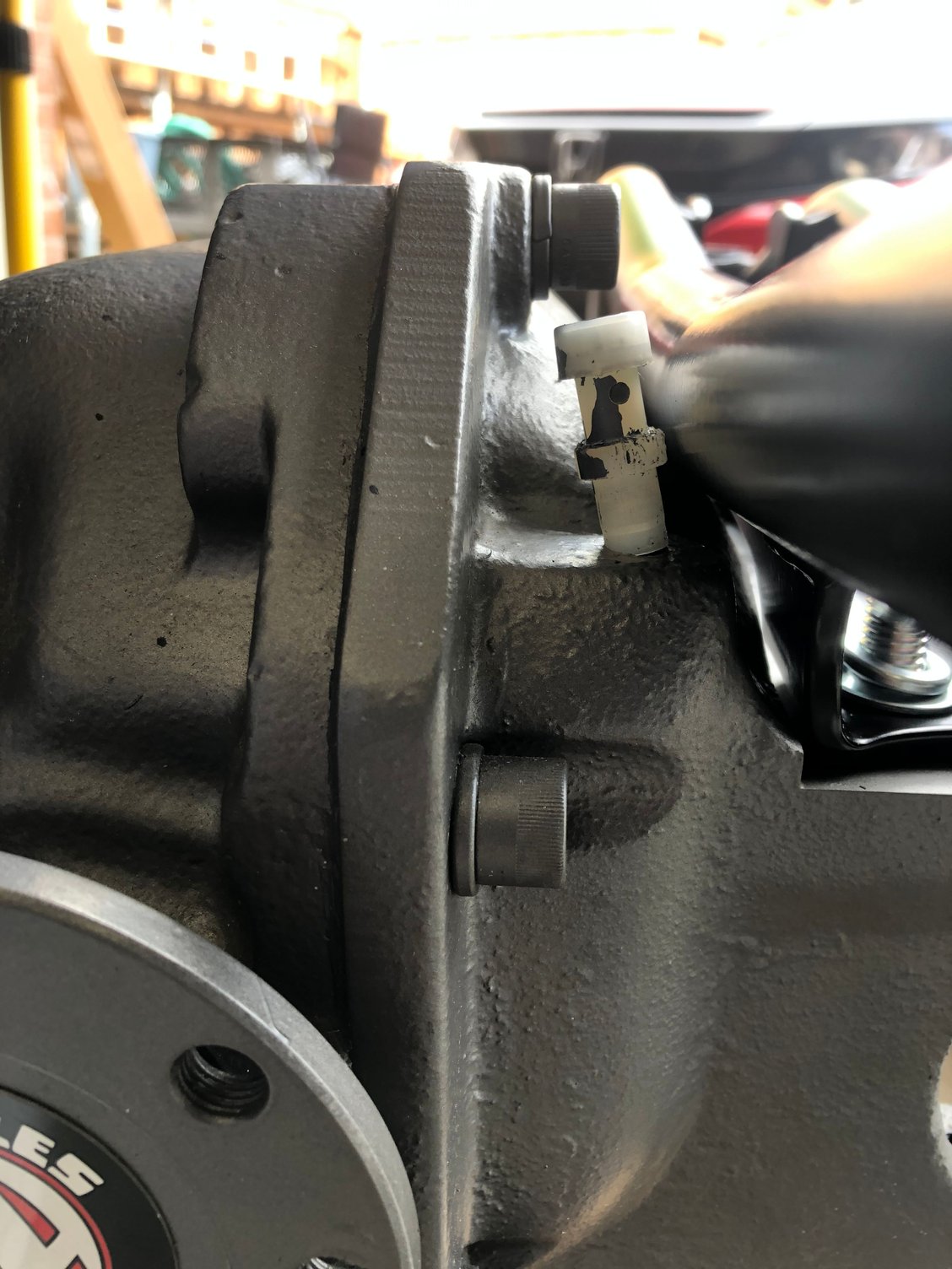

As others have said, and Ridetech, you don’t need the rear muscle bar unless you are racing the car. The only fit problem I had with the rear kit was the breather hole on my Muskegon diff cover. Evidently the factory cover hole is closer to the front of the car and the Muskegon to the rear. Sent the cover back to Gary to plug and drill a new hole. Probably could have found someone local but since he built my Super 10 I felt better about sending it back to him.
69ttop502, I must have gotten your bolts as my kit came with a couple bags labeled for C3 only. Lol.
