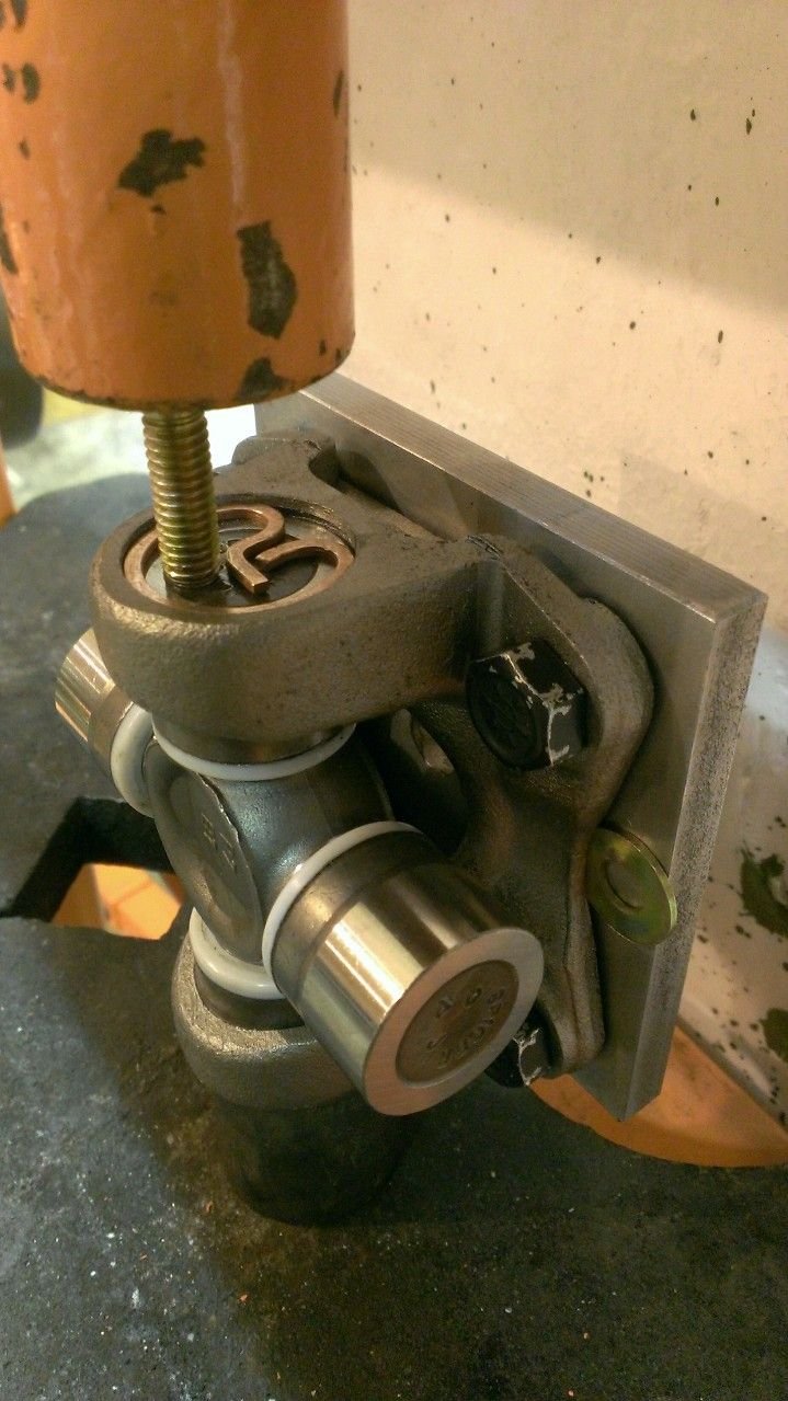

The Spicer u-joints are giving me hell though.
I'm using the thinnest copper clips and I could barely fit both clips into one flange. As for the second flange, so far I simply have not been able to squeeze in the second clip, even while compressing the u-joint hard . I may have to purchase a new flange and new u-joint.

so here's where I point out that, just like the tapping we did to align the caps, you can spread the yoke apart... a few taps and it'll go where it needs to be... remember, the looser it is, the more vibrations you'll have.

Thanks for the tip SBG. I gave that a try yesterday evening.
I put a couple of washers between the flange and support and tightened the 4 bolts (not like a nut) to attempt to separate the yokes a bit. I also gave both yokes a series of taps. This gave me goose bumps as it negates the purpose of the backing plate.
Still couldn't fit in the second clip. I'm missing around 1/32".
Oh well. No big deal. Next time you visit my digs, maybe we can try more drastic measures .

You hear this a lot, but I'll say it again, you're going the wrong way... spread the yoke, not press the u-joint
