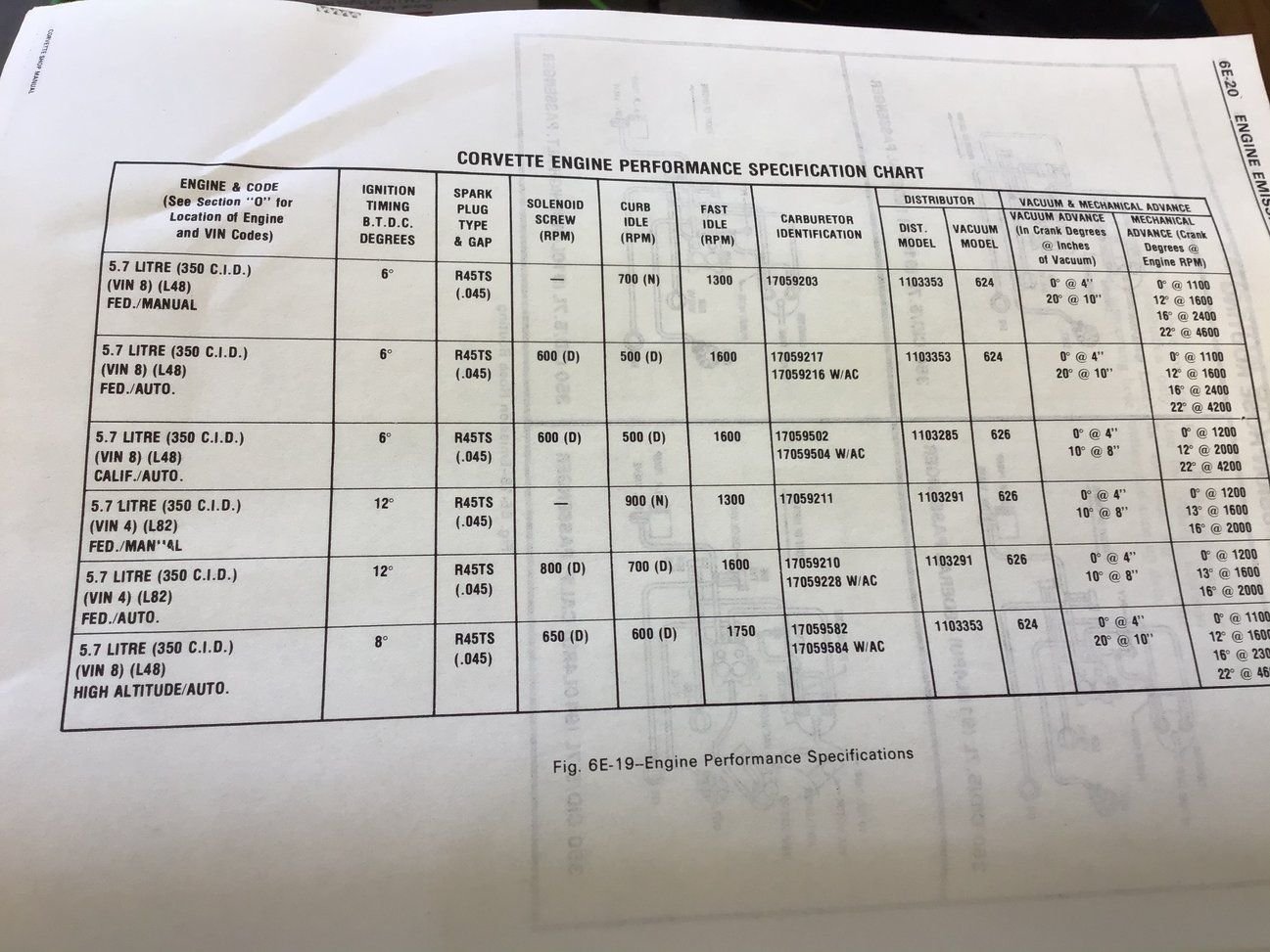

Default here is some 79 variants.. i have the l82 manual
i run about 17 initial, seems your readings may not be far off if you look at the 3 / 4 point curve and ramp up? im all in 1800 -19 (but i do not like having that fan inline with my head and timing light so..) even though it says 2000..was it Taiwan or chinesium?

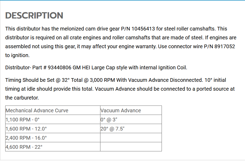

Buy a brand new GM Performance Parts 93440806 From Summit for $178. It has 18 degrees in the centrifugal mechanism. Curve starting at 900 RPM and finishing at 2900 RPM. Has a vacuum advance that is all in by 6.5" for 18 degrees extra. You might want to change the can or just limit the travel.
What else would you need?
This is a good option......but why do they show this curve on it? I don't remember this curve......but it says it pulls the same 22 degrees as stock....it says it pulls a ton of vacuum advance too.
This was pulled from Pace Performance.....
Jebby
Jebby
The specs are from Big2Bird. He bought one and ran it on his bench. I would trust him over the specs that were published online.
