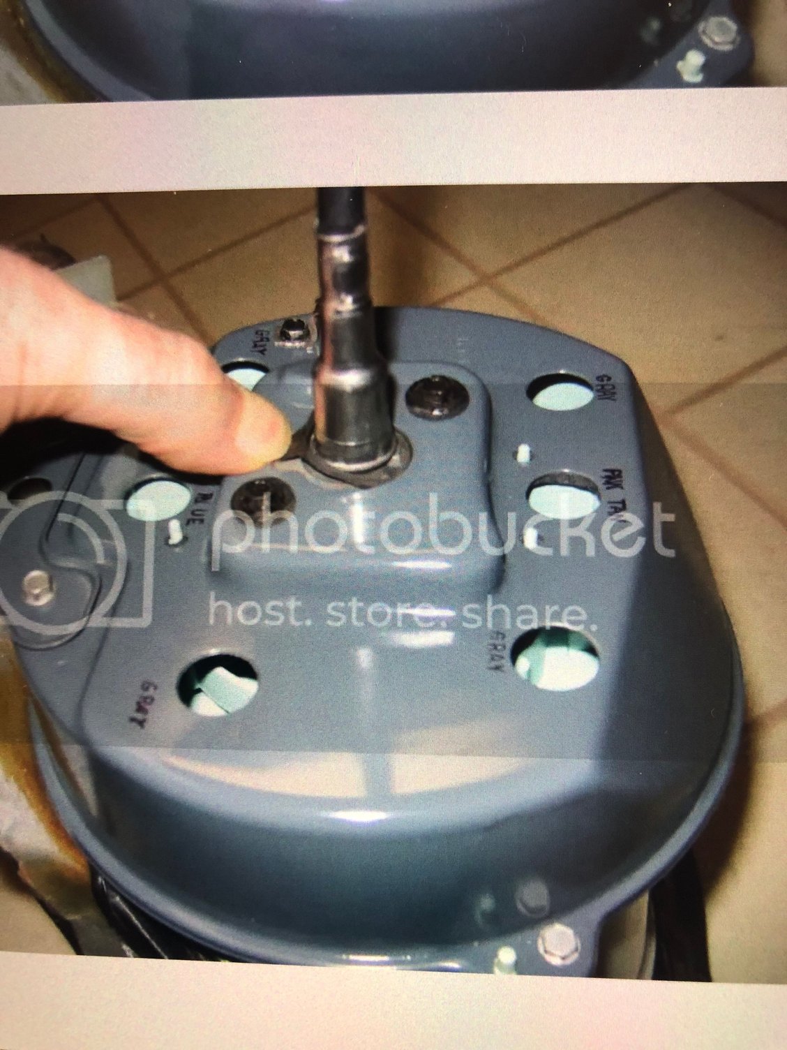

I copied this thread as I will be doing a brake booster R&R as well and didn't want to hijack that older thread. I have a couple of dash lights out and I only want to pull this apart once. I am having problems getting the spedo cable to release. I have the tab pressed in but I cannot get the cable to move. Any suggestions?

I had the same trouble trying release the cable from the speedo. Disconnect the cable from the tranny and push/pull so there is slack at the speedo. You need to be pushing the cable towards the rear of the car while your finger is depressing the spring like cable holder. I will see if I can find pictures that a member posted.
By pushing the cable towards the speedo head, you will be releasing the tension on the spring like clamp.

As you press the release lever on the speedo have a helper pull on the cable from the engine compartment.
