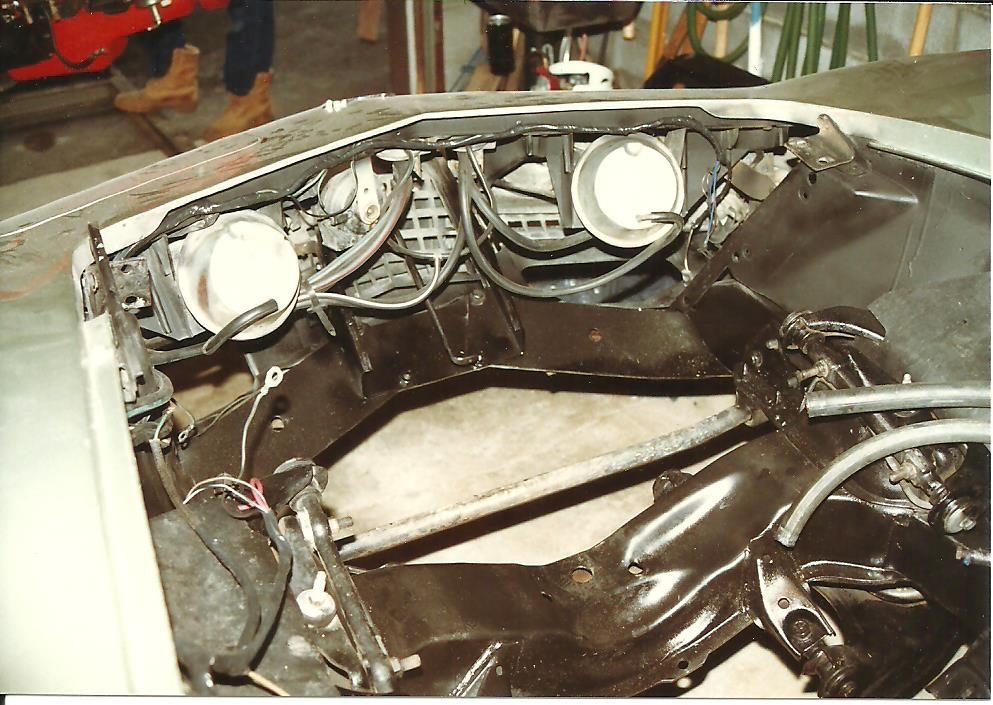

With the hood off and engine out, and assuming you don't have AC, it's not a lot of work to remove the radiator and radiator support (since you have a 4-speed, there's no trans cooling lines to contend with). With them out, you have access to clean, degrease, repaint sections of the frame and front crossmember, and you can do a nice clean-up on the area in front of the radiator. Hopefully you can move the car outside so you can climb in the engine compartment with a garden hose and bucket of soapy water.
A low-buck job is to remove (make notes of where they came from!!) your vacuum hoses, clean them gently with a sponge and dishwashing liquid (so as to keep the colored stripes intact), and then treat them with Armor All - they'll look like new.
Replace engine wiring harness? Replace forward lamp wiring harness? (This is where you take Mr. D's caution to heart)
Another low-buck job is to remove any relays (horn? power window?) to clean them up and wire-wheel the tin covers to remove half-a-century of corrosion/oxidation.
R&R the horns and horn brackets to clean/wire wheel/repaint.
Have a supply of different-sized wire brushes and scrapers to degrease, and a like supply of soft bristle brushes to wash/clean crud from wheelhouses, etc. Repaint as needed (spray can).
To inspire you, here's how I did it in 1988, and a brief shot of the results:
