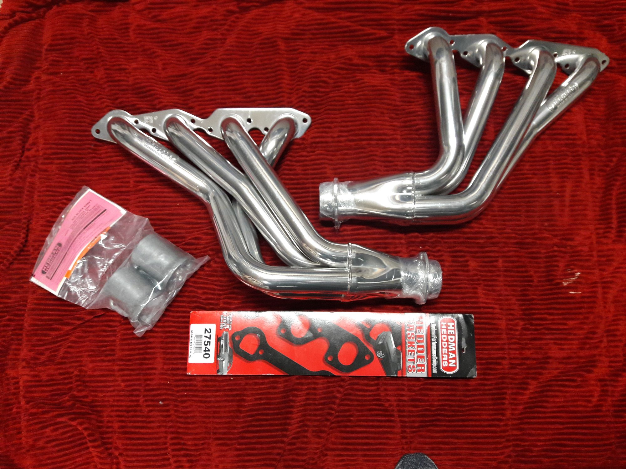

From: Napa Valley California
I purchased Hedman part number 68096 for my '73 big block a/c power steering with auto or manual trans.
2" 18g mild steel primary tubes with 3" collectors and 3" reducers.
The nice thing about Hedman is they have the ball and flange type collectors which can give you some additional ground clearance.
They are ceramic coated.
Aftermarket aluminum heads can effect header fitment, so if you are not running the oem heads call the manufacture to see what effects your heads will have with installing their headers.
Unfortunately there are only two manufacturers who make headers for our big block Corvettes, Hooker and Hedman, unless you can afford to have them custom made.
I went with hedman mainly because I heard Hooker was having some quality control and fitment issues a few years ago.
Don't be afraid to massage or dimple one of the tubes for fitment.
Engine Masters did an episode a few years ago where they completely hammered on a set of headers and found no performance loss on their dyno.
It was crazy.

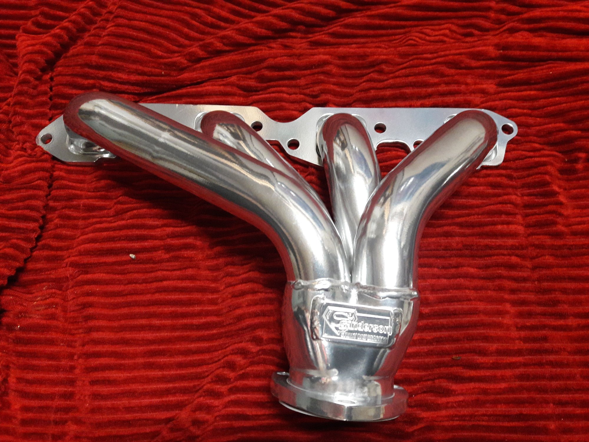

Originally Posted by hawk driver
I tried long tubes about 15 years ago, Hooker or Headman and could not get the drivers side to clear the steering box without beating the crap out of them. Sent them back. Keep thinking I will go with shorties one day. I have the same car, 73, 454 with power steering and 4 speed.
Originally Posted by 7T3stinger
Yea. I thought of short ones but Ive read where they really dont do anything other than looks. So I dont know which way to go. ha. thanks
Check out Sanderson Headers in Torrance CA..
They have been in business for over 50 years manufacturing headers for all auto and marine applications.
They are by far the best headers on the market.
Compare their flanges and primary tube wall thickness to all the others.
They coat their headers inside and out and one of their selling points is that their flanges are so perfect you can install their headers without gaskets.
Small tube headers perform as well on a basically stock engine used on the street driven as a daily driver under 5000 rpm.
You can check on Sanderson's website where they compare their short tube and long tube headers on the same engine using the same dyno.
Another advantage with short tube headers, is you don't loose any ground clearance.
Here is a photo of the Sanderson's I purchased for my '73 454.
I planned to run these until I went all out with a 496 build.
If I run into ground clearance issues I will replace the long tube headers with these in a heartbeat.
Yep I have seen these. Interesting looking at the flow charts on their site. But I've always been skeptical about what someone says when comparing their product against someone elses. I mean say anything to sell the product sort of thing. But thats just my opinion. I may go with the shorty ones. But its only a little more for the long ones from another site. Thanks for your input.
