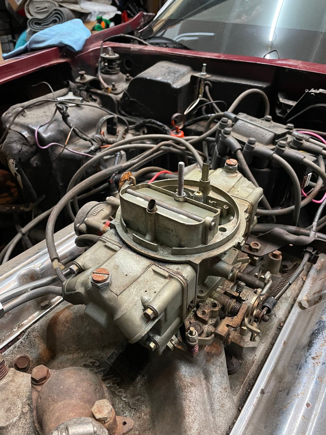

Hey! I was hoping someone could help me ID this Holley carb. I’ve found to numbers stamped but neither points to the model of the carb. Any ideas?

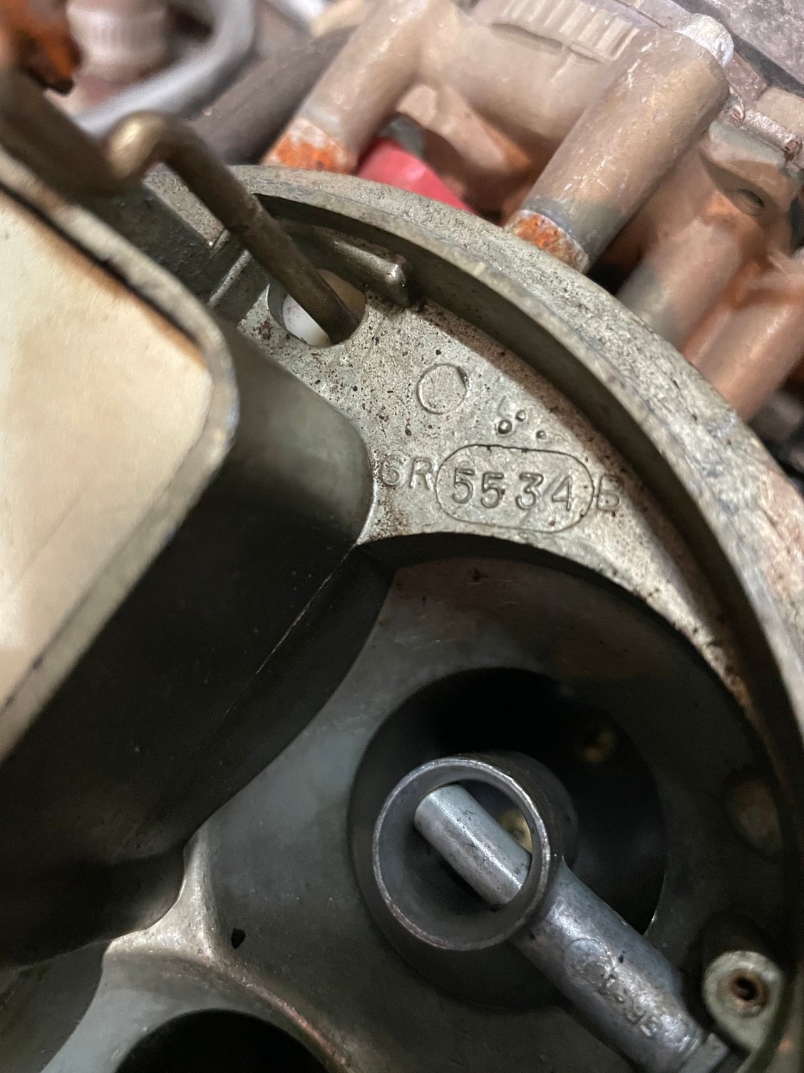

I can't make out the number on the front of the Choke. Its in the second picture. Its probably a 4150. Anyway Google that number and You will have it.

yes sir, that's a double pumper Holley.

https://www.holley.com/products/fuel.../parts/0-4777C

In your second picture, look at the stamped number on the air horn. Jebbysan nailed it - it is a 4777. 650 cfm.

As Jebby says - Looks like it's stamped 4777-4. It's an older model (more than 10 years old, but not as old as from the 1970's) 4150 mechanical secondary 650 cfm. Specs are 66/73/6.5/.028/.032
Lars
It is pre-1997 as it does not have the embossed "Holley" on the bowls and the ribbed/embossed main body......just a little FYI
It is an excellent carb for a hot 350 4 speed car on the street.....
