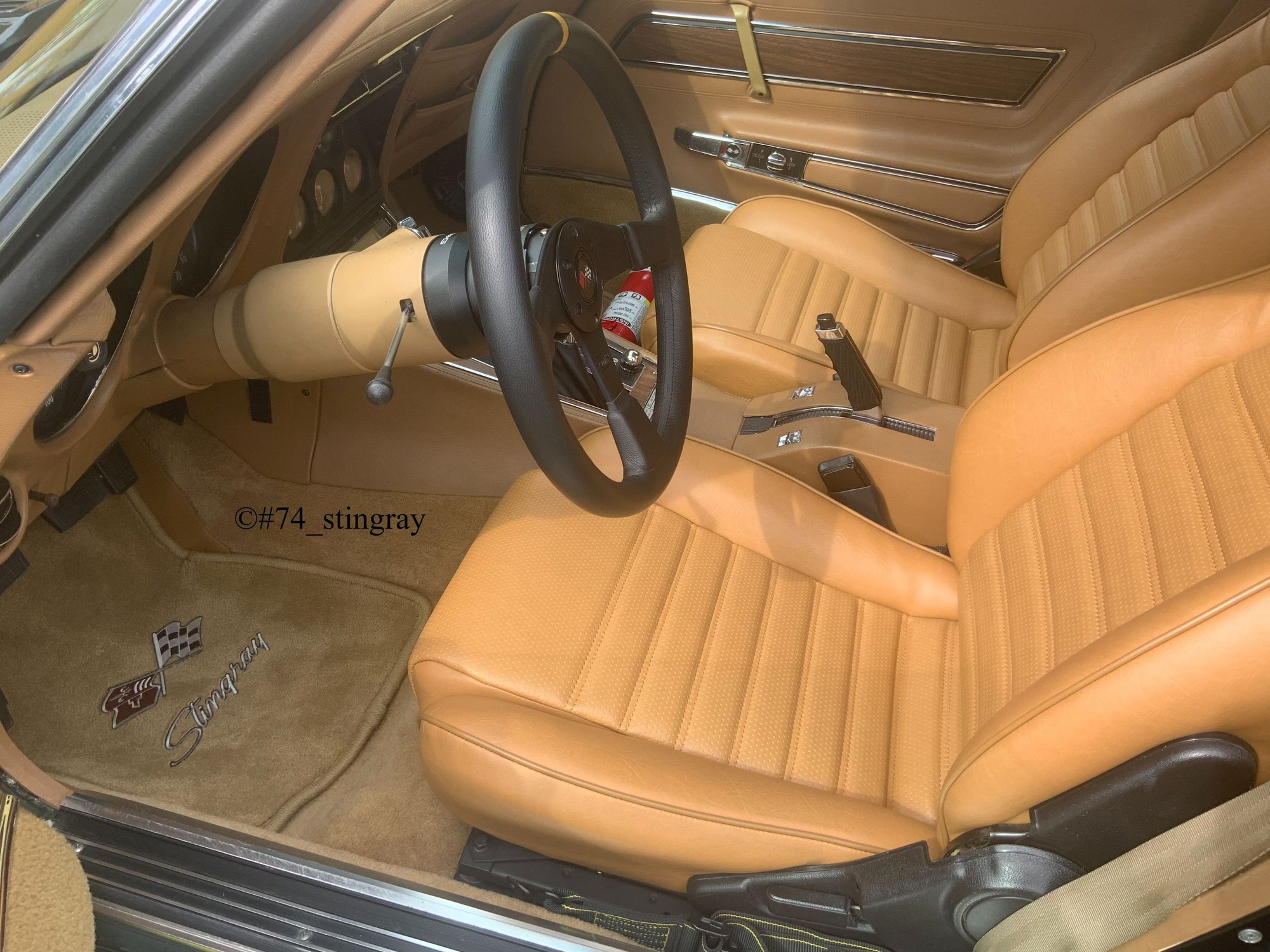

I used a different solution on my 74 manual steer, std column car, 15” OMP steering wheel, Mazda Miata Waterfall seats. Reference post number 4.
https://www.corvetteforum.com/forums...n-options.html

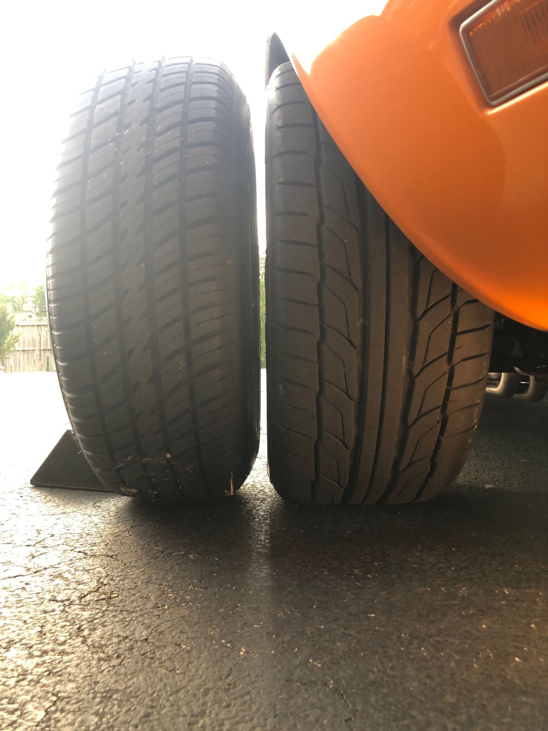

For some visual perspective.....here is a picture of the front tires. On the left is the Cooper 225/70/R15 tire......and on the right, installed on the front of the car is the Nitto 555 255/50/R17 tire. You can see there is alot more tread on the ground. The Nitto's are very flat with almost square corners, where the Coopers have a larger radius corner.

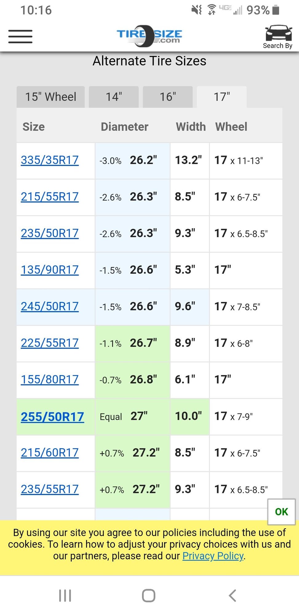

Hey Jeff hope all is well , I'm curious did you consider a alternate tire size the 235/55/17 might solve your problem and there are more options in that size

Default Consideration
