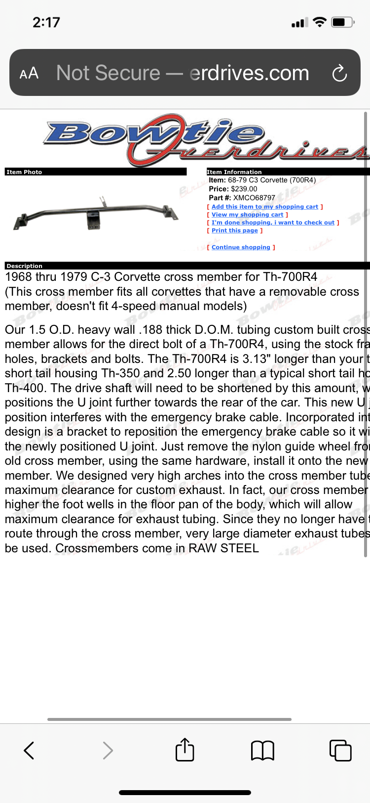

You probably need an aftermarket trans crossmember for the 700r4. Like this

Yep. That's the one I bought.
You also will have 'issues' with the various mounting brackets on the trans oil pan rail. Since the bolt pattern on those two transmissions are different, the geometry of the shift cable bracket and the steering column locking cable bracket will be wrong, if you try to use those from the THM-350. You will need to purchase brackets for that conversion or physically modify them to be correct for the change.

Is there 2 elongated holes in the middle of the cross-member ? Is that where you have bolted the transmission to ?
There's supposed to be a bracket that bolts to the cross-member and faces forward , which would bring the mount area forward by about 3 inches .
