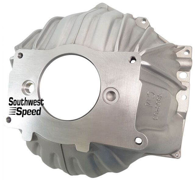

is there anyway to find out the clutch flywheel size before removing the assembly off the car? I know in 75' they came with both a 10.5" and 11" clutch with either a 168 tooth flywheel or 153 tooth. just would like to order everything before hand, as im renting a hoist and want to have the job done as fast as possible with as little downtime as possible

Look at bell housing casting number on the side
"403" = 153 tooth, 10.5" clutch
"621" = 168 tooth, 11" clutch
Old May 27, 2021 | 01:34 PM
L82 crusin's Avatar
L82 crusin
Joined: Oct 2018
Posts: 39
Thanks a bunch boss been looking for this for way too long!
