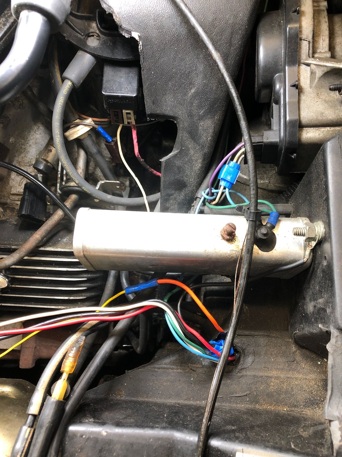

Default 1980 alarm removal advice please
So horn unplugged.
i have an old alarm thatdecided to go off..
i can see
- toggle swtch under dash
- toggle switch in carpet by right driver calf area
- switch under hood
- an apparent siren?
- an led in side fender by emblem for alram i thought was for horn...it wasn’t
- i think i see why my tach don’t work
- a wiring mess
let’s start slow...is this siren andflasher looking thing need to completely go away? I will temporarily tape where the used split crimper areas are and try to find some goop? Recommendations?
ok so i am as

And is this hole with wires going under dash supposed to be there and if so ( i assume some are factory) which stay?
To New c3 advice appreciated
