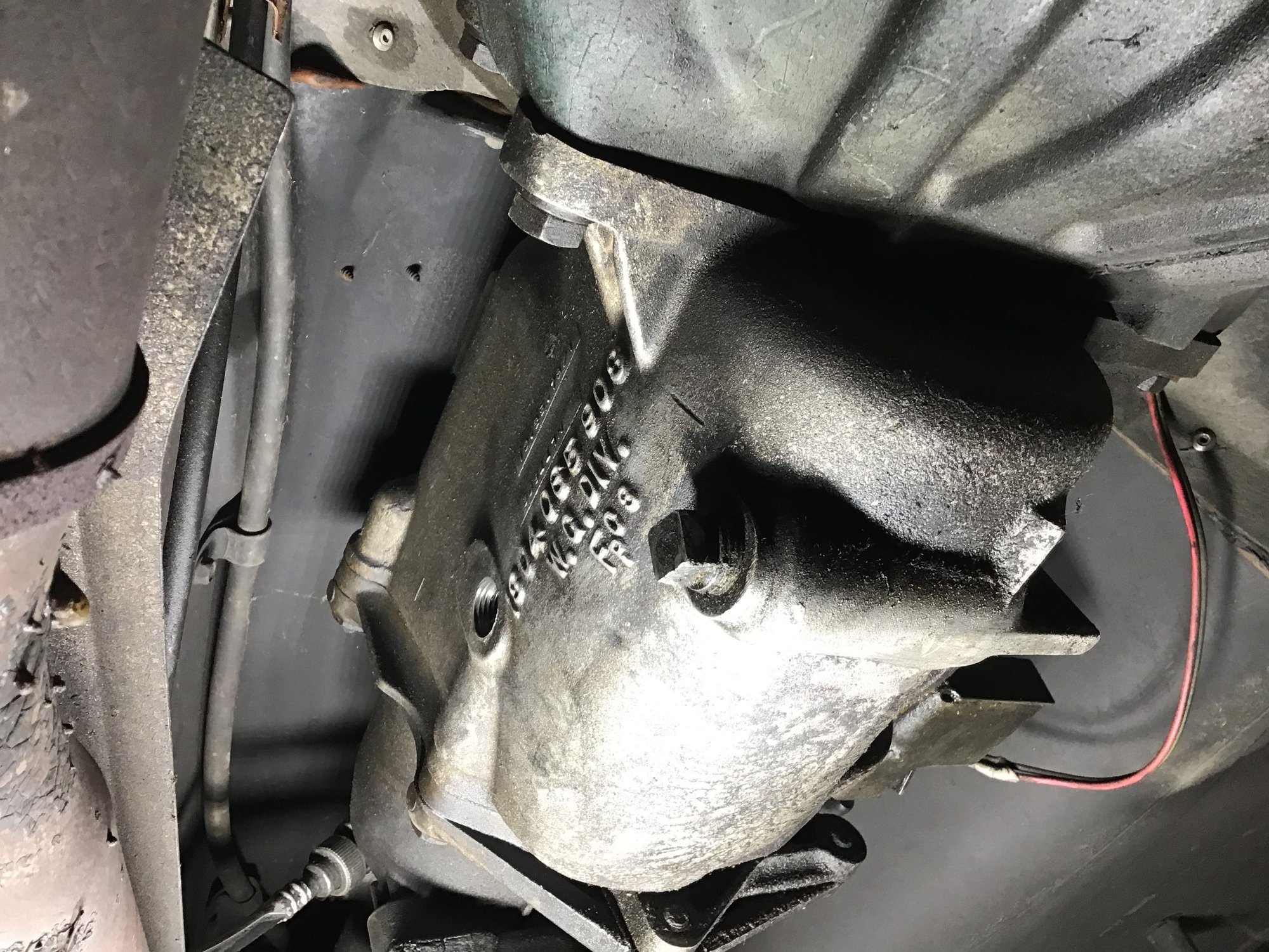

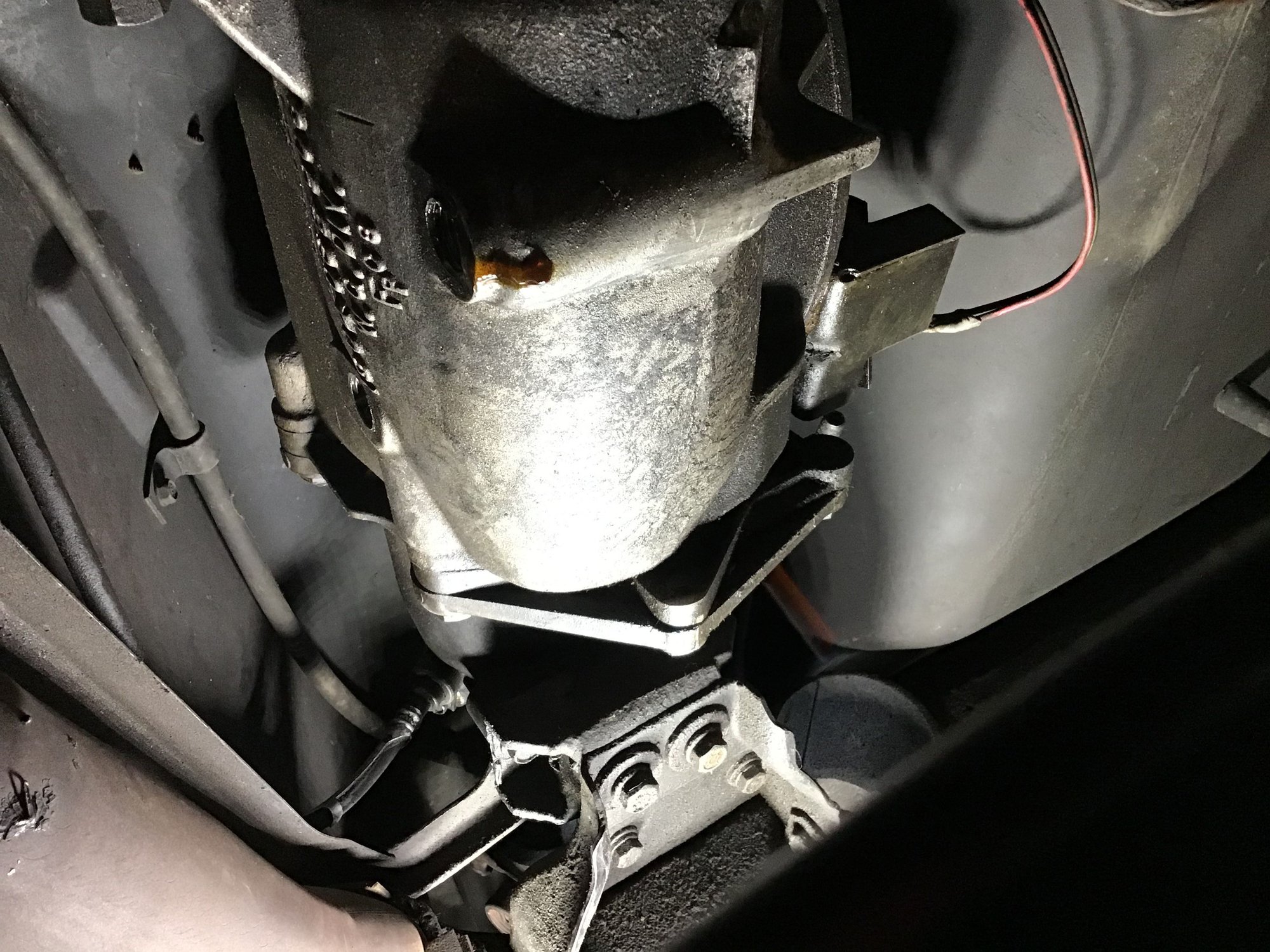

ok jacked up went to change tranny fluid 80-90..open top, pinky in....NOTHING....
pissed now..go to dealer...get all my money back...for inspection etc long story short...not chump change..
Capacity 48 ounces 3 pints
Pinky test nothing
Top plug after touching it..all very fine
Bottom plug worse as expected
Got 20 ounces out so about 1/3 full
Found speedometer heat shield lost rivet..lowes 4 imch ss worm clamp fo now
ok pics below how it went
my tip, toothbrush threads especially bottom magnetic in and out bolt and it screws in by hand....

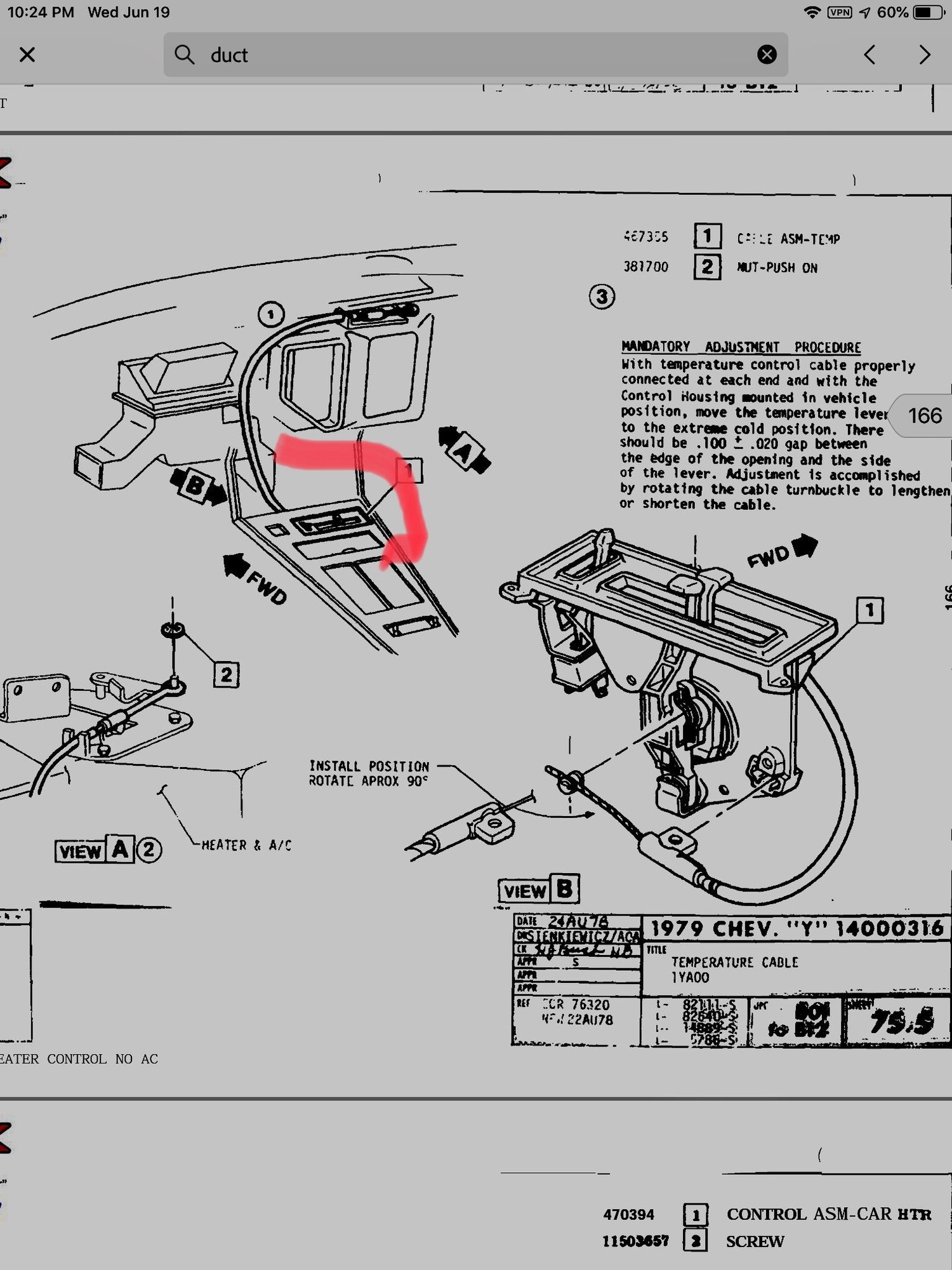

Default Temperature cable routing ac
Can anyone advise ptoper routing for temp cable? Will get some r12 soon and when i had console out before i thought odd it was routed as i tried to draw in pic..had to push on it seemed wrong to tuck it in..
also when i had gauge console out center the duct was loose that he vents hook into. Seems no matter the setting it blows on floor driver no defrost or vent.. thank you..will update r12 and this when console bulb comes.
thank you

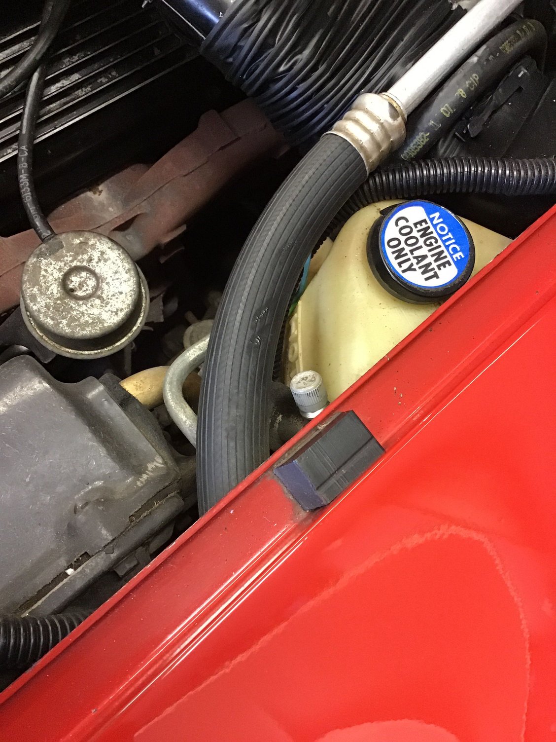

Ok so after mamy trips to store to find an r12 gauge and manifold set, i realize NOTHING fits the vette high side fitting by the fender. I added a can of r12 to the low side by compressor as the accumulator low pressure is virtually impossible to get to.
7 pounds was still in system so i went try a couple cans r12.
low side pressure reads up to 35 when running after a can of on off on off..barely staying on and debating another can as the compressor or clutch is not sounding good...
Hi side i assume? And one messed up sized fitting..
Low measurement and slow add
suggestions? Try my second can and see if starts to blow cold? Let the compressor implode? Or maybe it smooths out after being low for many years not running?
and btw where in the heck does the high side pressure go? No adapter or anything fits the line by the fender...wth? To even see my high side

Two weeks into owning a C3 and you already have it blowing (some) cold air? Wow! I'm two years into two C3s, and I've never had a working AC system.
Figuring R-134a was in my future no matter what, I bought an appropriate manifold, and some R-12 to R-134a adaptors. You may be able to get a right-angle adaptor to give you the clearance you need to screw on your gauge, and the remote hoses on the manifold might make it easier, too.
It was moot in both of my cars, both were long dead/empty, but the 80 had a different hose arrangement than the 79 that seemed easier to work with. I don't know the other implications of switching from 79 to 80 components, but if you may want to look into using 80 hoses if you end up replacing them anyway. I figure I'll go with Vintage Air if my wife ever needs AC in her car. So far it hasn't been a problem.
