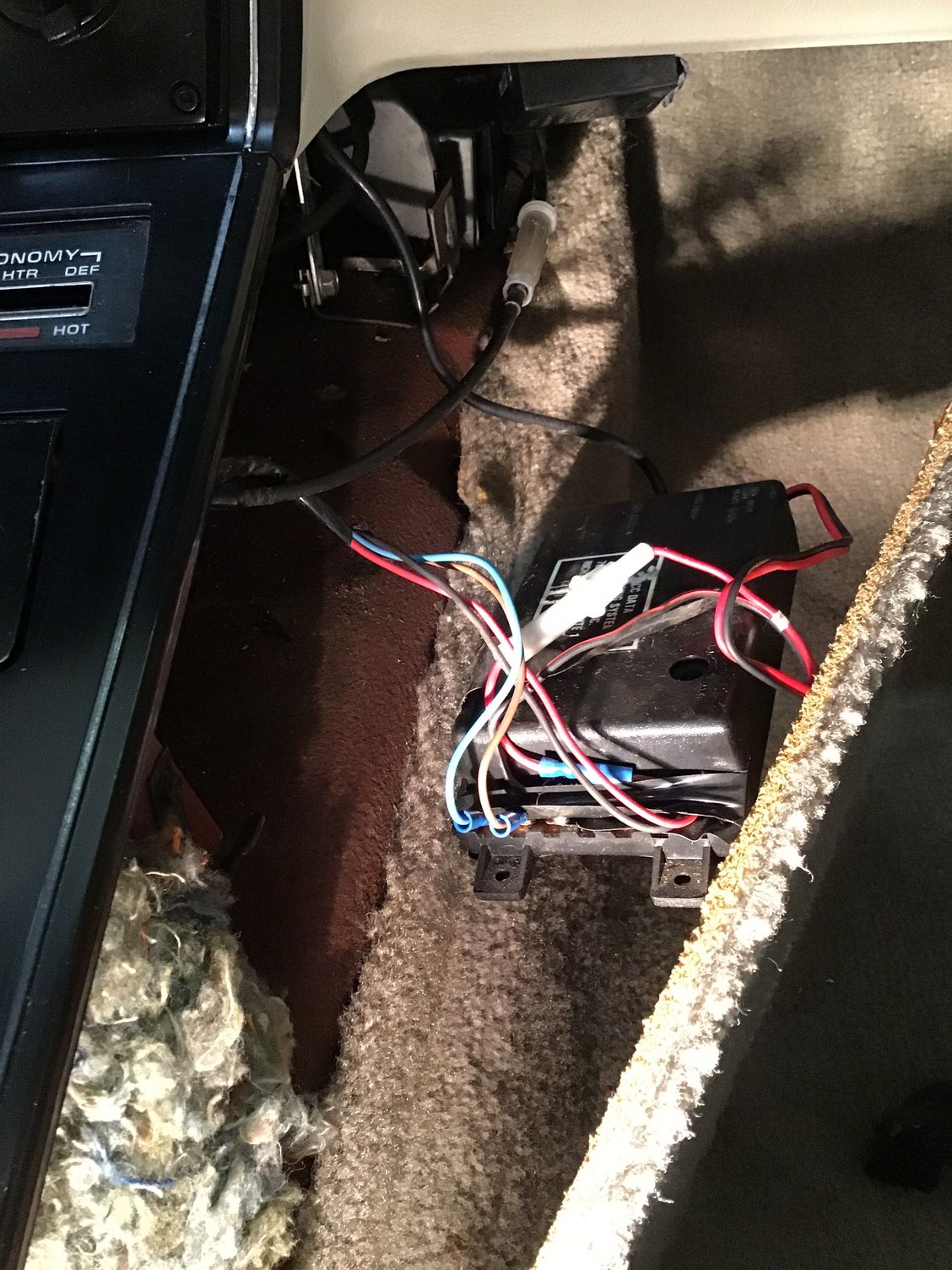

I removed the siren and relay. Will get some liquid tape to make permanent taped for now.
here are two switched insid..removed driversseat and traced wires to battery so assume this arms system..it was disconnected. Seat track needed work anyway...the other switch under dash maybe a ignition cutoff?
anyone with 1980 alarm thoughts appreciated.

79 4speed owner here. A few comments; straight from the factory service manual (fsm) with the car in 4th gear at about 25 mph, push the clutch in, rev it up to 2000 rpm, and dump the clutch quickly. If the engine drops rpm, the clutch is good, if it revs up, the clutch is slipping and needs replacement. Others already pointed you in the correct direction on clutch adjustment. On the tach, if the tach board needs replacement, it was mentioned in a previous post that you had to disassemble the top of the dash, but that is for an older car, not a 79. A 79 couldn't be easier. Just remove the clear bezel over the tach and speedometer and then the screws around the tach and remove the tach. As others have said, I too will mention that you need a copy of the AIM, (Assembly instructions manual) and FSM, asap. These will be extremely helpful in working on yours. Feel free to PM me with any further questions you have and ENJOY!

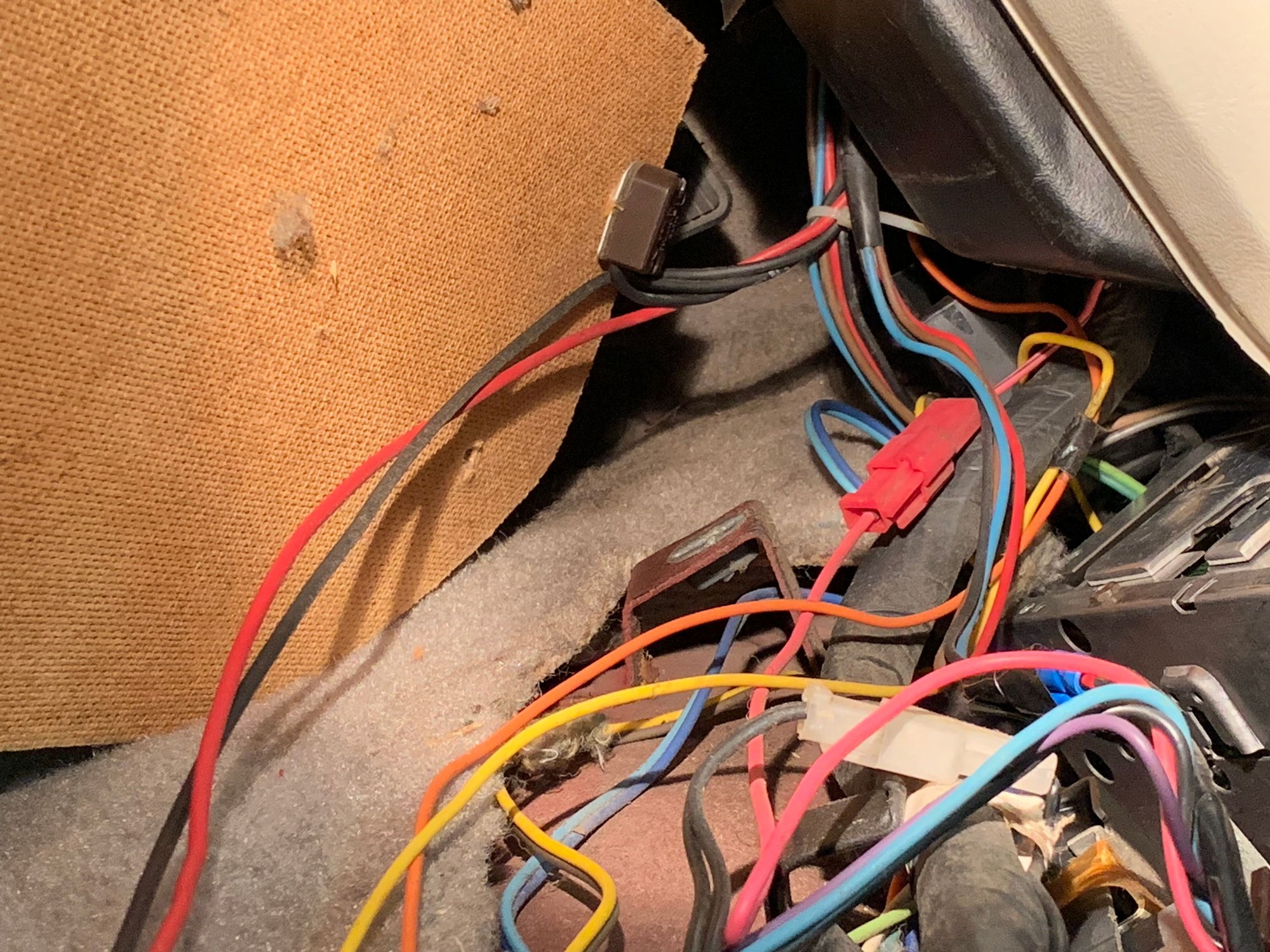

Ok one piece at a time...waiting on manual aim and wiring diagram..
here is siren and relay out..tape temporarily on areas to liquid tape.
Plan is remove any taps..where i get stuck is whats real or aftermarket or cut

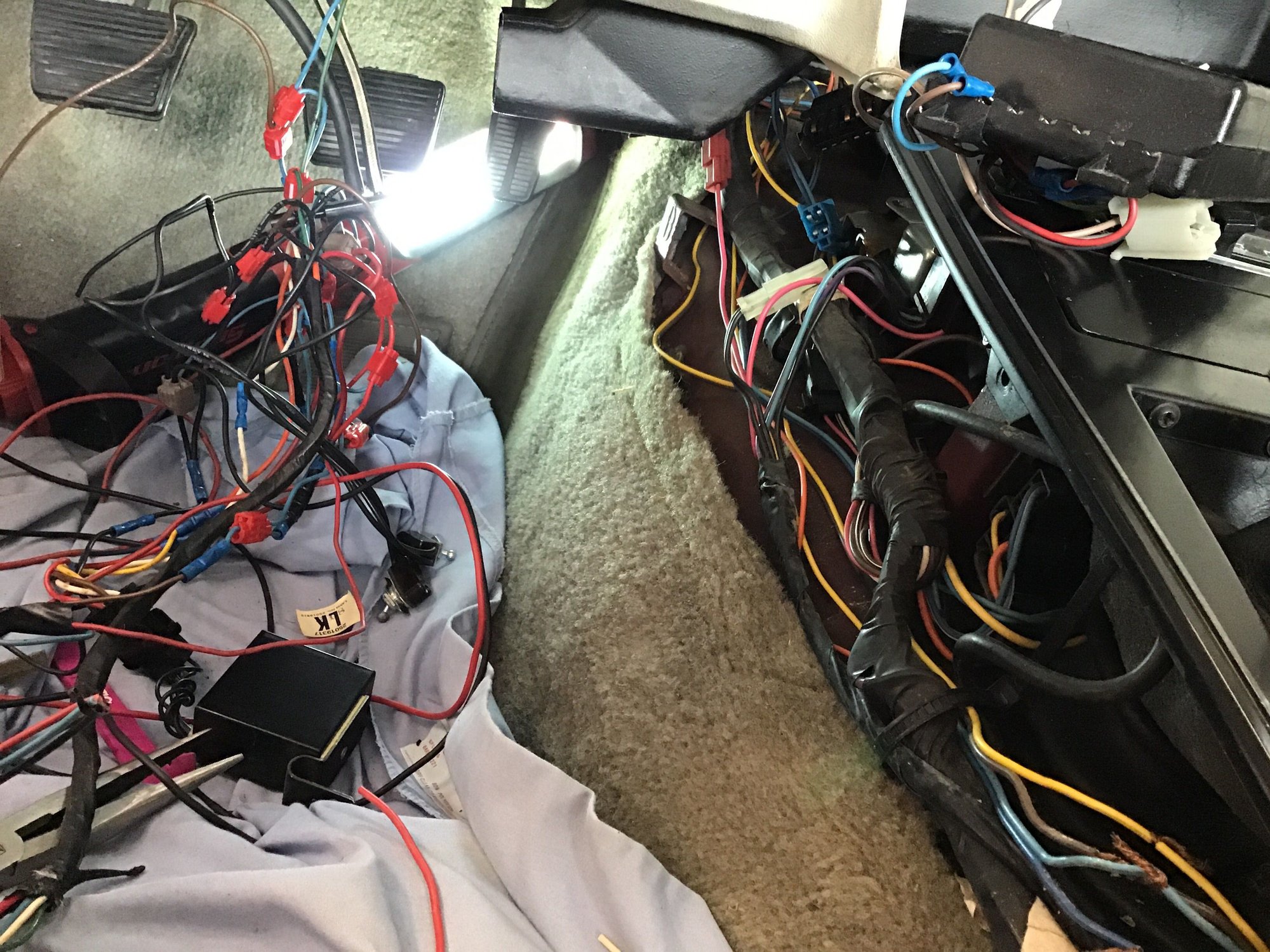

Thos silver thing dont belong right?
Makng progress..i didnt know there was an anti theft hood switch...holy cow i almost ripped it out!
i think i figured this one out...this silver thing should not be here right? I think its for motion alarm they hacked into hood switch?

lol l hope it runs down to two wires...
Last two wires...
