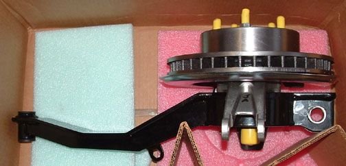

Ridetech is super nice. Here is what is looks like. (Before installation)

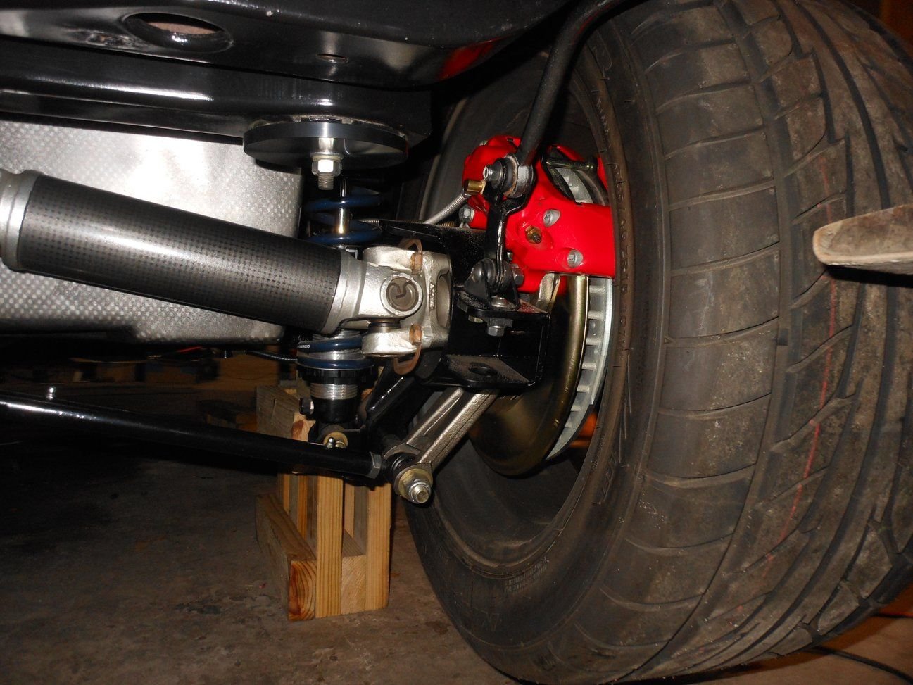

whats nice about ride tech is it puts the coil over behind the half shaft ,but overall ride tech and vansteele .
