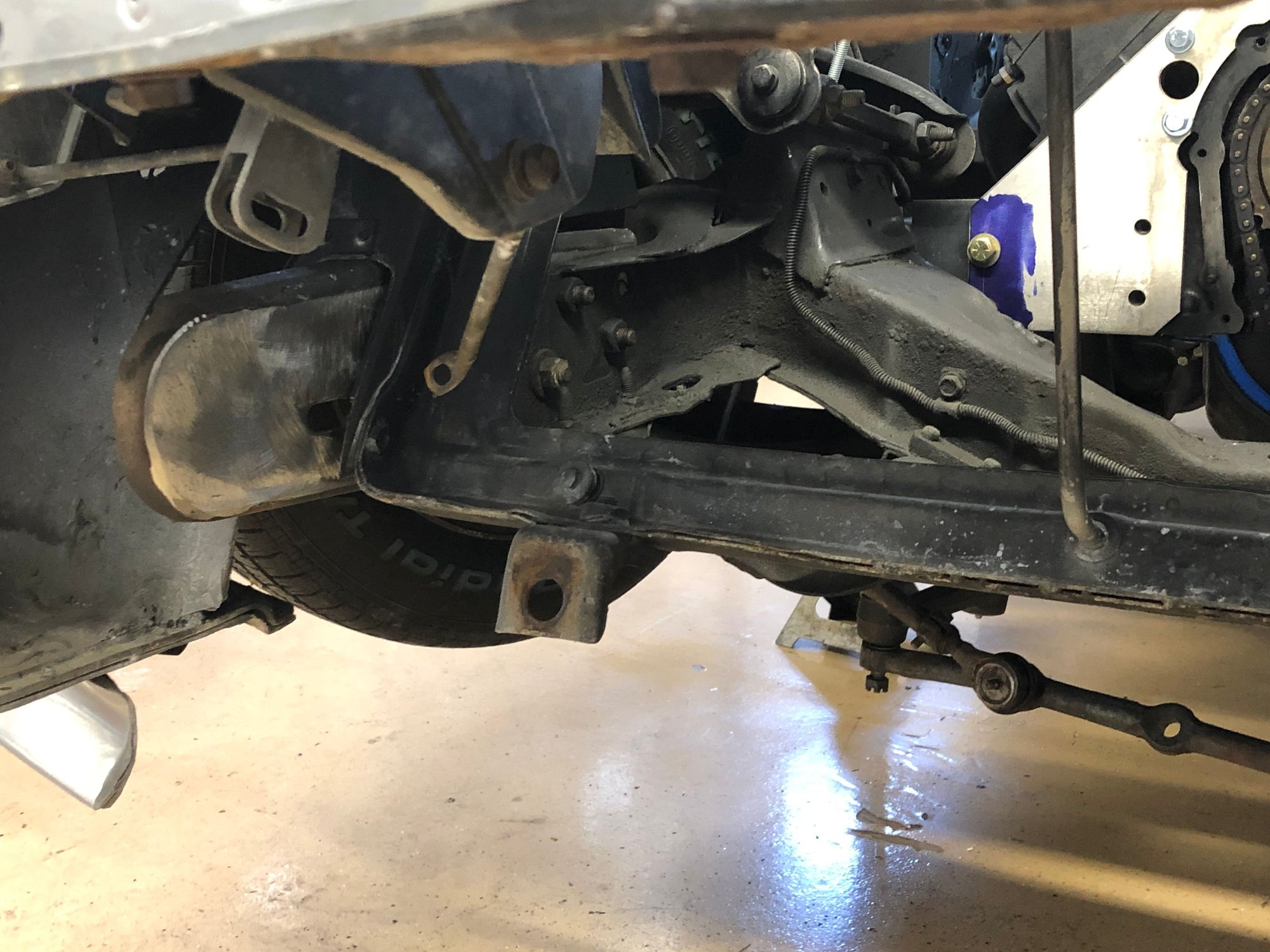

I've cut the vacuum reservoir out of the front crossmember on my 79. Now I need to tie the two rails together. I'd appreciate some ideas from people who have already been down this road.

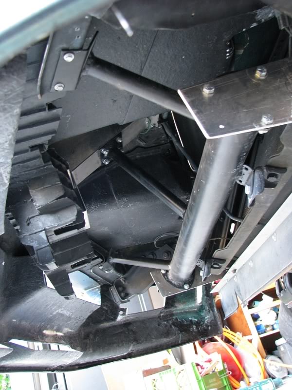

I unbolted the vacuum tank and all the heavy metal out of the front end of my 79. I used 3 inch exhaust pipe with welded header Collector flanges on both ends.
I made support brackets to support the nose
I took out the heavy opening head lights. My advice is to use round fixed lights with Le mans plexiglass covers

Any pictures of your setup?

I can't agree with you. I took hundreds of pounds out of my front end.

Are your side plates aluminum? What thickness material did you use?

I'm not home, but it's like. 250 tempered aluminium. Hard to even drill through. We used it at the race shop io make front and rear motor mounting plates for tube frame cars
It's engineering is pretty good because it has withstood over 200 mph at Bonneville salt flats

Good luck un-bonding the nose! I had to use a sawsall to just cut straight down each side and reattach the new nose. My front is not stock, but I believe that it uses late C-3 idea of the most forward body mounts ahead of the A-Arms on the frame rail to support the front end.
You also see in the picture that I welded tabs to back of my cross tube for radiator support. My front end is probably 25 - 30 years old and had to be repaired and painted a few times. My front end is actually the 1981 24 hours of Daytona TT front end with thinner fiber glass that took 100's of pounds off the front end. It's how I was able to achieve the highly desirable heavy rear weight bias like the real c-3 Vette GT1 racing cars.
