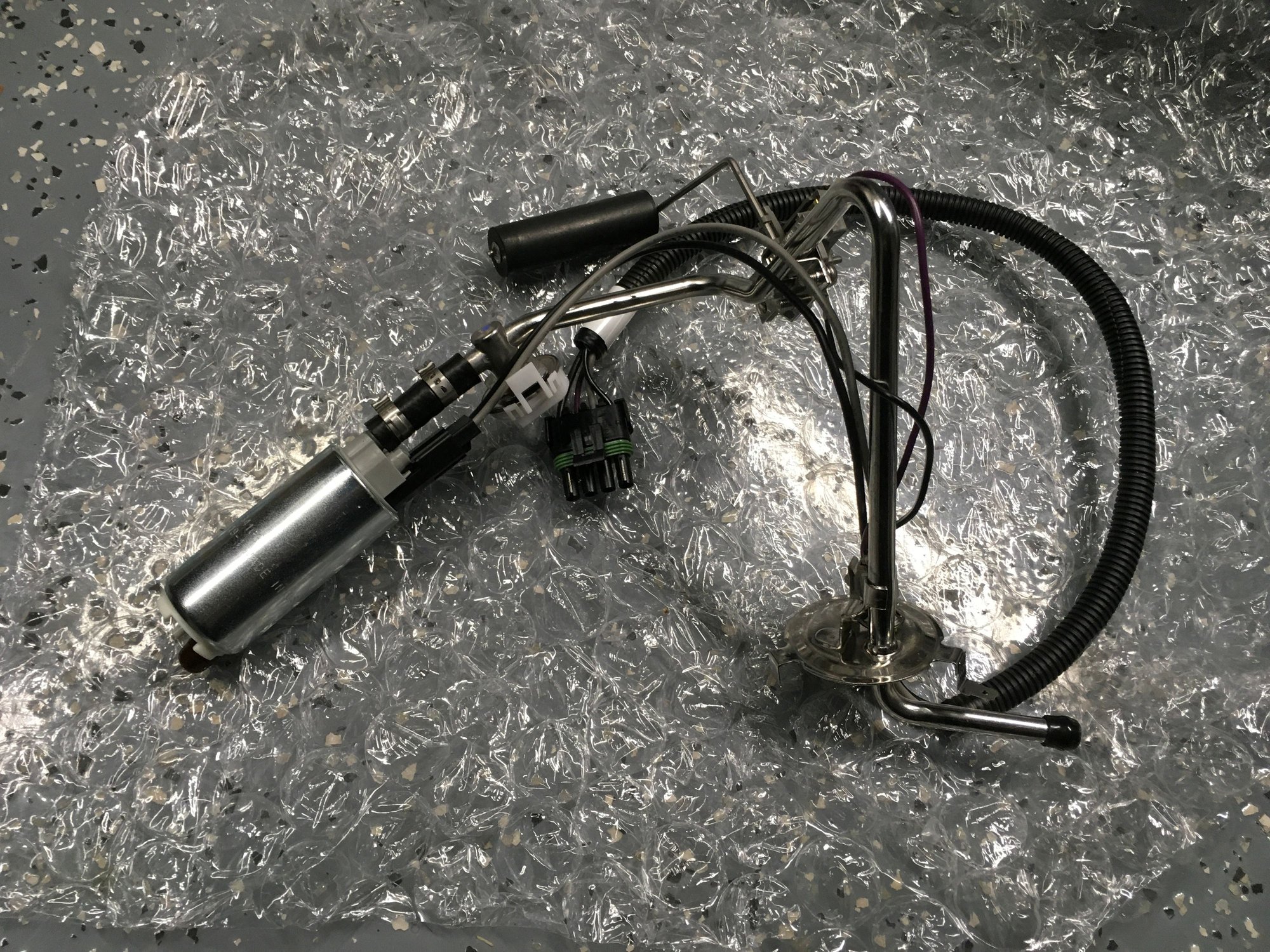

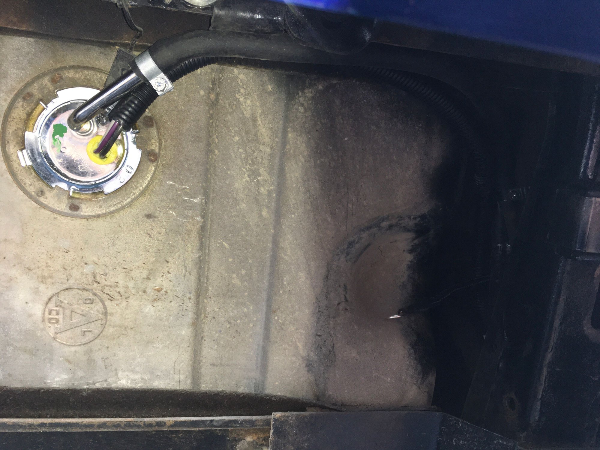

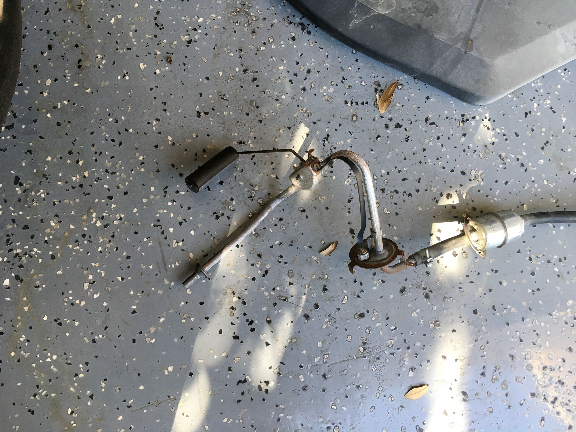

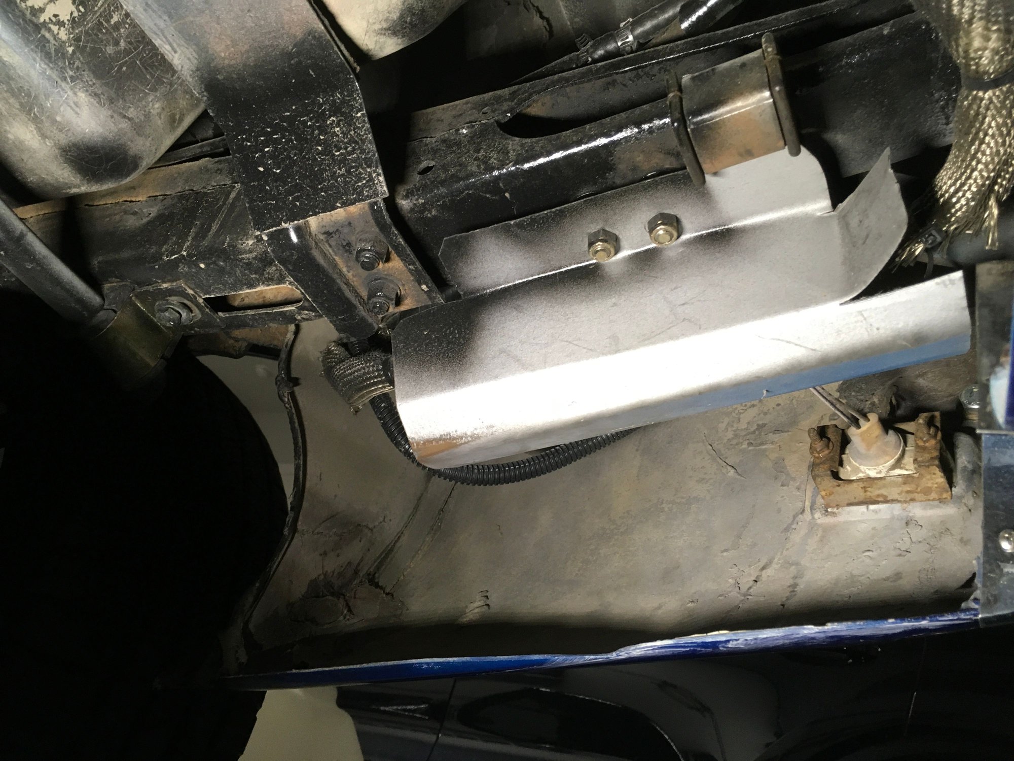

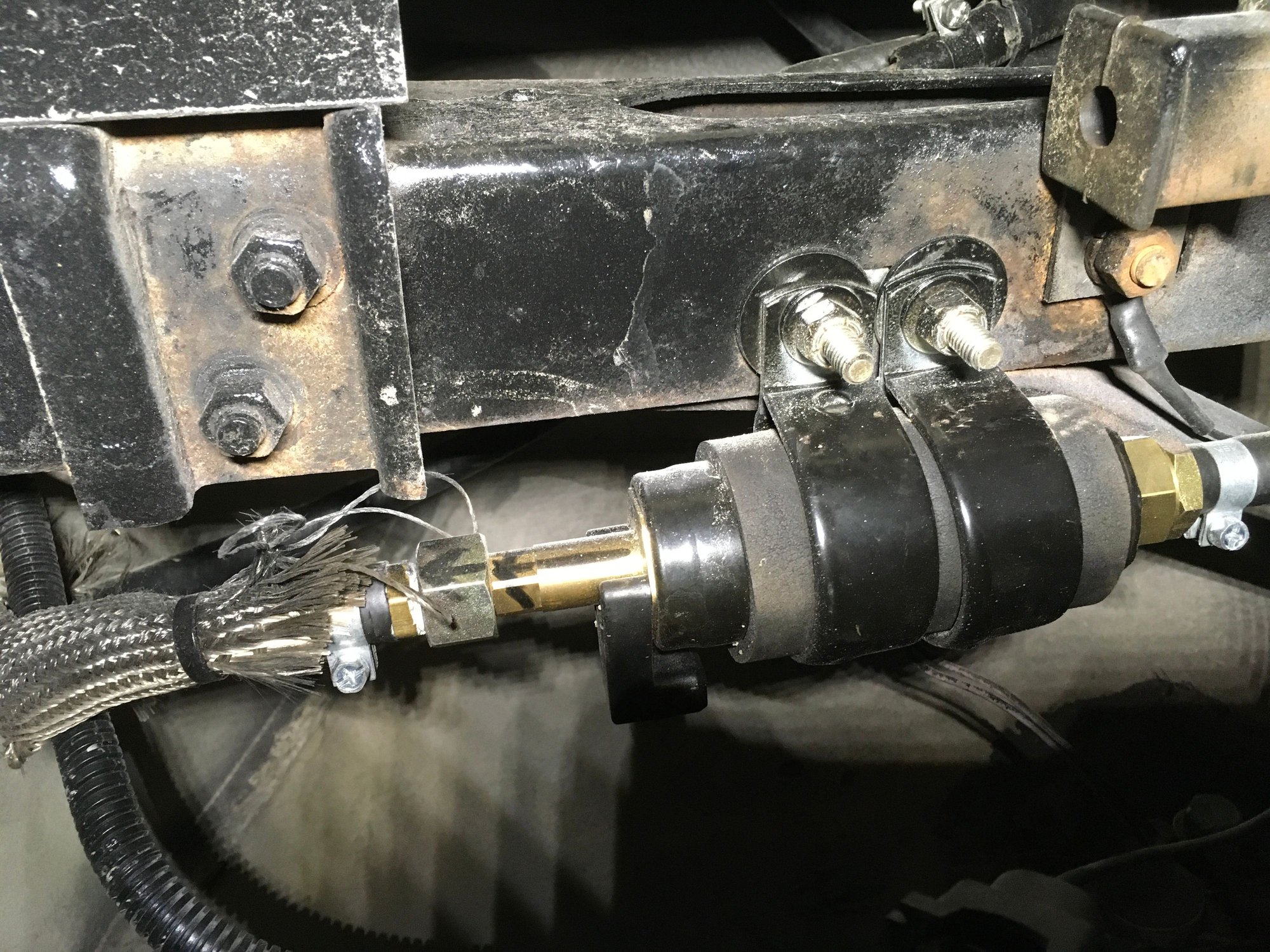

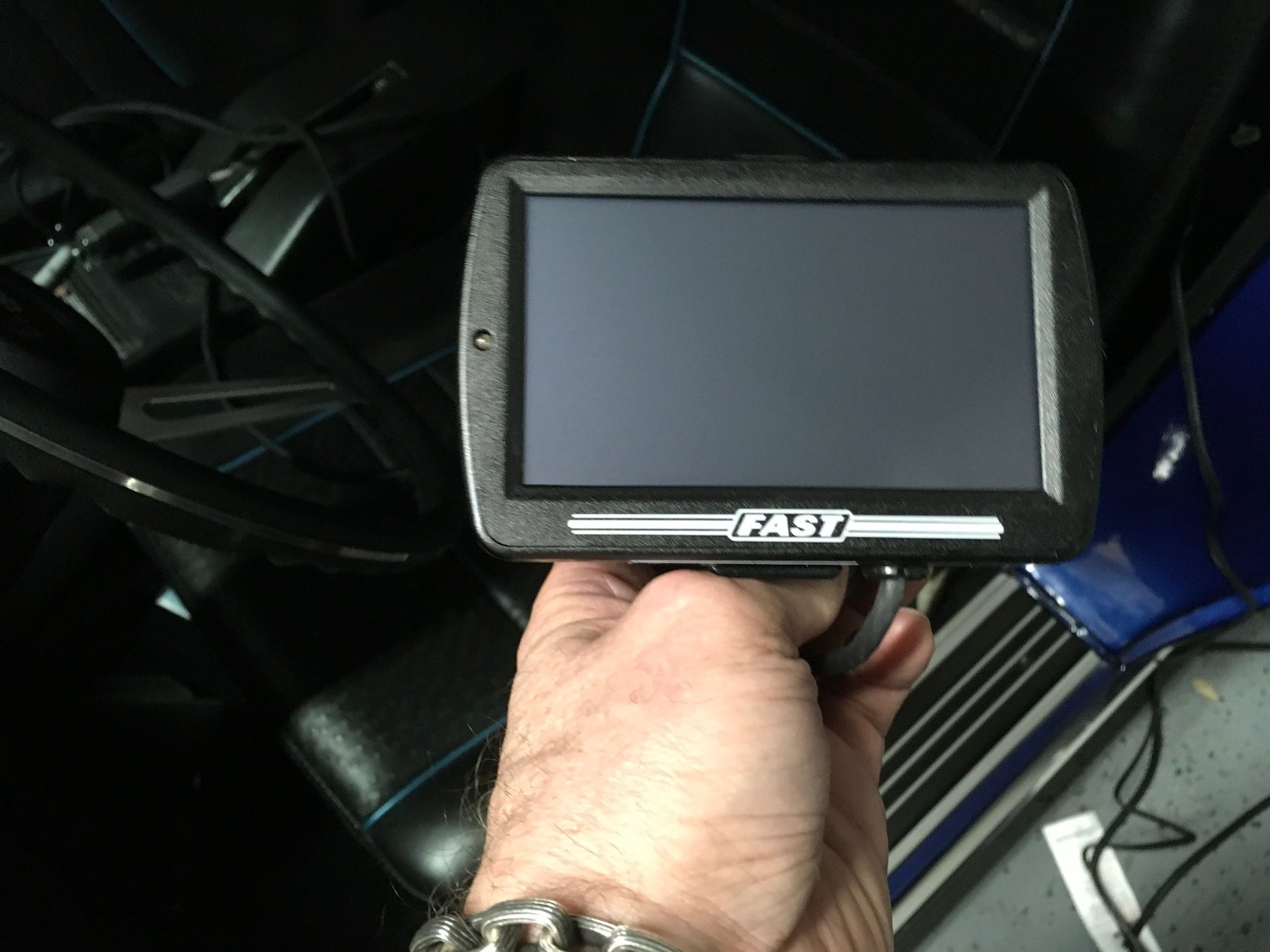

I have a Sniper on my ‘64 and love it. The PO installed a FAST EZ EFI on my ‘69. It used the FAST external pump and regulator with the old 5/16” return used as the return line from the regulator. The external pump was loud and the regulator would jam up when it got really hot and pressure would drop to zero. I replaced the external pump/regulator set up with the Holley in tank pump/regulator/hydramat set up and it is now perfect. I also bought the larger color monitor/controller for the EFI. This has made a world of difference on the ‘69 and it is very reliable and a blast to drive. I’ve also installed the FiTech in the past. Tops for me is currently the Sniper with the in tank pump/regulator, but this field is growing and innovating. There will be a new mousetrap tomorrow. With the Sniper and in tank module, the hardest past of the install is the wiring and frankly that is pretty straight forward. Your ‘73 has the same tank as my ‘69, so here are some pictures on the changes required to install the pump in the tank.

The external pump sat right above the passenger side muffler and had a insulation lined protective cover installed.
Here it is with the cover removed. Even with the rubber isolation mounts, the pump was still loud enough to be heard over the engine music.
Here is the old pick up and fuel sender with an external filter still attached.
Here is the new pump with built in regulator and return. The hydramat clips to the intake on the left and only fits one way. It acts as a baffle by maintaining fuel at the pump intake.
This is the new color display/controller for the FAST EZ EFI. It plugs right into the harness.
All done, new o-ring and locking ring came with the tank module.
