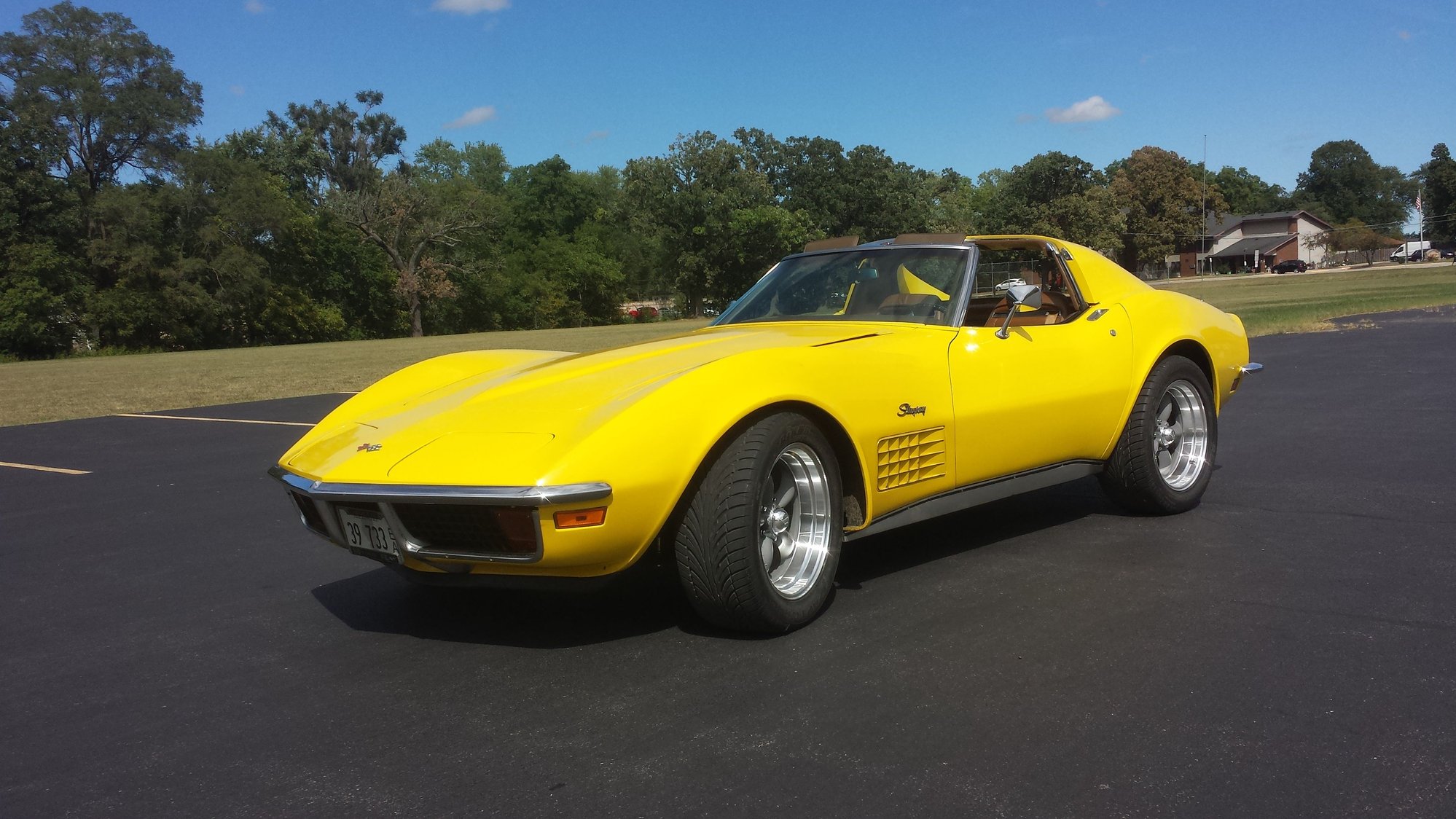

255/50/17 Riken Raptor.
No clearance problems at all. Riken tires is a division of Michelin. A reasonably priced performance tire. https://www.moderntiredealer.com/art...rformance-tire

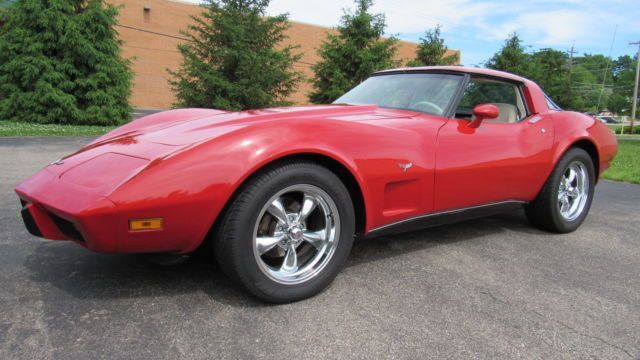

http://classiccarsmarks.com/chevrole...ng-wheels.html
Originally Posted by David ‘79
If the ‘72 clearance is the same as a ‘79 I will take the advice. Those look great.
They're the same. Here's a photo I found of a 79 with the same size wheels I have (torque thrust II), only they're the polished version.

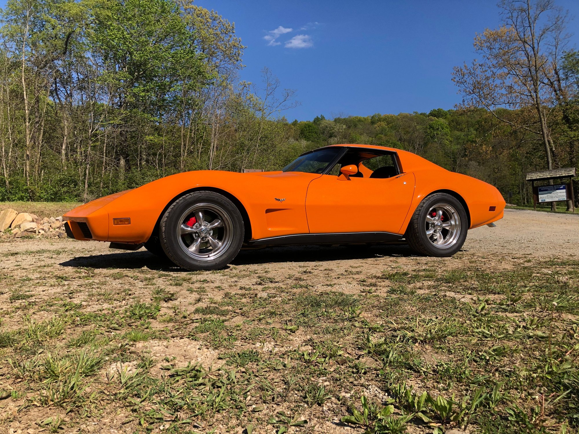

I have 17 inch Torq Thrust polished wheels, with factory correct backspacing, and Nitto G555 tires. No rubbing on my 77. These tires have the exact same outside diameter, and tread width as the 255/60/R15 that were a factory option on the late model C3 Corvettes. Too bad you are not closer as I am about ready to sell the wheels and tires and go back to my factory 15 inch YJ8 wheels and tires. The wheels were bought new and tires have about 2000 miles on them.
