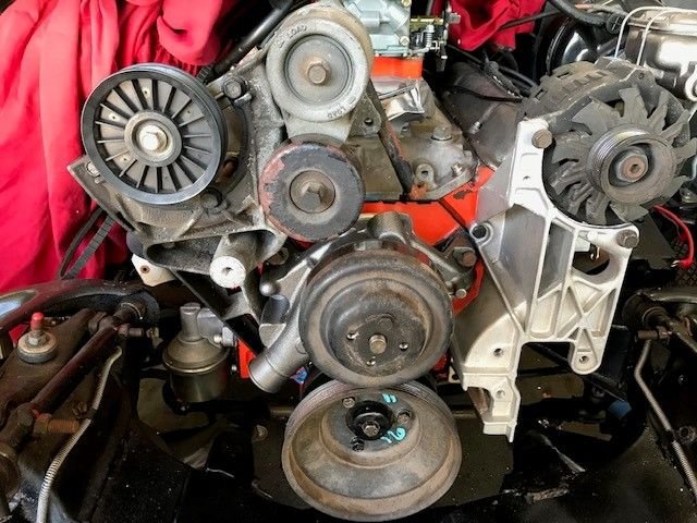

Old Jun 13, 2021 | 02:03 PM
Aquarian's Avatar
Aquarian
Joined: Aug 2013
Posts: 2,180
Likes: 107
From: S Fla
old bone yard set up
new GM conversion set up
Finally got a Millennial to show me how to do pics....yeah
