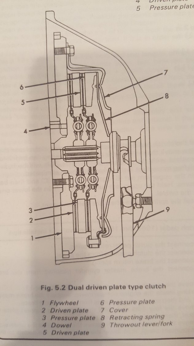

GM Dual Disk clutch diagram.

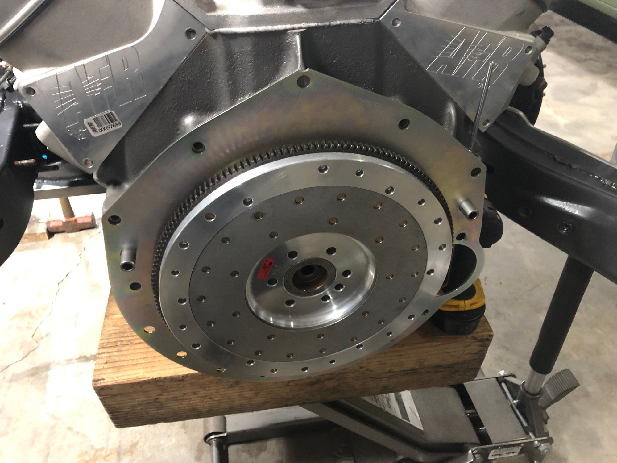

Here's a McLeod

Thanks guys clutch is NOS. Stingr69 where did you find that diagram of the clutch assy.

I remembered seeing this in my Haynes manual decades ago. It just stuck out in my mind. It is a rare setup for sure. Please post back once you get to drive it a few miles. We would love to hear about what it is like to live with it.

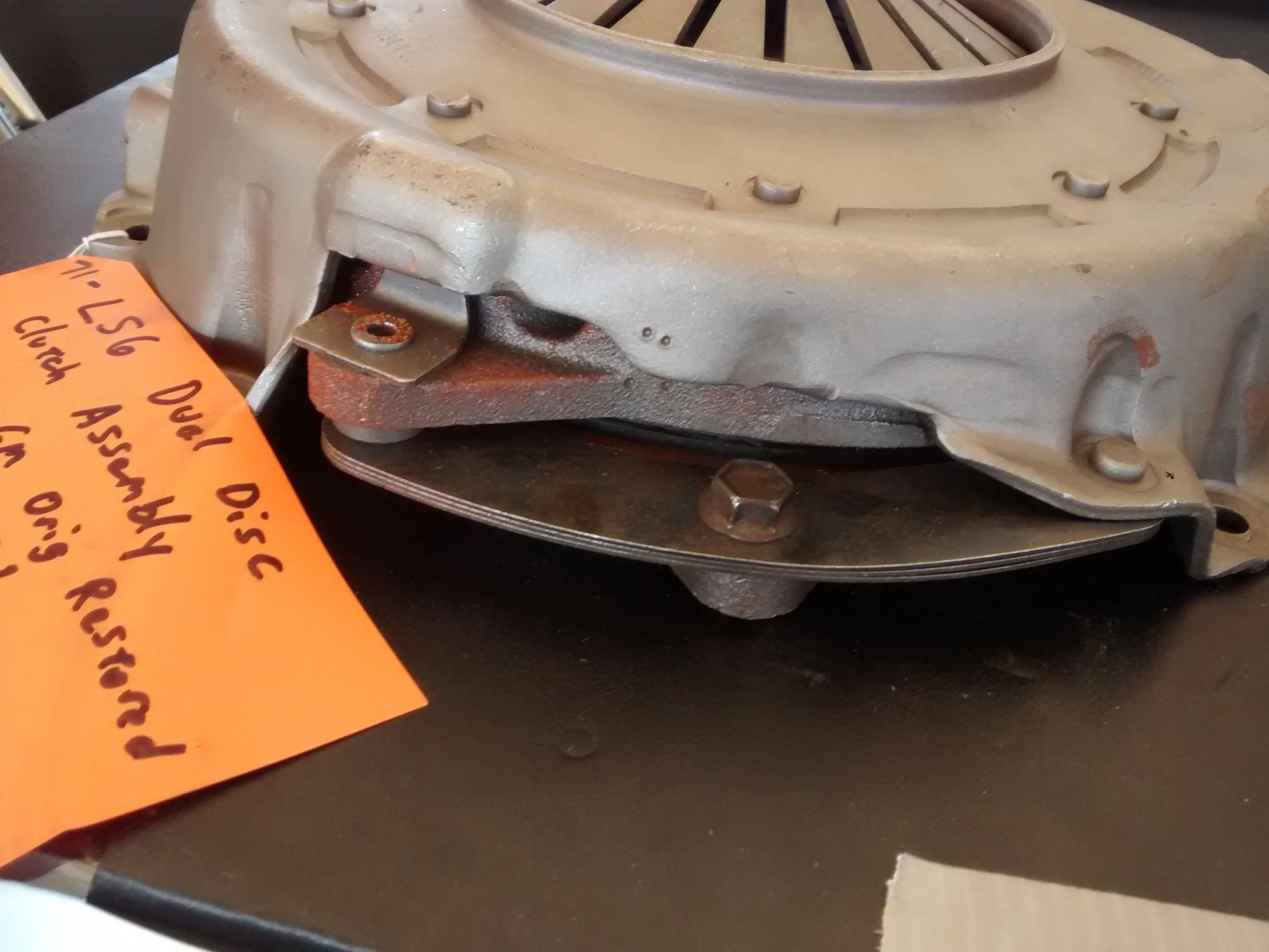

I have seen two original GM MA-6 clutches in my travels. Pics below.
The MA-6 requires a dedicated MA-6 flywheel. The McLeod twin disc is very very similar to the GM MA-6, as it should be, since McLeod admits to copying the old GM design
However Mcleod says they changed a few things to solve "issues" with that clutch. Two that I see are the McLeod uses solid hubs vs the GM sprung hubs. I am not sure that is an improvement and in fact the Mcleod is known for low rpm rattle because of this solid hub "feature". Also the GM hat design is a very deep one piece hat and the McLeod is a two piece. It has an adapter plate that bolts to a stock flywheel. They say it is an improvement but if you ask me there are a lot more bolts to cause possible issues. I am sure that they did it so that they can use a standard depth hat as a cost saving measure and not have to tool up for a deep one.
So I chalk the Mcleod up as having only one improvement. It bolts to a standard flywheel. The solid hub is a negative for street use.

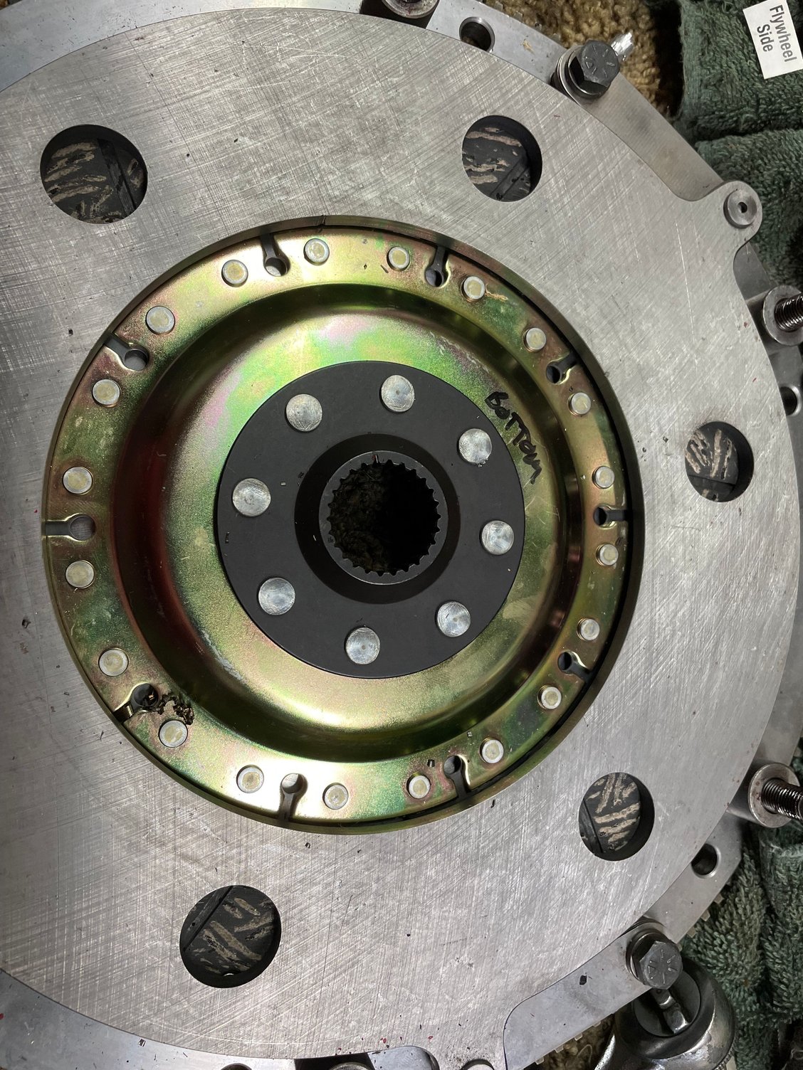

I have a Street Twin, NIB, bought about 12 years ago. A few months ago, after reading several recent posts on these clutches, I called McLeod and specifically asked them about the reports of being grabby and the person I spoke with said given the date I bought it, I would not have any problems for my application. This post prompted me to take it apart today and see what I have and I sure am glad I did. Note the machining debris!
A you can see, I have the solid hubs which is now causing me to rethink this. GaleBanks80 - what did you change in your attempts to make it work for you? I am wondering if I can simply swap out the discs with a sprung hub design? I’m now thinking the McLeod rep thought I had sprung hubs.
