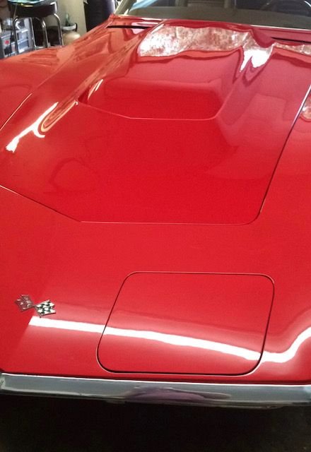

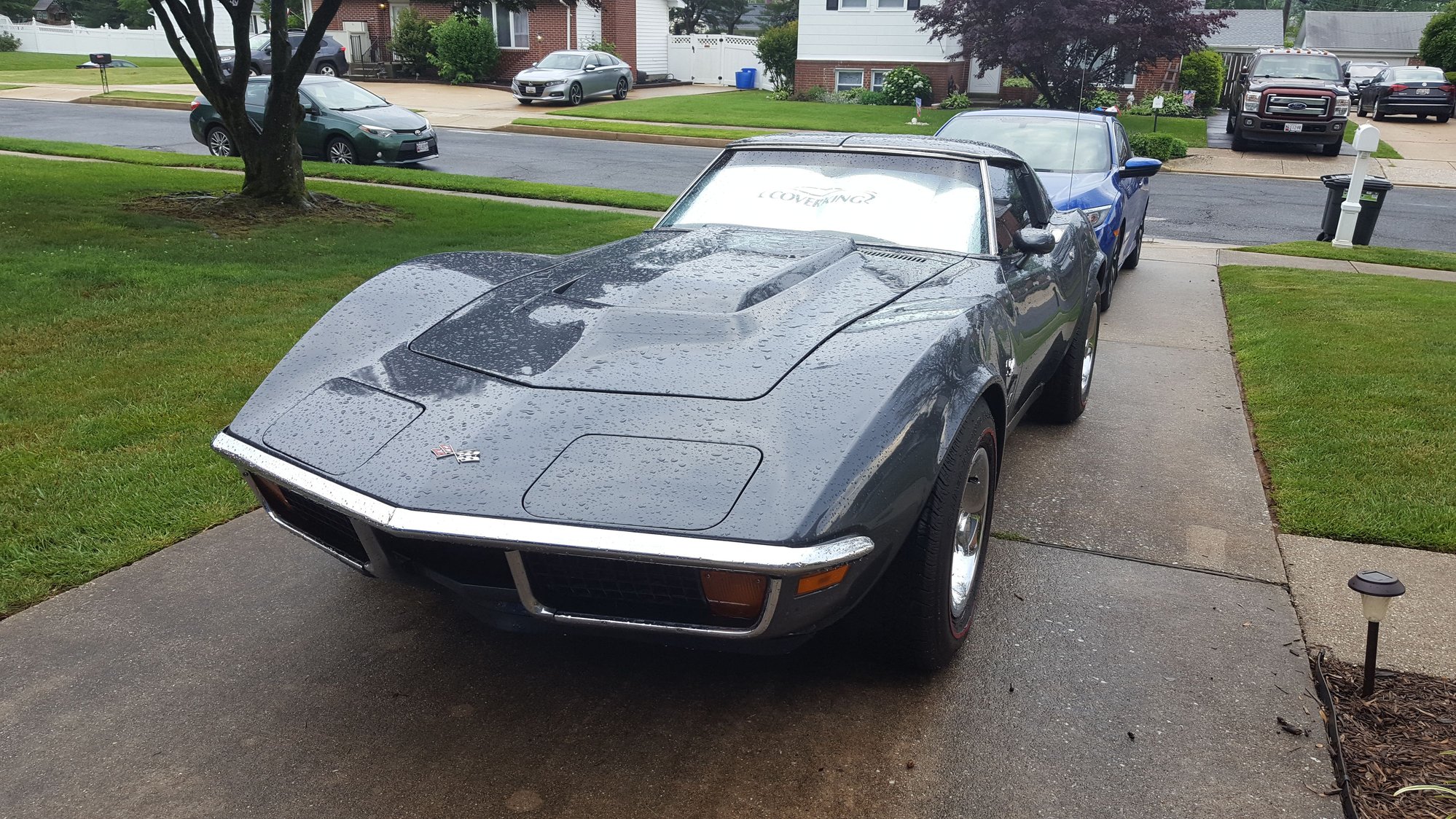

The current setup requires the taller hood. I had to add spacers under the After market air cleaner, which showed scratches from the linkage. The hood looks like Jebby's, but the rails on either side of the bulge go all the way to the back of the hood. I'll post some pictures later today.

It sounds like the prior owner installed a 73 and later long hood, which eliminates the vacuum actuated windshield wiper door on the 72.
This is a popular and expensive upgrade, which will be expensive to switch back.
Old Jun 14, 2021 | 12:04 PM
Chris Z's Avatar
Chris Z
Joined: Jun 2021
Posts: 38
The wiper door and wipers work fine, so i guess I didn't describe it very well. As for putting 327 badges on it, I had thought about it, and I'll give that more consideration.

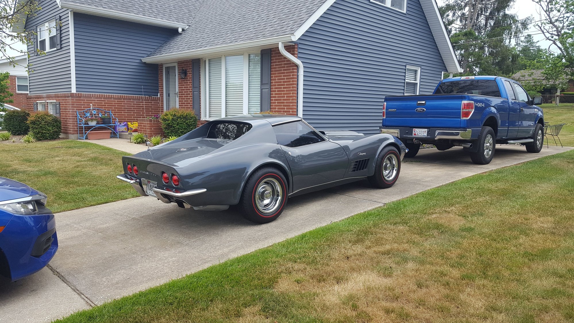

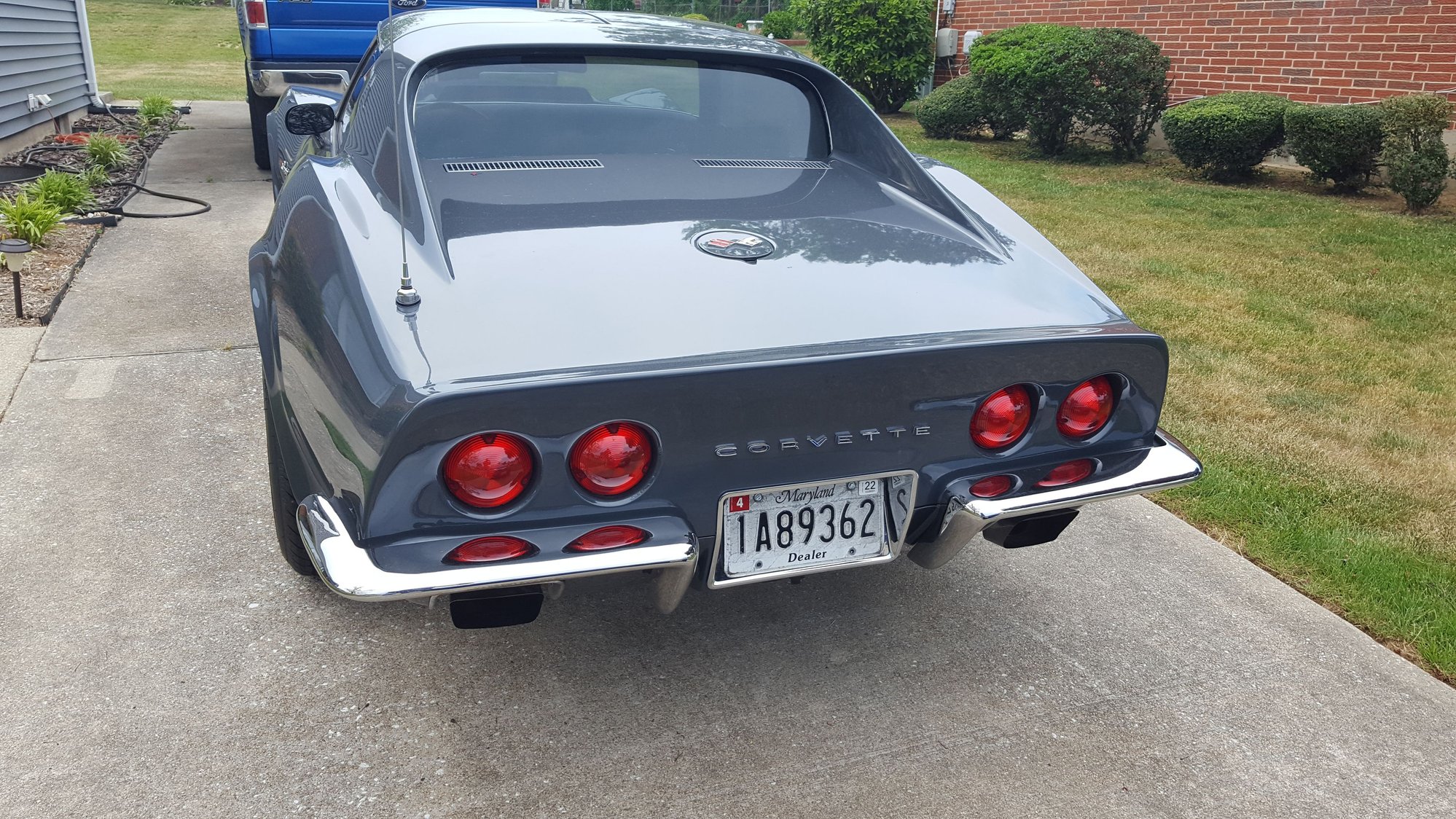

Old Jun 14, 2021 | 12:20 PM
Chris Z's Avatar
Chris Z
Joined: Jun 2021
Posts: 38
Old Jun 14, 2021 | 12:23 PM
Rescue Rogers's Avatar
Rescue Rogers
Is my vette stock?? HAHA
Joined: Oct 2015
Posts: 20,180
Likes: 9,315
2016 C3 of Year Finalist
Sharp car!!!! Do your T Tops leak?
