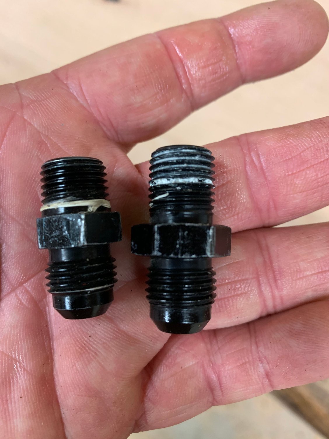

What is odd is that I found in my collection of AN fittings what I believe to be the correct one (left) and it still has some Teflon on it from when it was installed before somewhere. I think the incorrect fitting is for the transmission fluid to go into the radiator.

FYI it is 1/4" NPT, not 3/8" NPT, at least on my tank.

I got the correct 1/4" NPT - 6AN fittings and put the tank back in and everything seems to be holding fine with no leaks.
