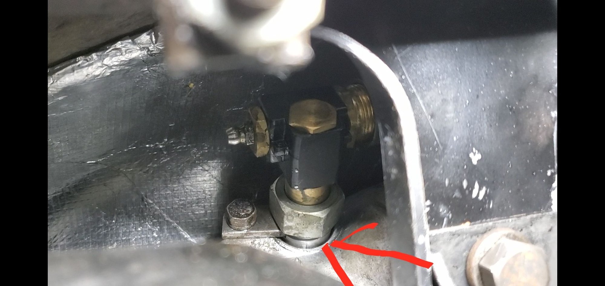

Last time I had the car out, the speedometer just quit working. I got under the car tonight hoping to find the cable came off... But it's connected. When I rebuilt the motor and transmission last year, I installed one of those 90 degree connectors to make it a little simpler. And it worked fine until it stopped working. So I know it did work.
When I checked it tonight, the connectors felt solid, they didn't wiggle. However, there was some relative movement in the area where the red arrow is pointing. It wasn't a lot, but a little. Is that normal?
If that's not the problem, where do I look next? I'm deathly afraid of getting into or behind the dash... I'm sure some plastic part will break on me!

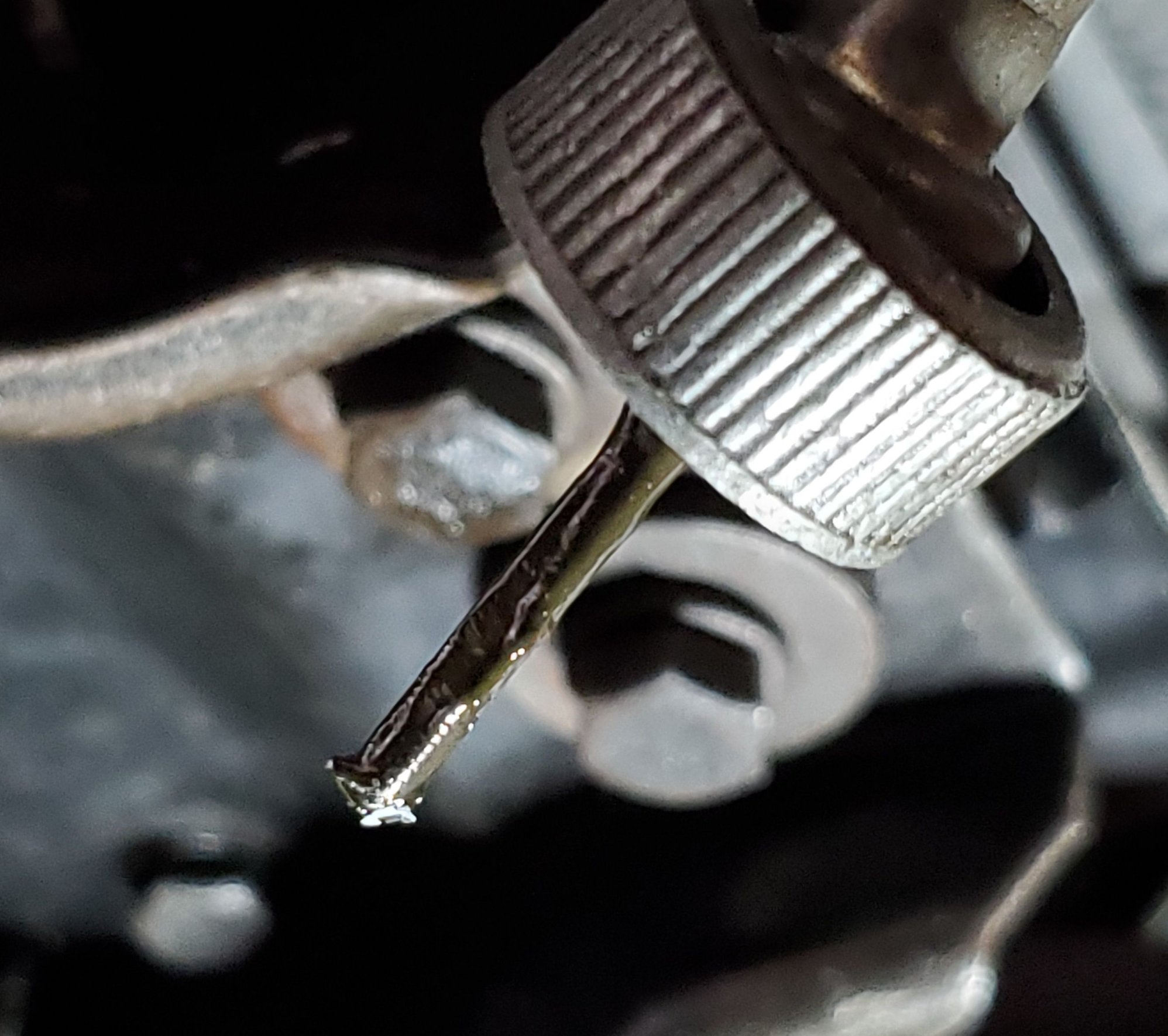

I got under the car tonight and tried the cable in the drill test and the speedometer worked! So the cable and the meter are OK. However....
When I took the cable out of the connector, it looked like small metal flecks on the end of it, which probably isn't good?
There looked like there was plenty of Grease in it. Here is a picture of the fitting/connector. There isn't anything jumping out at me in this picture?
So then I thought I would try to take that connector off and connect the cable direct to the trans like original. But I can't get that darn connector off! There is almost no room up there to get a wrench on the flats. I was able to get a channel locks on it, but couldn't get it to move...
Any suggestions?

You have the same problem that I did trying to remove the 90 degree adapter. I am thinking the service shop I used employed a special wrench or they took off/loosened the bracket on the tranny. I have a manual 73 Muncie and your bolt holding in he plastic gear looks differ than mine, it may be the head on yours is larger. Have you tried “Long Nose” Vice Grips. Hopefully someone will tell us how the adapter is removed. The service shop that I use typically installs the 90 degree adapter. They are owned by one of the largest used Corvette Dealers in the country. I know some folks don’t like the adapters.
That's good news about the cable and gauge. The metal on the end may just be the loose strands of the cable winding and if so isn't anything of concern. You can flush clip, grind, or file them if you feel they're interfering with inserting the end into the housing.

That cable looks like the end broke off if I'm looking at the pictures correctly . wipe some of the grease off , those cables always twist off the end ..... My speedo just quit in my 1980 , the lower cable from trans to cruise control transducer broke ... turns out the original cable didn't like 140 mph
Edit to add .... My original cable had a 90 degree reinforcement right where it goes into the transmission that I transfer over to the new cable
