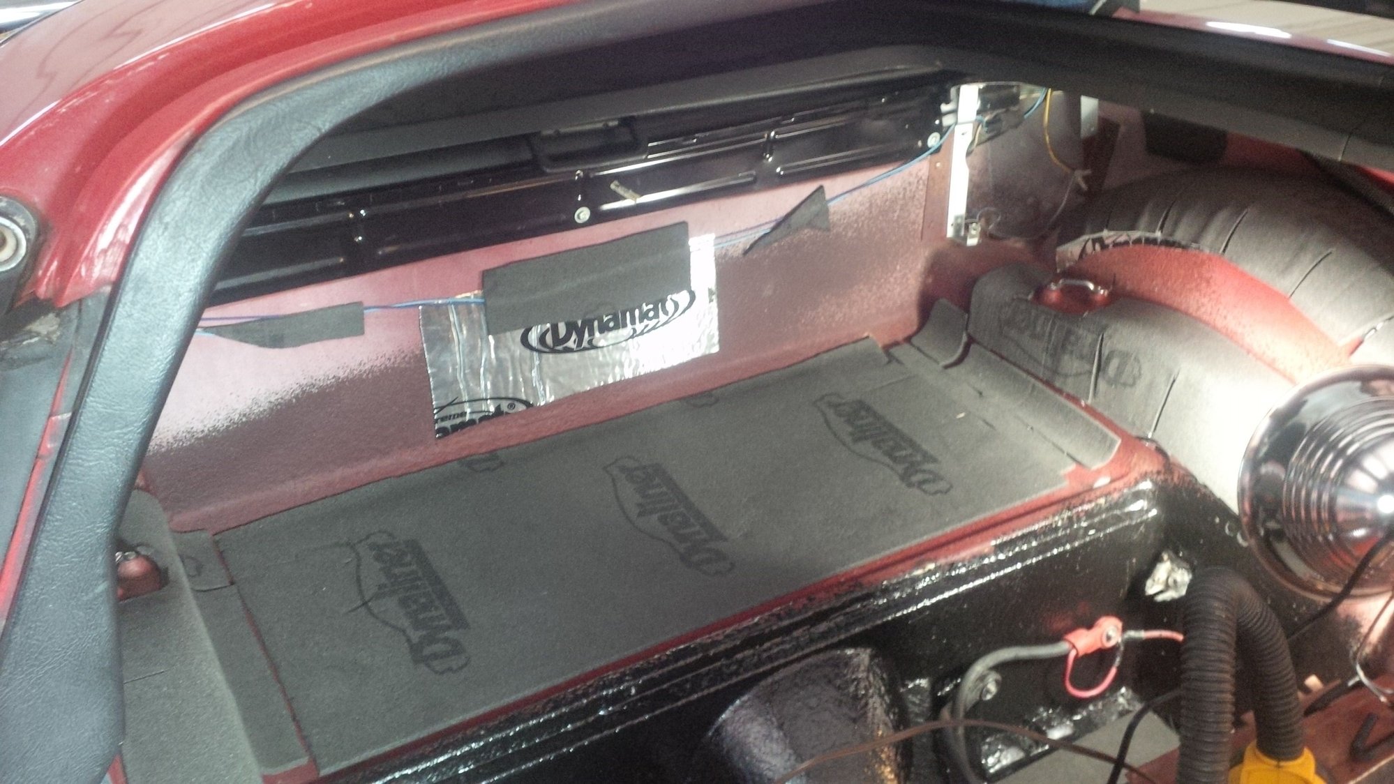

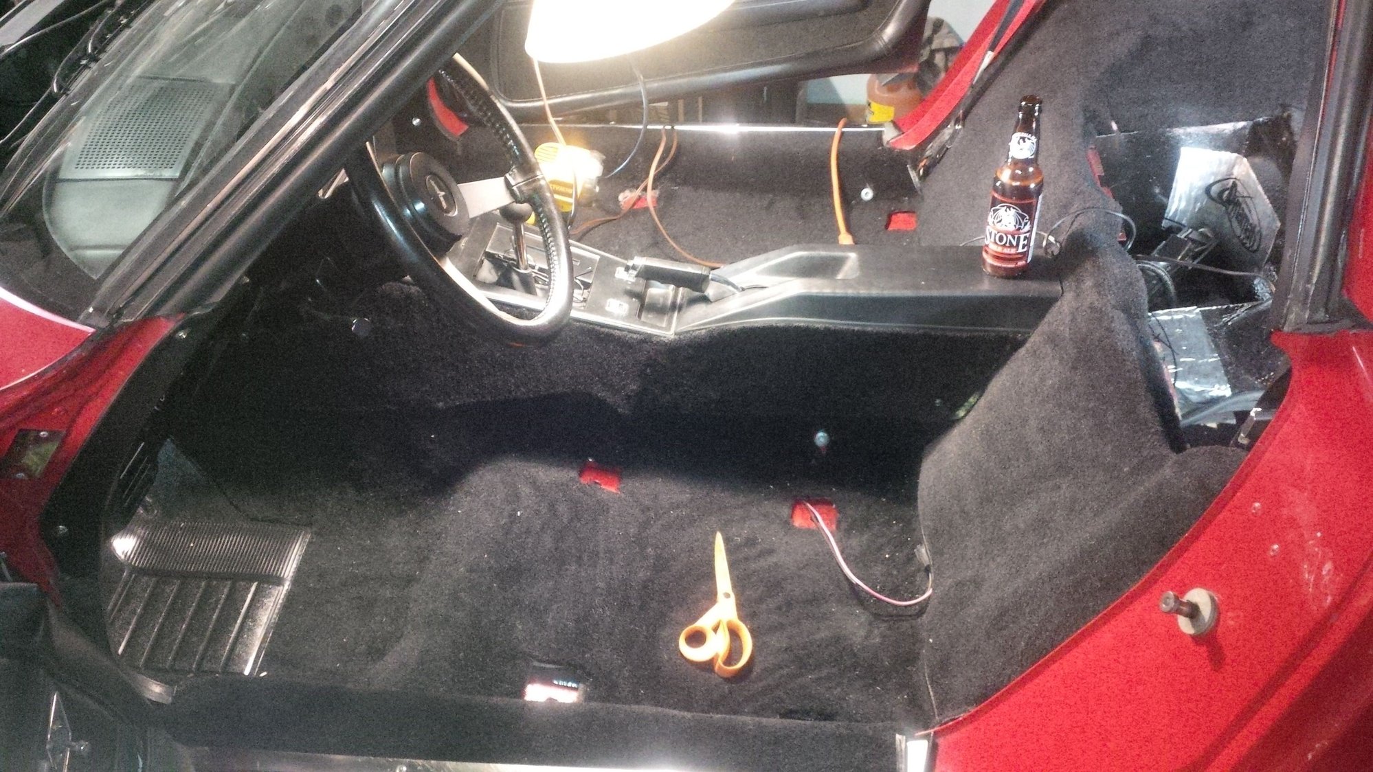

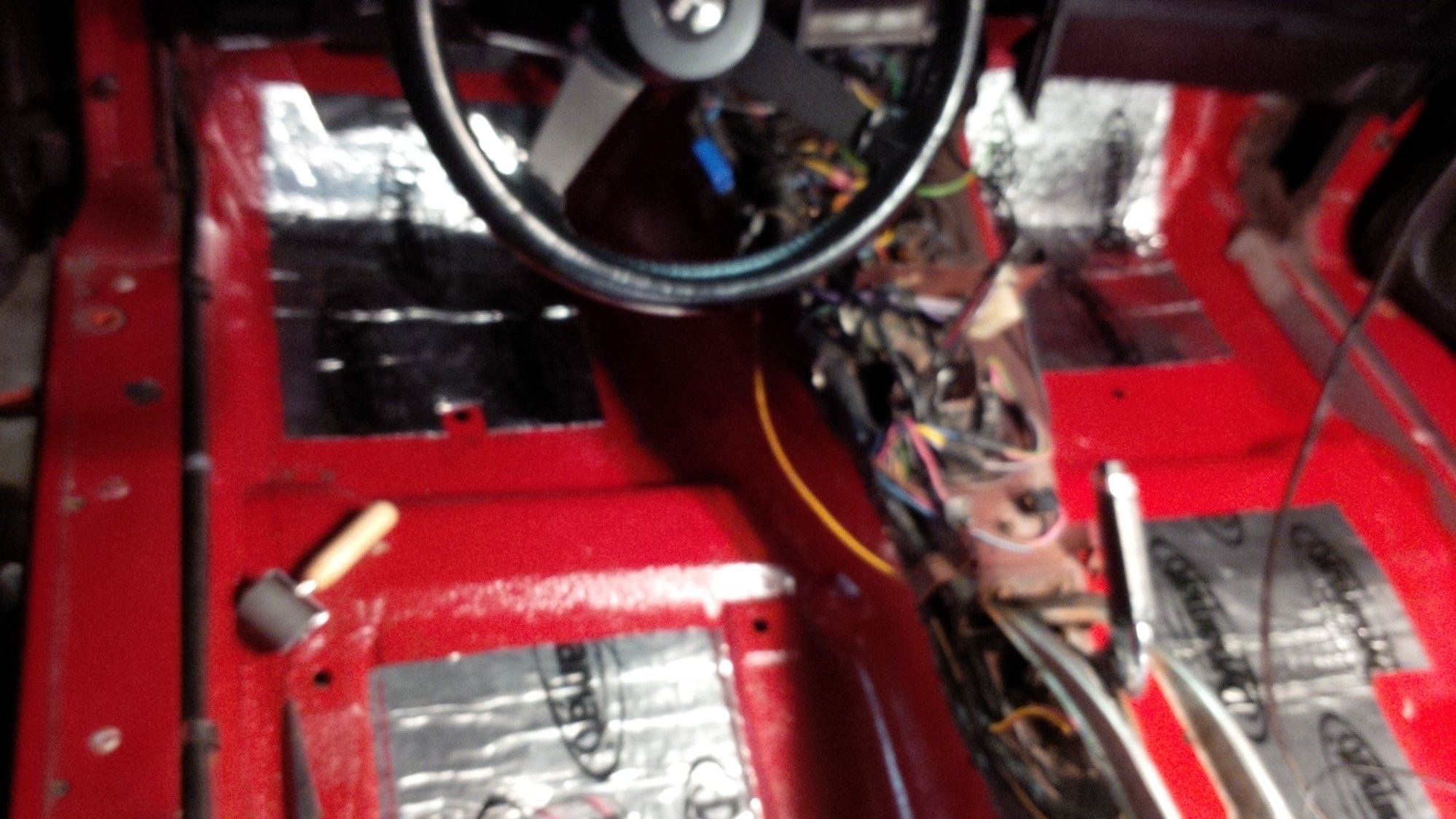

I just finished putting dynamat in my 69 Corvette. dynamat is mostly a sound deadener and not so much an insulator against heat. Dina sells a heat insulation material that you can use under the sound deafened. I did not use the jute and think it was easier to install the carpet and the quality was better.

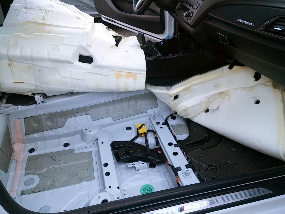

I'll pile on here. DynaMat is a sound deadener. It adds mass and dampens/deadens sound vibrations. They also have a insulating material called DynaLiner which is a great product. You can get it in different thicknesses but I used 1/4". It's adhesive backed, so peel and stick. It's great stuff and holds up well. Use DynaMat on large panels in the center mostly to reduce vibration. Use DynaLiner everywhere you want to reduce heat transfer. It's light so no worries about adding a bunch of weight too. And I'm pretty sure it's a better insulator than the jute from the factory.
https://www.dynamat.com/products/dynaliner/
