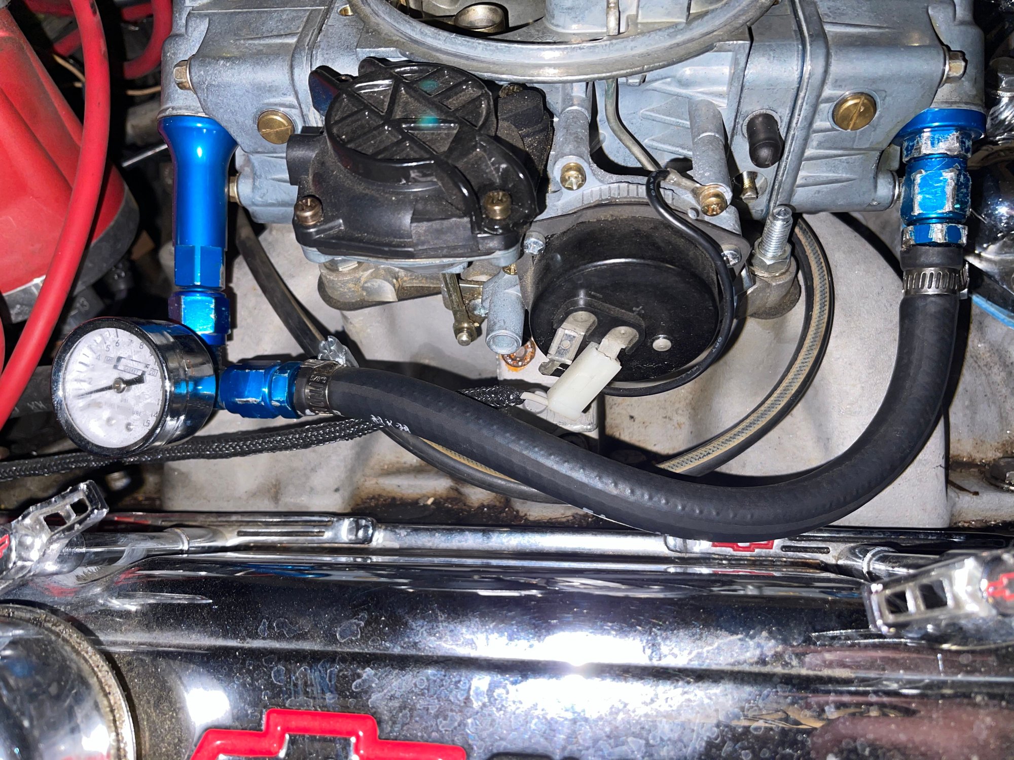

The extra pressure I believe comes from this temporary rubber fuel line I have going from my gauge to the carburetor as the last time I messed with my jets my stainless line decided to dethread itself I have a new line I just gotta make when it arrived it was too long and I have to cut it to fit. But it was doing this before when the pressure read normally and I had my stainless line on there

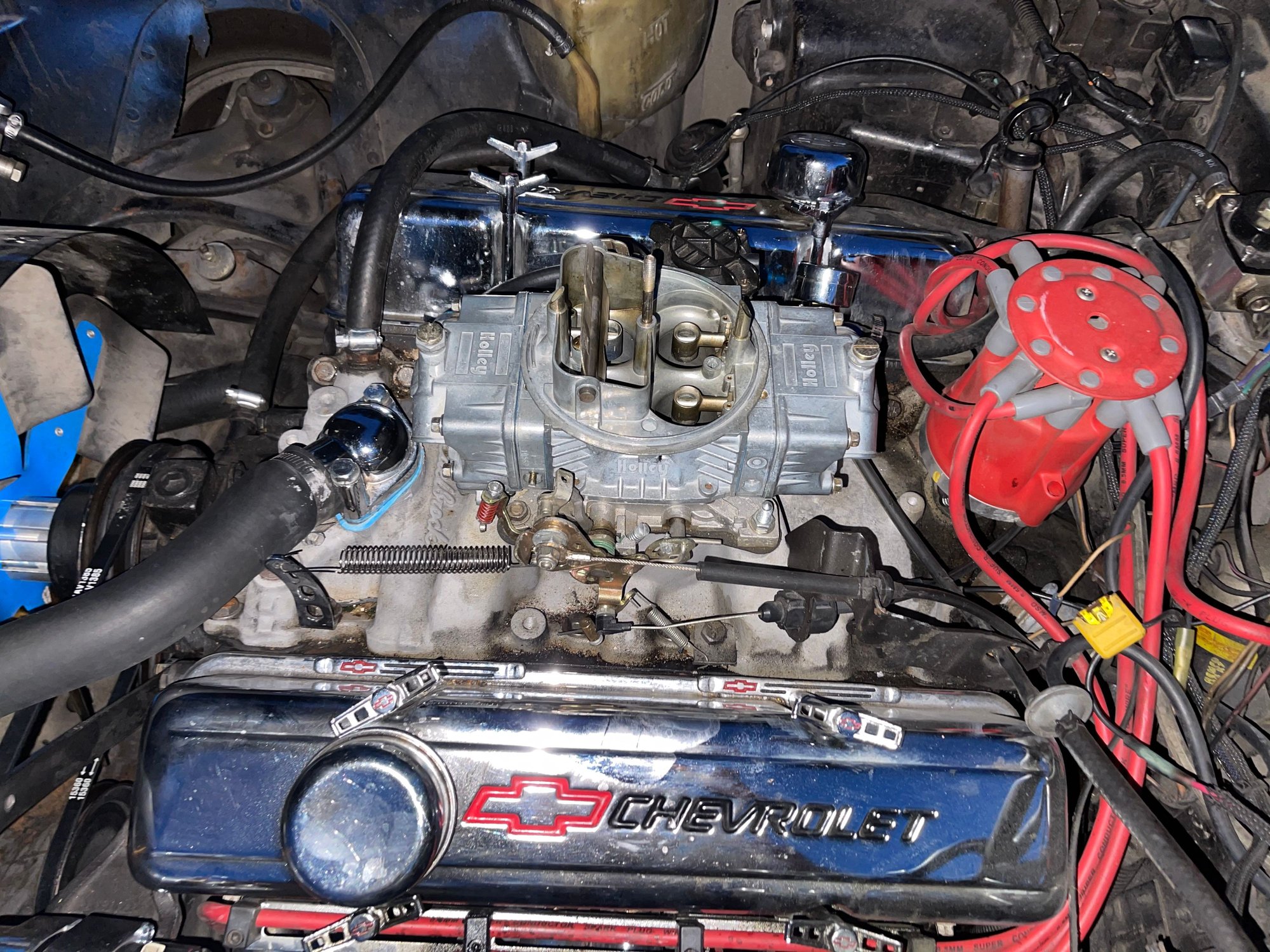

Working on getting a timing light to check timing, will be rechecking and checking the jets, fuel bowl float, and air/fuel ratio, etc.. tomorrow also uploading pictures of carb in next reply

Default Yes I know it’s dirty and messy. Lots of bubba work done not by me

Your fuel lines look like you are not using a mechanical pump, are you using an electric fuel pump?
As already stated, if you have 10 PSI, it's too much.
Once you have the correct pressure, check the float levels.
You accelerator pump does not appear to be correctly adjusted. Watch this video.

Based on your pictures I do not see a vacuum advance diaphragm on the distributor.
If so, that is not the correct distributor for a street driven car.
