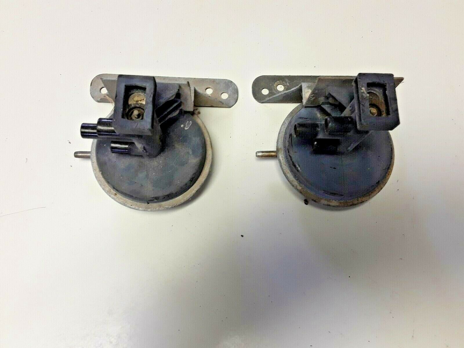

the springs are too stiff in the repop relays. your old relays had mud wasp nests in the vent hole in top left of pic. you should be able to fairly easily raise or lower either headlight with lung power. pull the hoses off and blow them out first. sucking on a hose and inhaling old bug nest is unpleasant. and blow out the large long hose that goes from the motor to the vacuum tank. in fact pull and blow out every vacuum hose. the brown semicircle is the wasp nest. vacuum does not move headlights. the one atmosphere of air on the other side of the diaphragm moves the headlights, this one spot is where bugs block that air passage.
