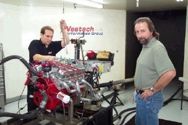

Here's Matt King (black shirt) and me setting up the points distributor from his Falcon in the 302 test engine to run head-to-head against the top-end capacitive discharge systems:

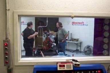

Notice that we even used the old crap wires out of Matt's Falcon for the testing:

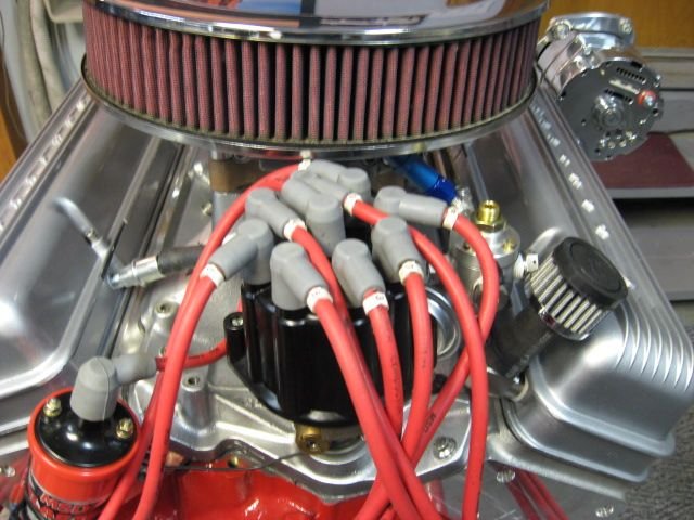

Here's the same engine with one of the fancy aftermarket systems in it and some really nice red plug wires:

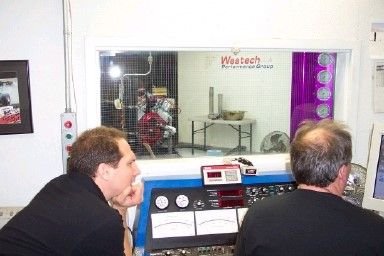

Famed Westech Dyno Operator Steve Brule (left) overseeing the testing:
Results: Absolutely no change in power whatsoever from one system to another, as long as the advance curve remained the same (note Matt King's astounded "I can't freakin believe it" expression):
