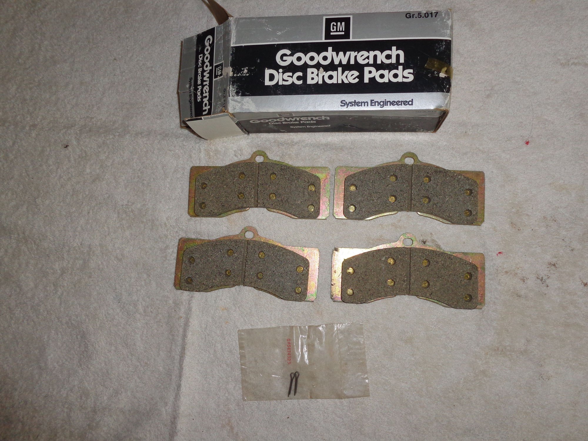

1975; power brakes, good condition original rotors,;;; I’m not raceing or auto-crossing, normal spirited driving,, ,, I’m replacing oil soaked pads after rebuilding all SS sleeved calipers with O-ring pistons,,, I’m finding original recommendations for stock rotors was for “organic”

Thanks ,, you all have reassured me that I'm on the right page with pads,,, organic seems correct,, im still on the fence with ceramic compound,, in my case im leaning--I don't need ceramic-- .
