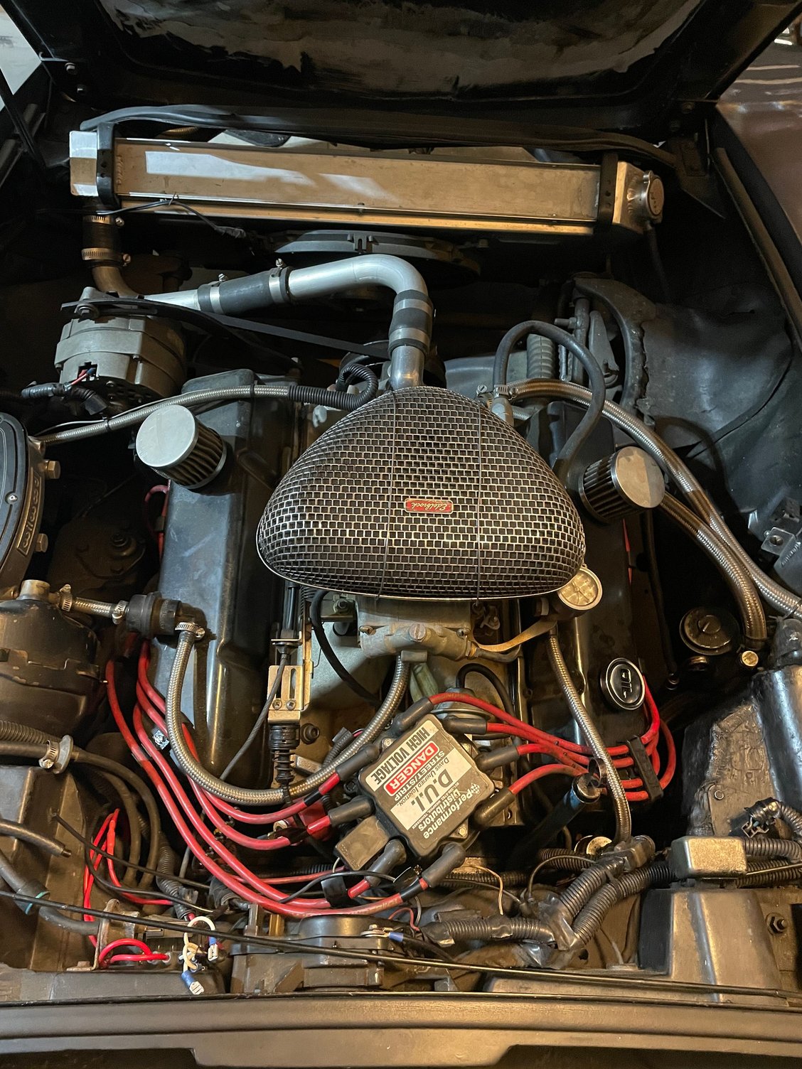

Picture prior to removing engine

Your plug wires are not in the right firing order - you have all the wires on one side of the cap going to one side of the engine, and all the wires on the other side going to the other side of the engine, and the distributor is not correctly installed or clocked in the engine.
Distributor and wires should be like this:
Lars

The firing order of the distributor was taken into consideration and plug wires are connected properly. They are also in the same places they were before the engine was rebuilt.
The engine also runs fine in higher RPMs so I suspect that rotor placement is correct. And drivers side bank fires well at any RPM as well. I could be wrong about rotor placement though.

That is not even possible based on the pictures you provided unless you have some weird cross fire side counter rotating flux capacitor distributor installed.

That Crossfire cap is very different then most people are used to. Since it essentially rearranges your (at least perceived firing order), I might think that it might be worth a closer look.
https://performancedistributors.com/...crossfire-cap/

This DUI distributor has a cross fire cap.
https://www.chevyhardcore.com/news/p...i-even-better/
