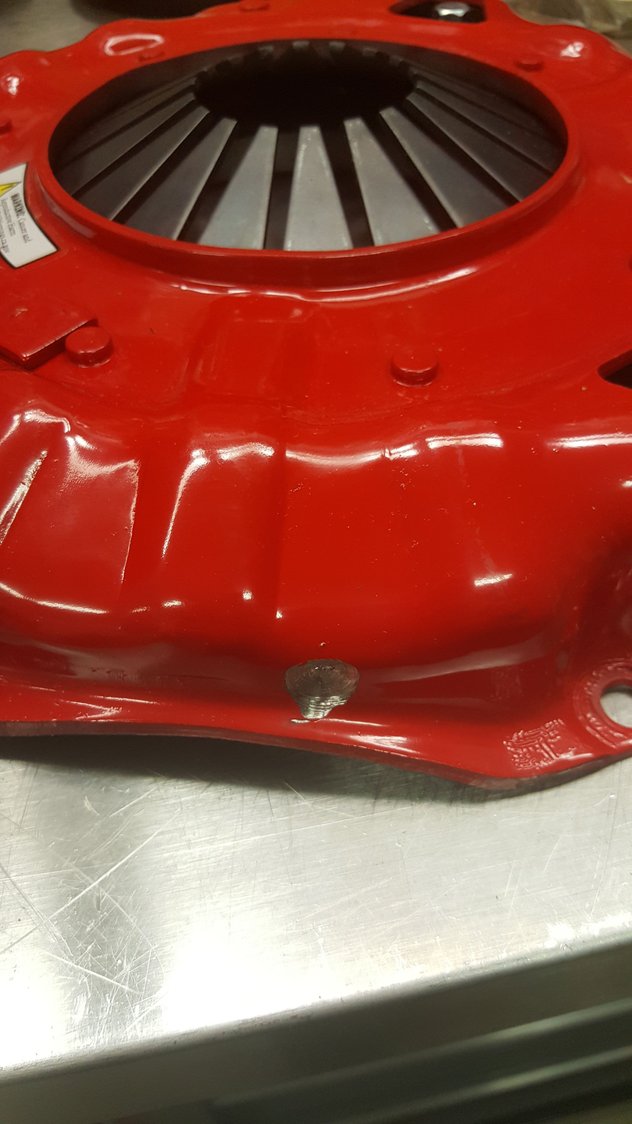

One more thing - Mcleod will tell you that you need to have the clutch pressure plate balanced locally. They do not come pre balanced.
Didn't need to take much off this one. Just one little divot.

never heard that one....Ive never balanced one and Ive been chasing a vibration and the engineer never said it had to be balanced by me. I'll have to ask next time we talk.

Wow! Good to know, I wouldn't have guessed.Thanks. I'm gonna hit them up with that question too.

Page 3 of the instructions has info on balancing the assembly. They will do it in-house, on request.
