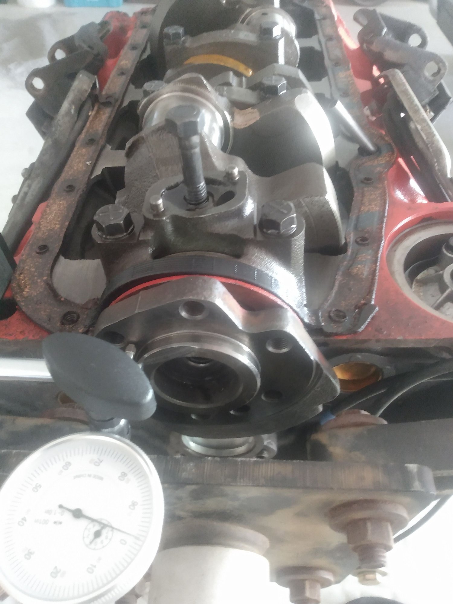

I agree Rescue Rogers, I never had this done either when doing a clutch and never had a problem, however, never had a problem with a bent crankshaft flange either. Correcting this awful clutch chatter has turned into the worst case scenario. I'll be ordering a new Scat crank and am considering getting the crank/flywheel/pressure plate balanced all together, if that is even possible.... I don't want to leave any margin for error, and want this to be the last time I do this. Wrenching on them is half the fun, but it's kinda nice to drive them once in a while too.

If you put the flywheel on your bad crank, can you shim it so it runs true?

I don't think I would try to shim it, but a machine shop could probably turn the face and square it to the journals if it is just a slight tweak. If you shim it, you are loosing the crank to flywheel / metal to metal connection and you are relying on the sheer strength of the bolt at that hole.

Yup, I looked into shimming it, and did find one person that was successful in doing so. I wasn't comfortable doing it that way, just seemed like a bandage approach, and I agree with the other issues bluthundr brought up. I also did consider having a machine shop reface it, but figured I rather spend the $240 and be done with it. After the smoke clears, I'll be into it about $700 and who knows how many hours, thanks JD Machine and Performance (Lake Havasu City AZ)!
