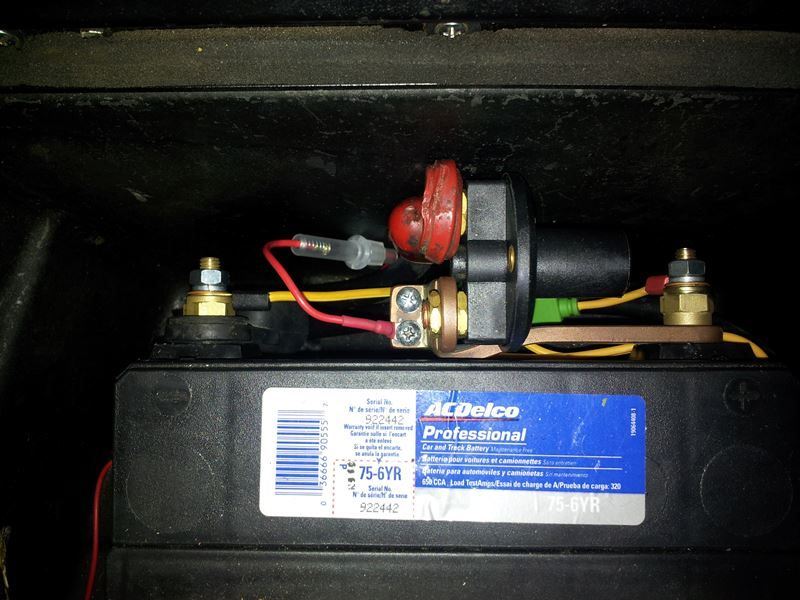

i bent up a piece of copper plate and mounted a "removable key switch style" on my side post battery
even added small screw terminals so i could keep the clock (after running a new wire) and radio memory still connected.

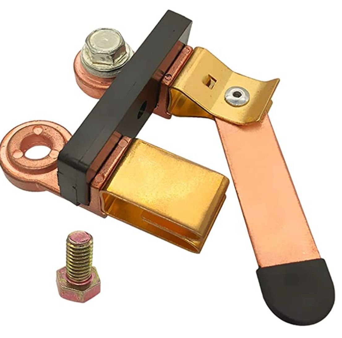

I use the knife style battery cutoff in all four of my C3s, works great, piece of mind when stored, collector car insurance gives discount for use too.

I have one of these on my 78 side terminal and it works great.

I recently installed the knife type switch (Napa) like 74 Stingray has pictured. Took about twenty minutes. Attach to negative cable first, then attach to battery post I found the easiest way to do it.

I've used this same type for years on multiple cars. Always worked great.

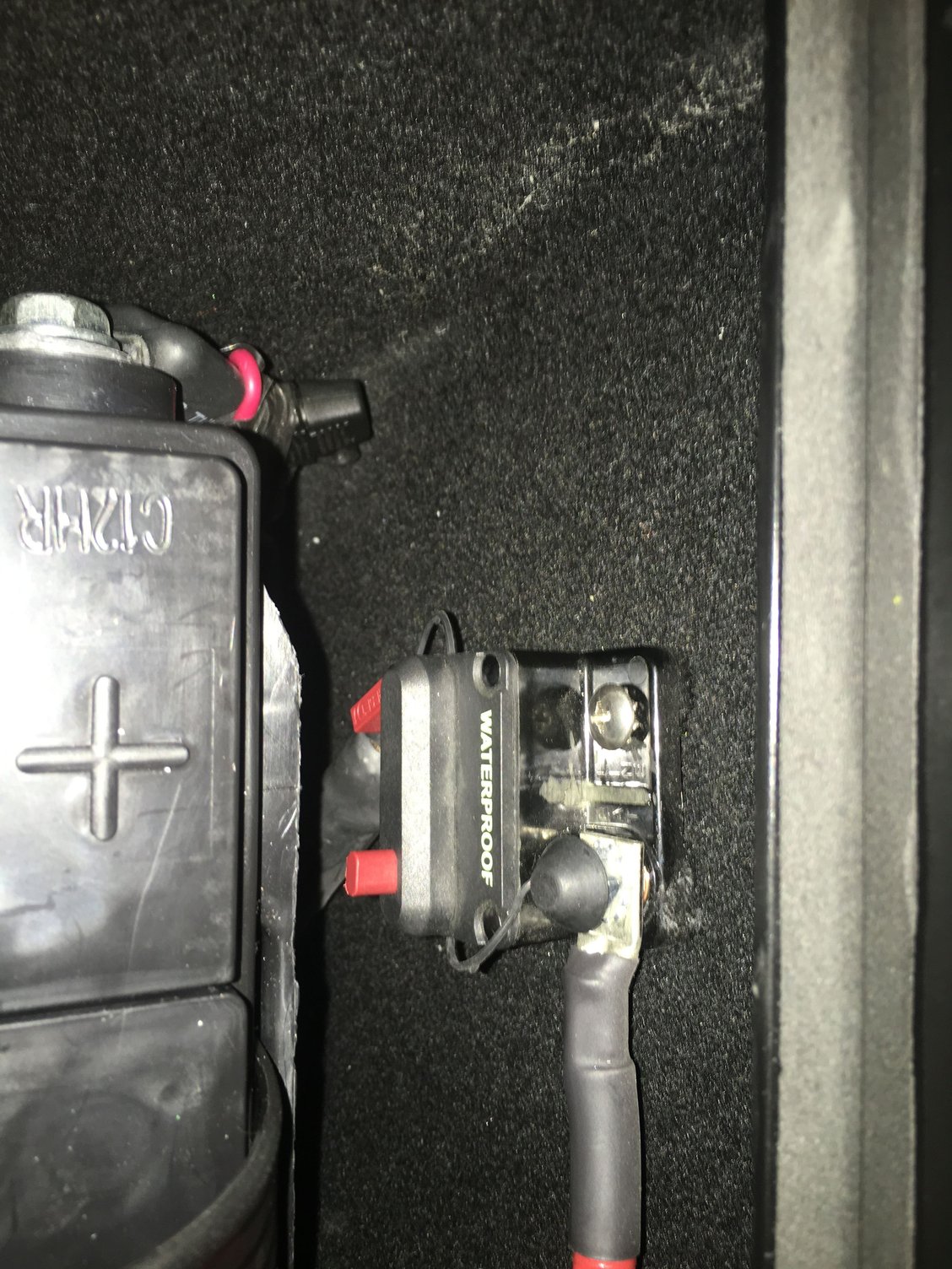

I sent ya a messg. Here’s mine. 100amp breaker from auto parts store. Push red button kills all and on bottom of it a red tab comes out just push tab in and it resets. Wired radio memory to constant hot side. Hope this helps. Ps. I bought the shortest pos. Cable I could find to go to batt from breaker. It’s clean and tight. No keys to lose

I've used those breakers in other applications, and they work great. Is 100 Amps enough to run the starter? I'd think a 250 Amp unit would be a better choice, since you are only using it as a switch anyway.

I have used just the 100amp with no problems at all. I would like to believe if you trip the breaker starting the car then there’s another problem. I don’t think 200 amp would be needed but I’m sure someone will correct me on this. I have had mine I for two years turned off and on to many times to count. No problems at all. Great knowing all batt is turned off so no drainage.
