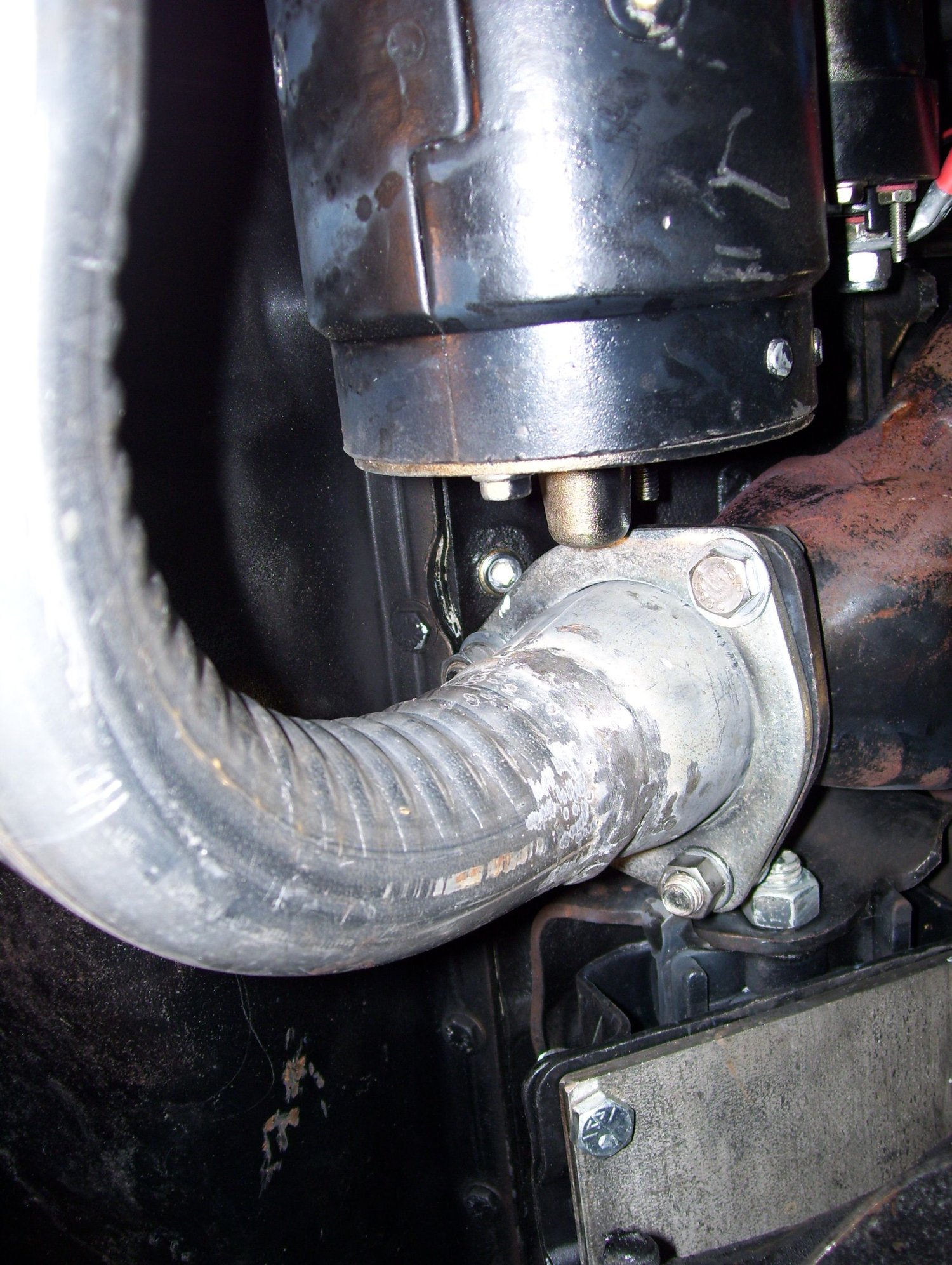

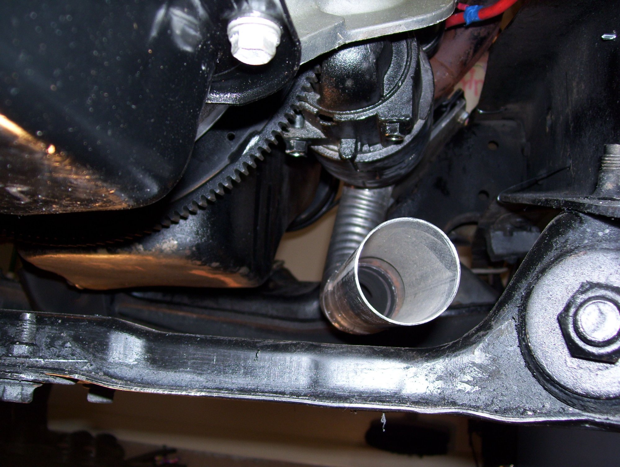

It's been 15 years since I bolted shorties on a SBC...but I think I had to remove some metal from the rear of the motor mount on the driver-side to have clearance to bolt the header in place without rubbing on the motor mount...(no pics)
Below are pics of the passenger side header with about 1/4" clearance from motor mount and 1/2" from starter nose............(ignore the Ford frame adapter plate).......
