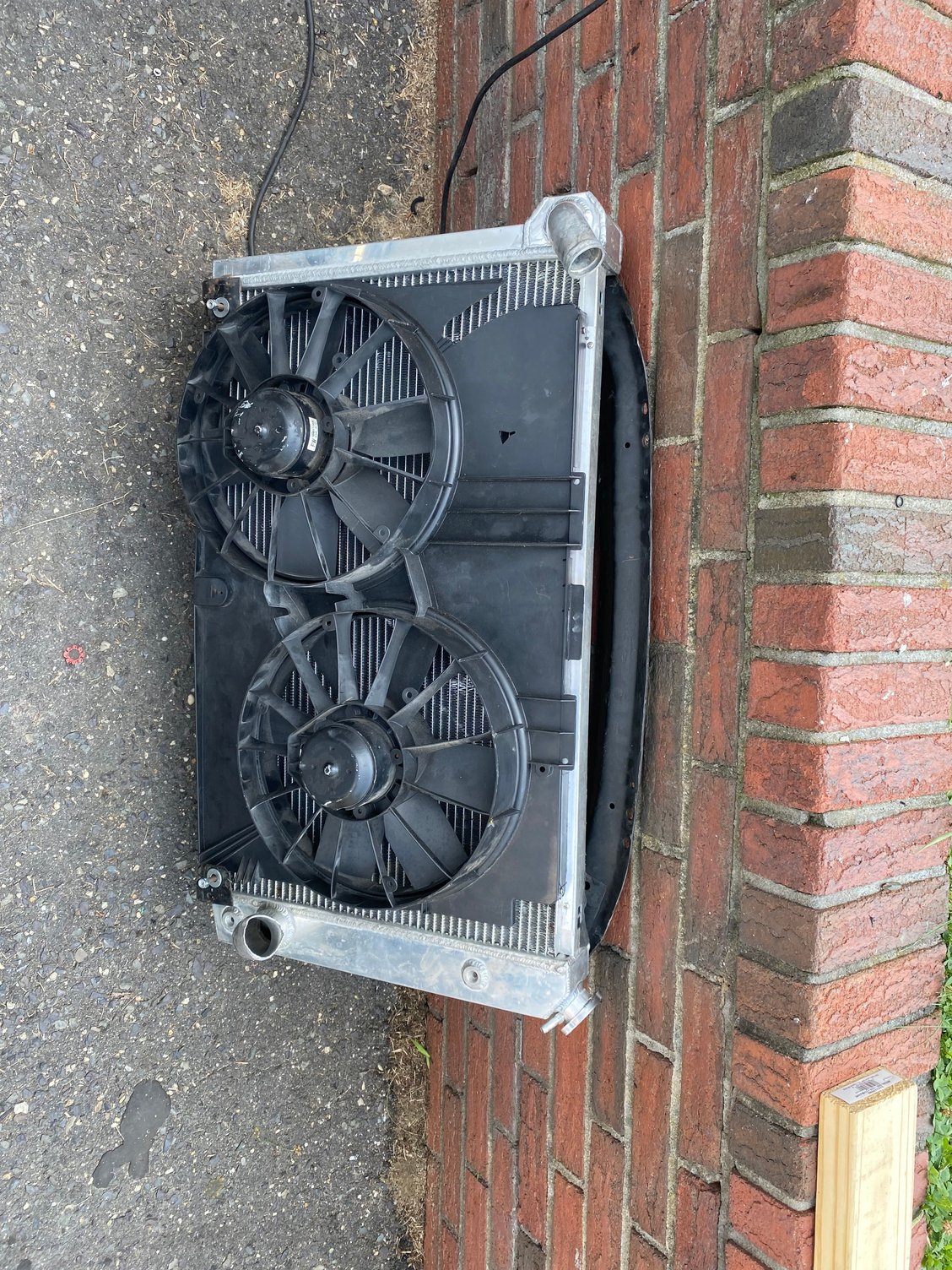

do it wrong and an iron duke 4 banger will overheat in a vette. do it right and a 572 will stay cool. yours is a blank slate. you need a new rad anyway. i like the c5 corvette fan setup. 100 bucks used and fits the radiator well.

Adapt these to the tilted radiator, or the whole C5 shroud assembly?

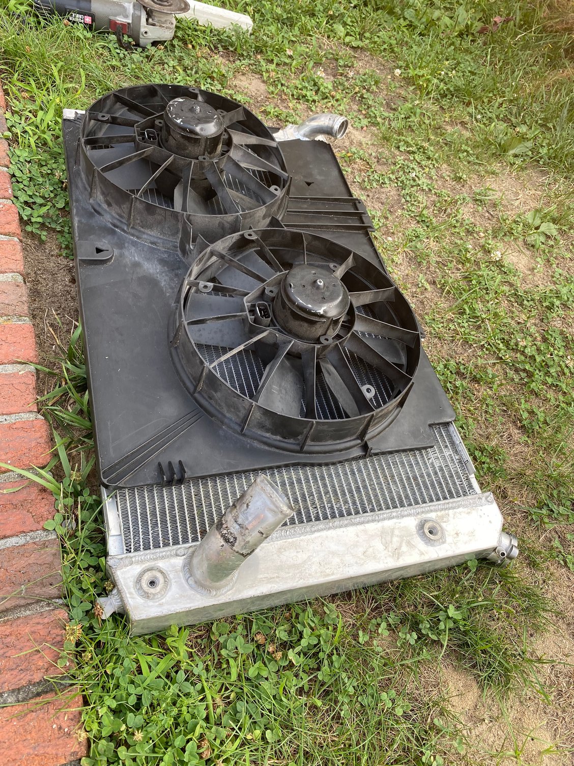

https://www.ebay.com/itm/31357841089...gAAOSwpDJg1Knc i used a couple pieces of aluminum angle screwed tp the top and bottom frames bordering the core and the shroud fit it perfect. Then I cut up a lid from a storage bin and I made up the missing pieces of plastic on both sides of the shroud. I found a black one so that it kind of matched. Don’t have any pics of that right now though..
Then I cut up a lid from a storage bin and I made up the missing pieces of plastic on both sides of the shroud. I found a black one so that it kind of matched. Don’t have any pics of that right now though.. need to offset the fans a bit to the left to clear the upper control arms. and way way easier to get in and out of the car.

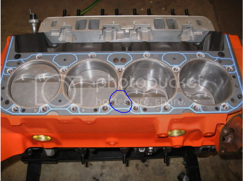

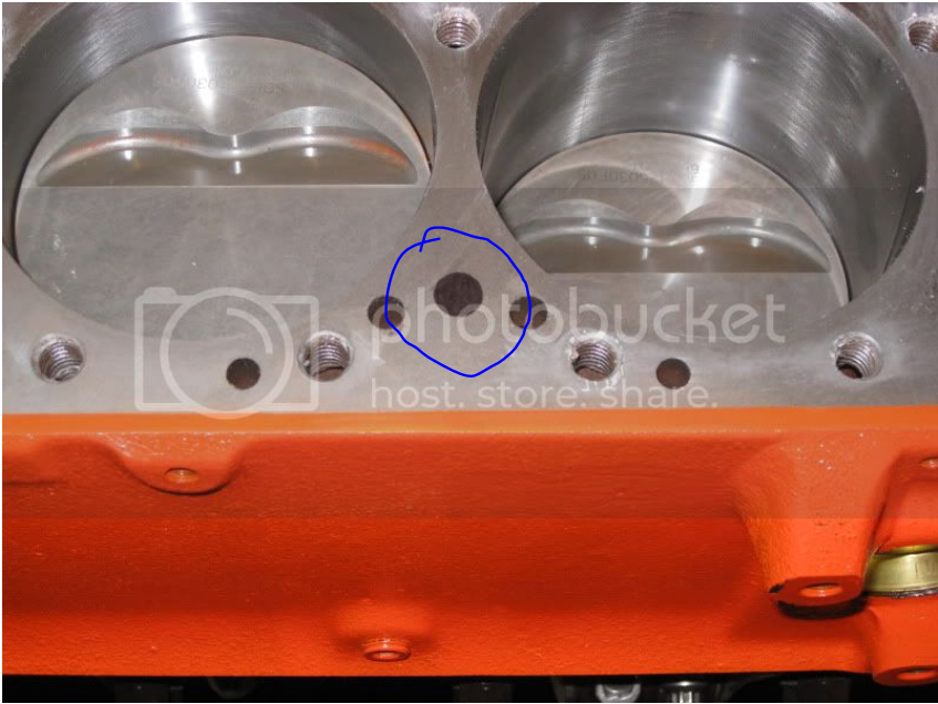

I run a Dart headed 406 in my 72'. It has the bone stock rad, water pump, 7 blade fan and clutch. It never goes over 190 degrees ever......
My upper hood seal is gone as I run the L-88 hood. But...I have spot on timing specs and jetting and I drilled the lower steam holes only on the Dart heads..(why would you drill the upper, lower is trapped by the cylinders, upper is not). I also have the Fel-Pro block mod I drilled in the block to help keep the two center exhaust ports cooler.....and this helps for a few reasons....I think it is a must for 400's.
The 400 got a bad rap back in the 70's as a perfect storm of bad timing specs, **** maintenance, and less flexibility to run on low coolant.....almost all were put in Craprice's that nobody took care of.
My Aunt had a 77' in the 80's and it overheated because she never did **** to it......never checked the coolant one time.
The cylinder walls are just as thick as a 350.....just that one area of the bore has no water going next to it.....
