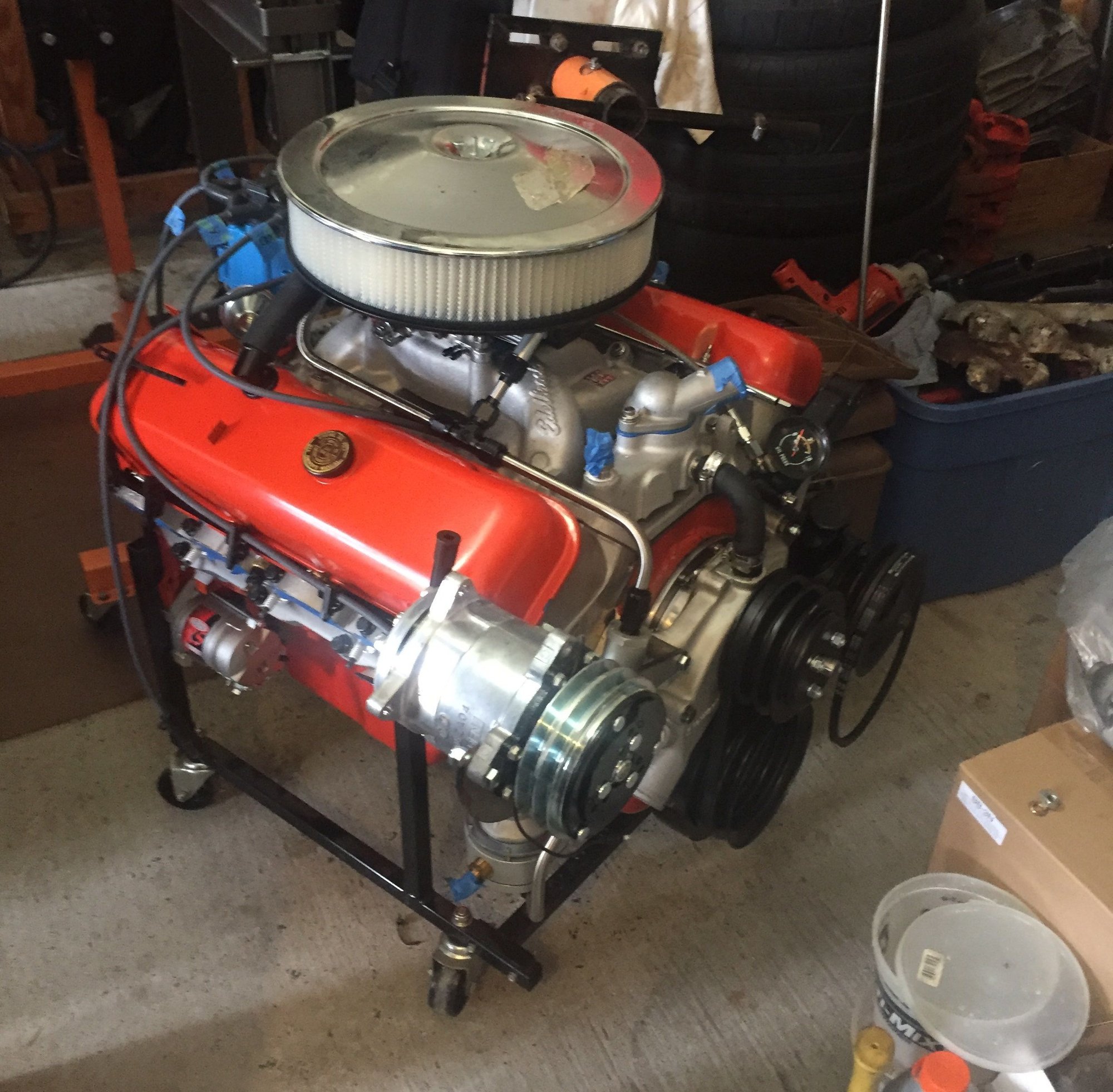

I used the LS6 line when I swapped over. Flaring and bending are easy with GOOD tools.

So you had to modify the LS6 line a little bit?

From: Lincoln, CA
I cut the line to splice in a filter and return but from pump to carb is should bolt right in.

Beautiful Engine there ddawson!
