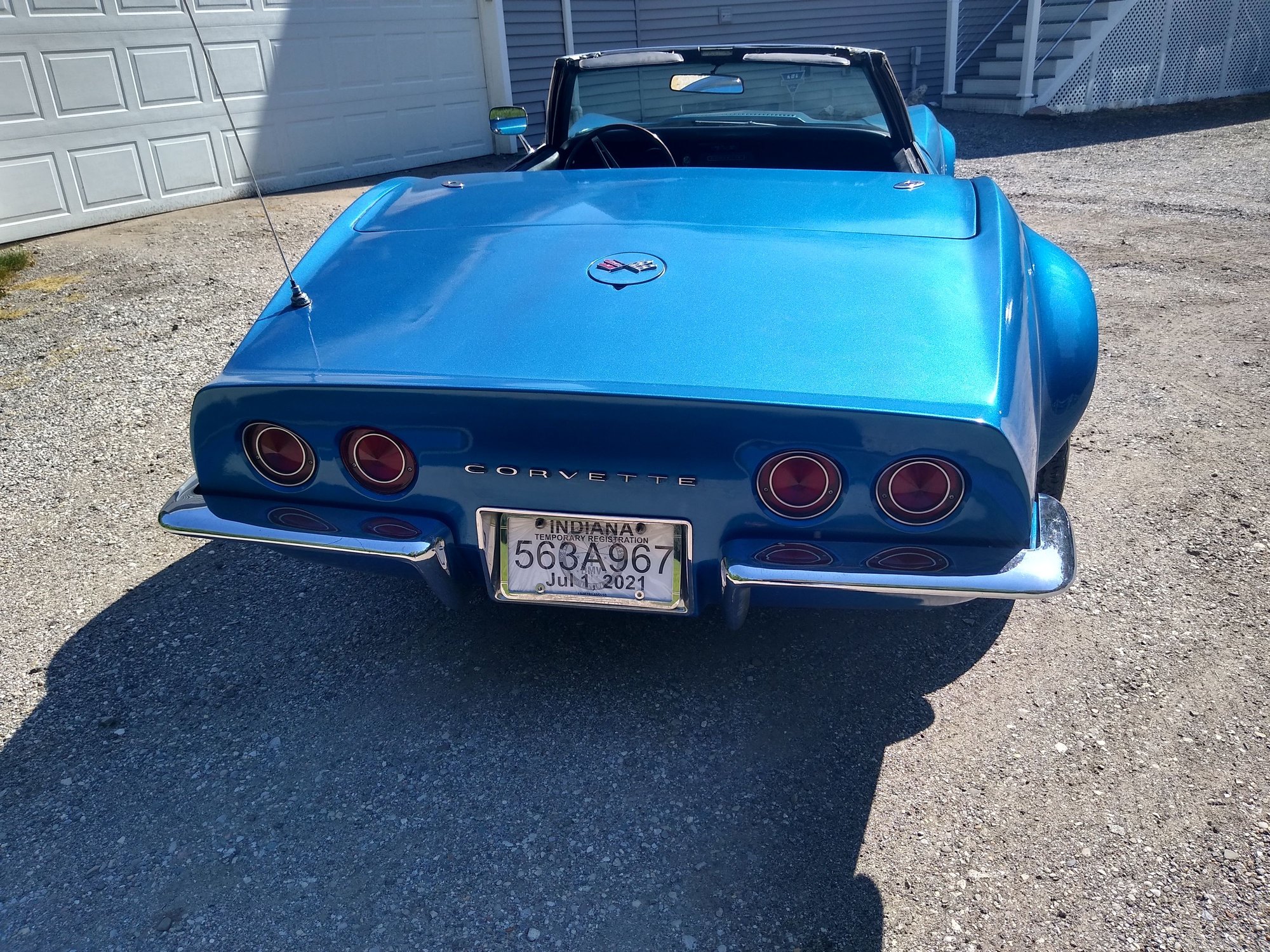

Here is my current setup....

Very nice. I dont have those awesome flares so you can obviously stuff some big meats under there. If you dont have offset trailing arms then you will have to stay with the 3.75 to 4 inch back space but you could stuff a big 10 inch rim back there. If you go to tire sites like tire rack they have tire size calculators. The stock tire height was 27 inches. I would stick to 27 in the front and go 28 in the rear and just rear gear the speedometer driven gear to compensate. As for wheel size thats your personal preference bu the best tire selection is now 18 inch and then 17 inch behind that. You have 2 or 3 for 15 inch and next to nothing for 16 inch, that shouldnt even be on the list.
215/70/15 was close to the original size. Punch in here and you can see how the comparisons work
https://tiresize.com/calculator/
255/60/15 is the go to for most stock size wheels now a days
