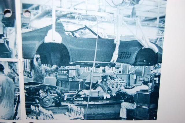

they glued it because it needed to stand up while body met frame on assembly. someone once posted a picture of it somewhere..it will hold fine without
