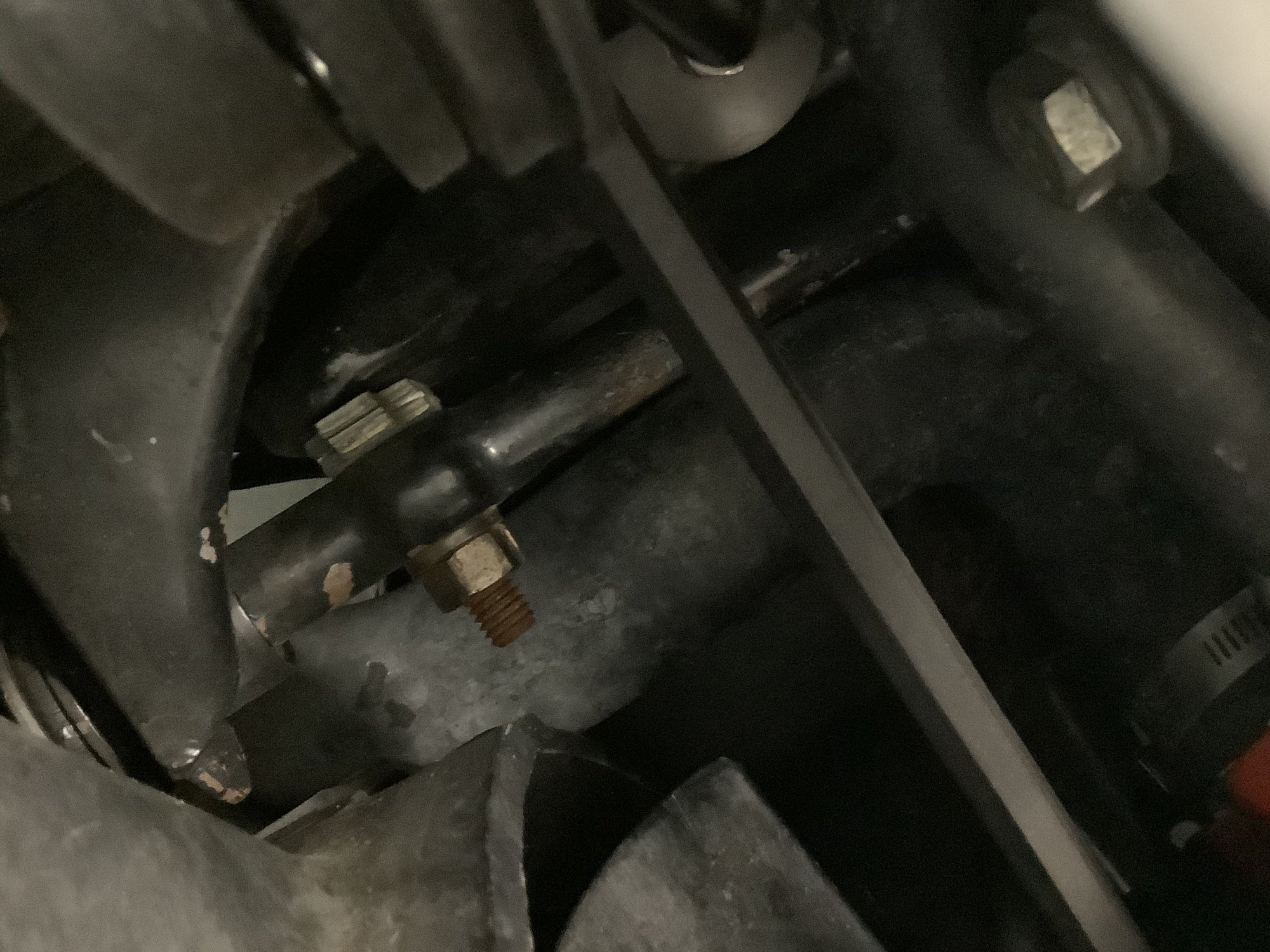

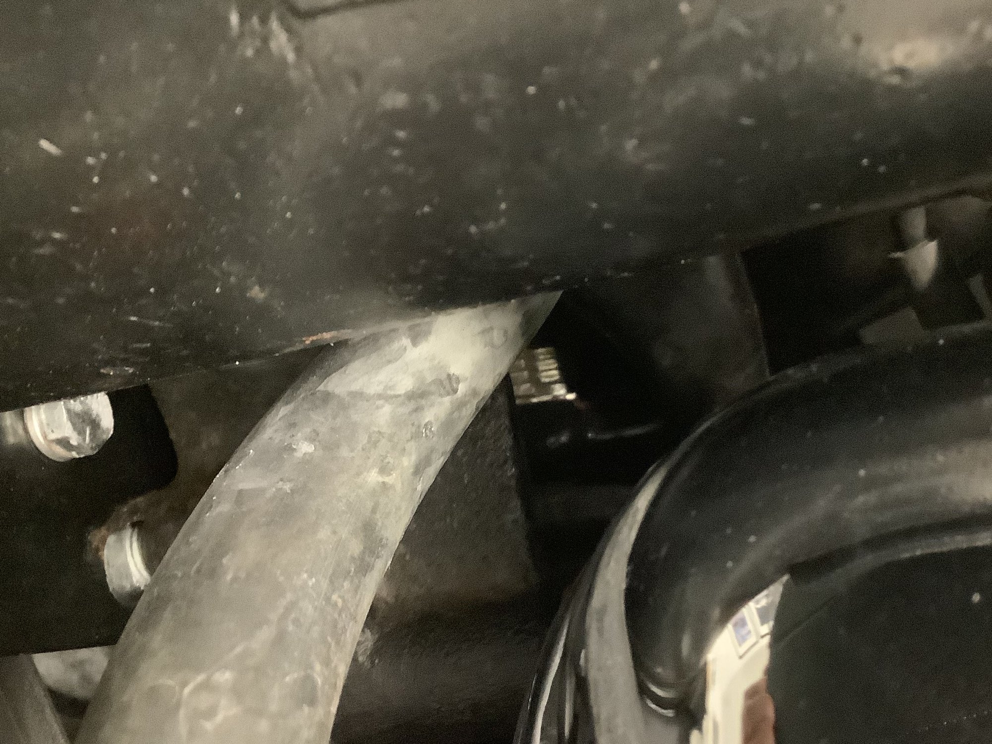

Seems to be a lot on the rear of the passenger side.here’s a couple more pics
hard to see but I think you can make them out. Thanks again
