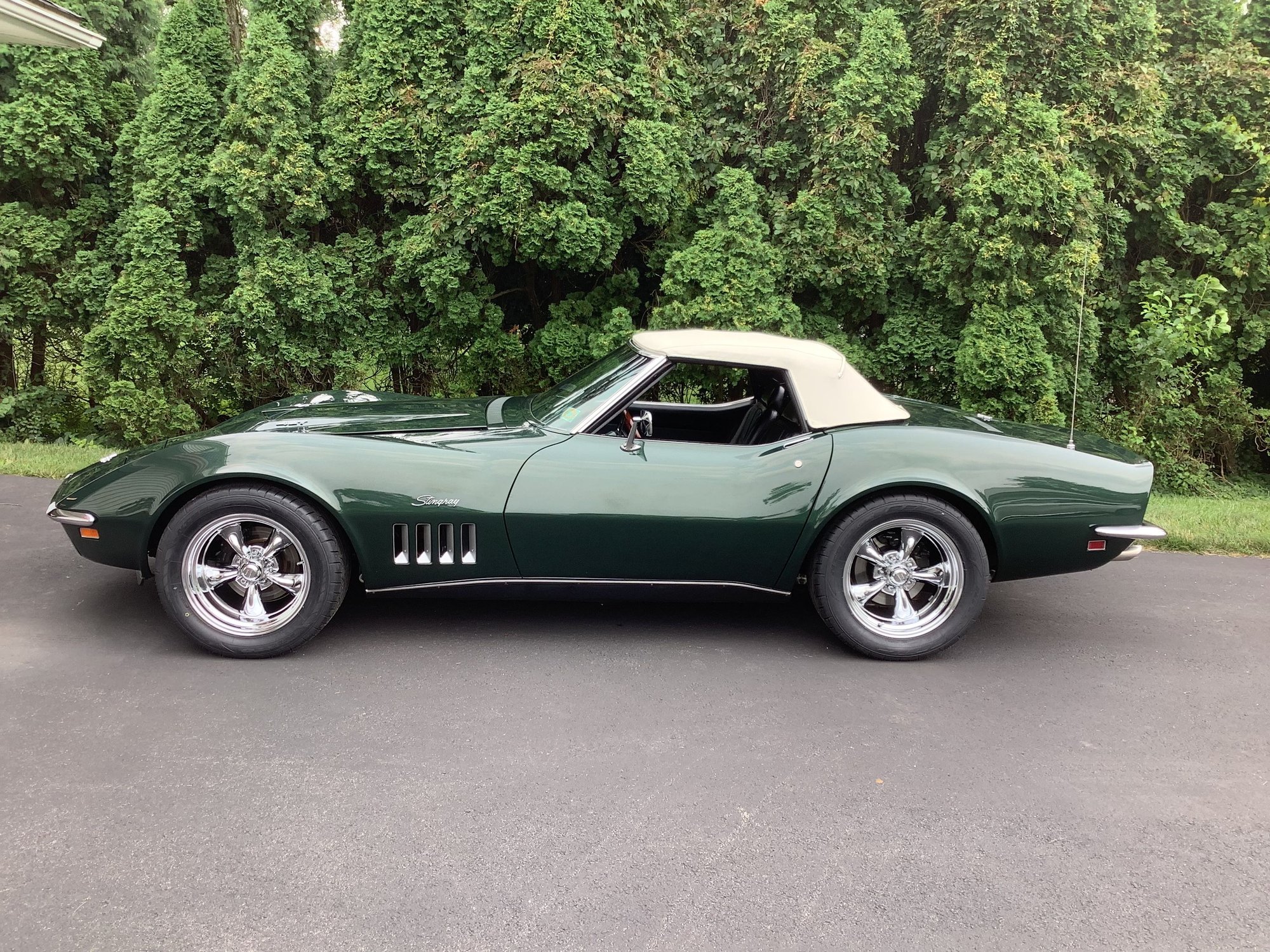

These are the F 70 15 back on .

To the OP, your car looks fantastic with the 15's on it......so I say forget about the 17 or 18 inch wheels. They do perform better, but if you are not canyon carving at high speeds, its really irrelevant.

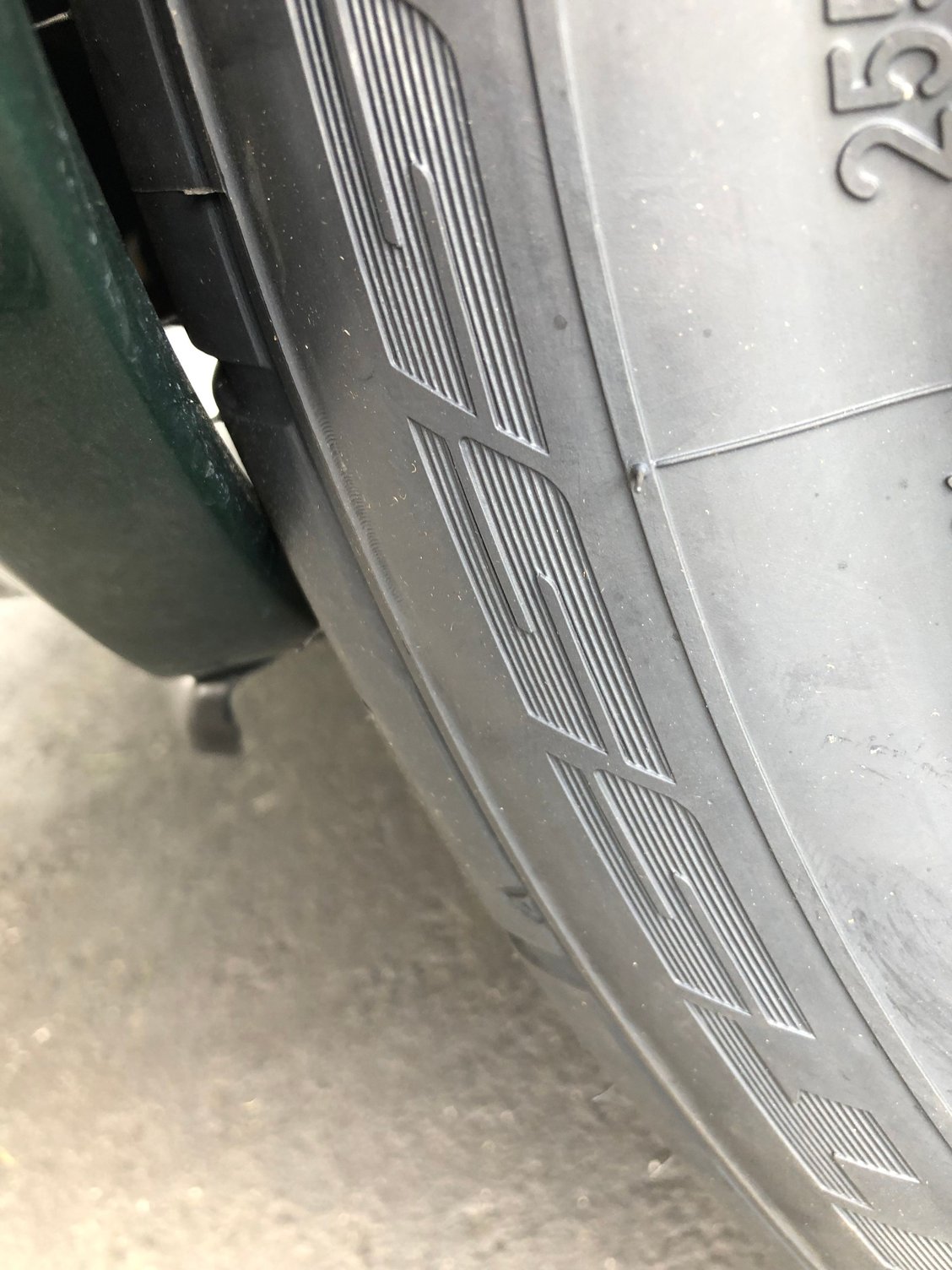

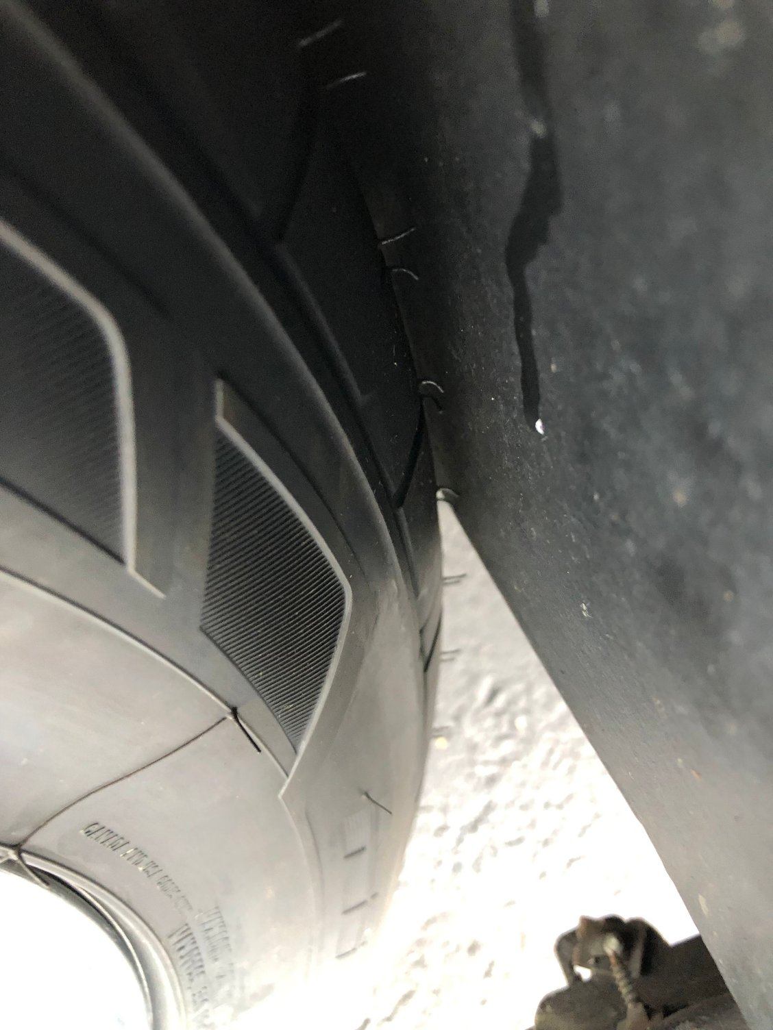

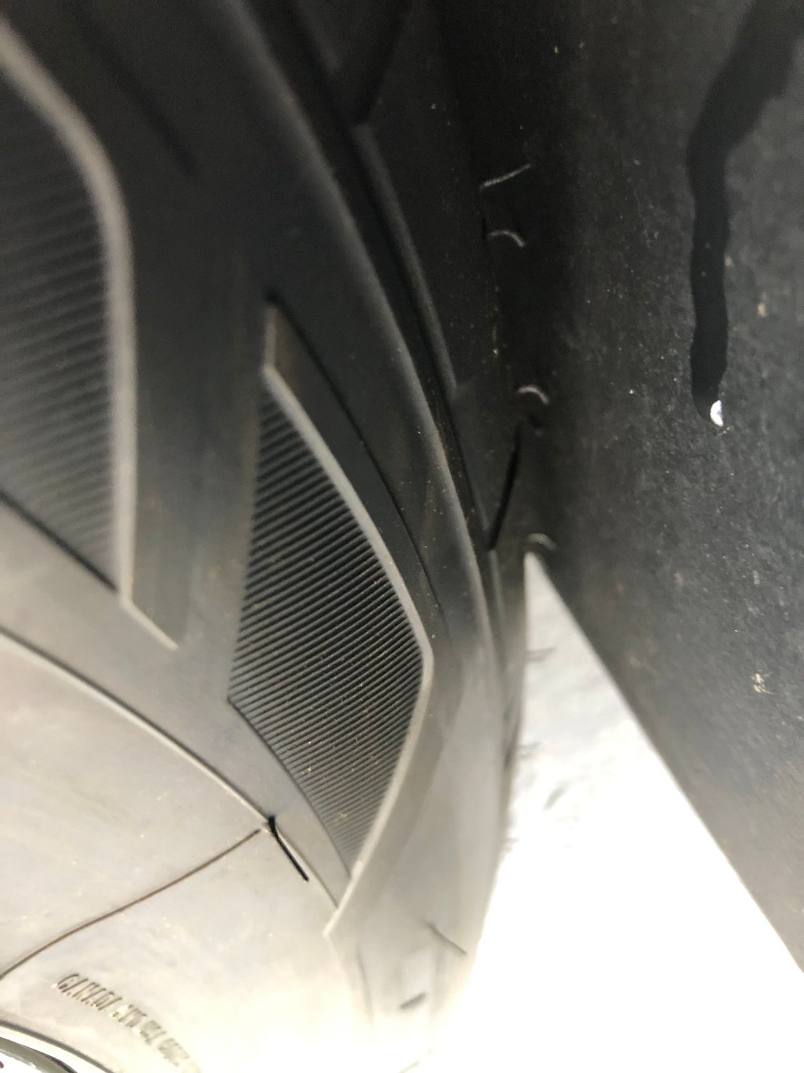

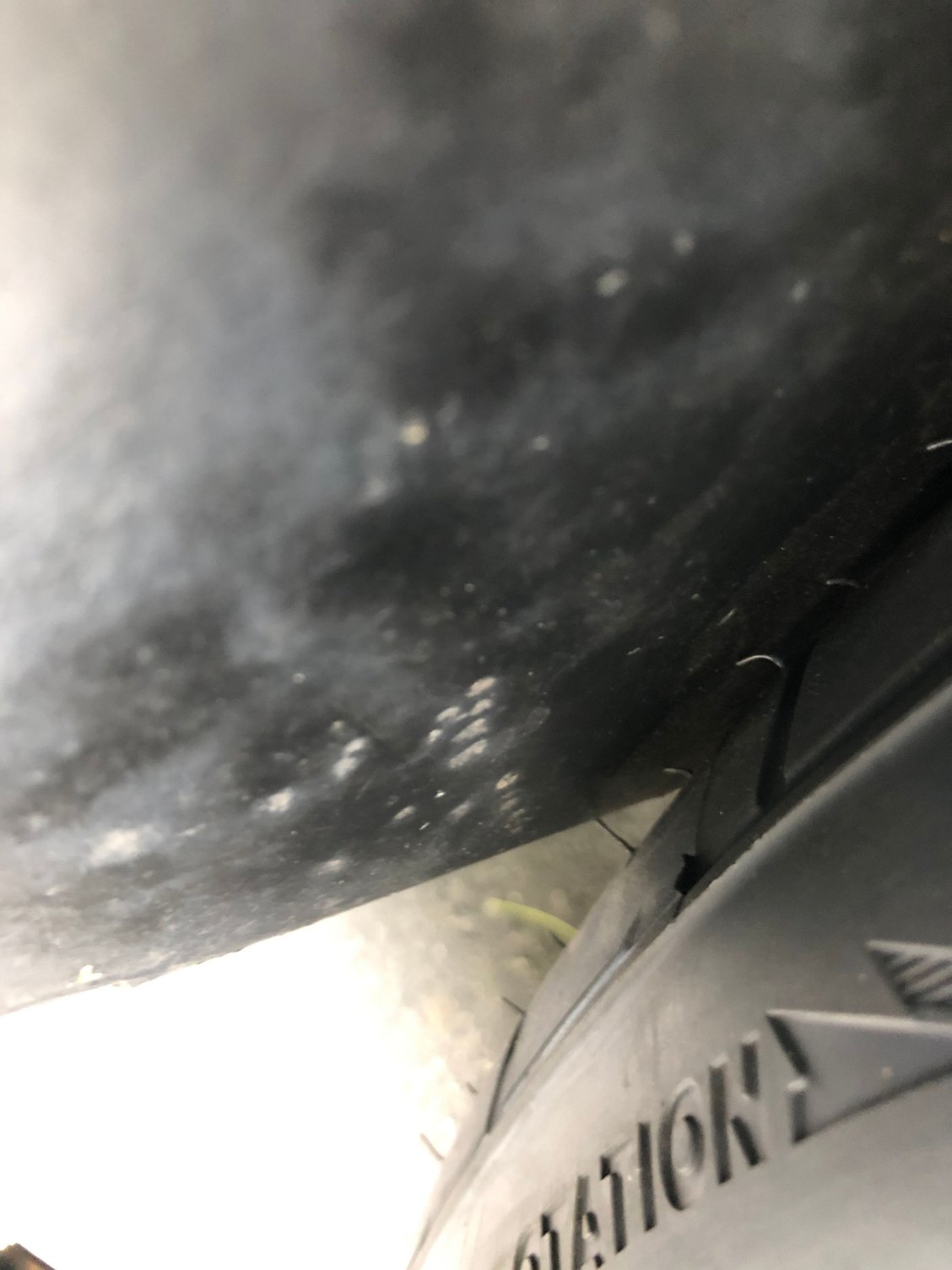

The rears are fine. The fronts are bad . The calipers just clear. Could be the weight in the front end.
as soon as I can get the pics out of my phone I will post them
That is hitting
