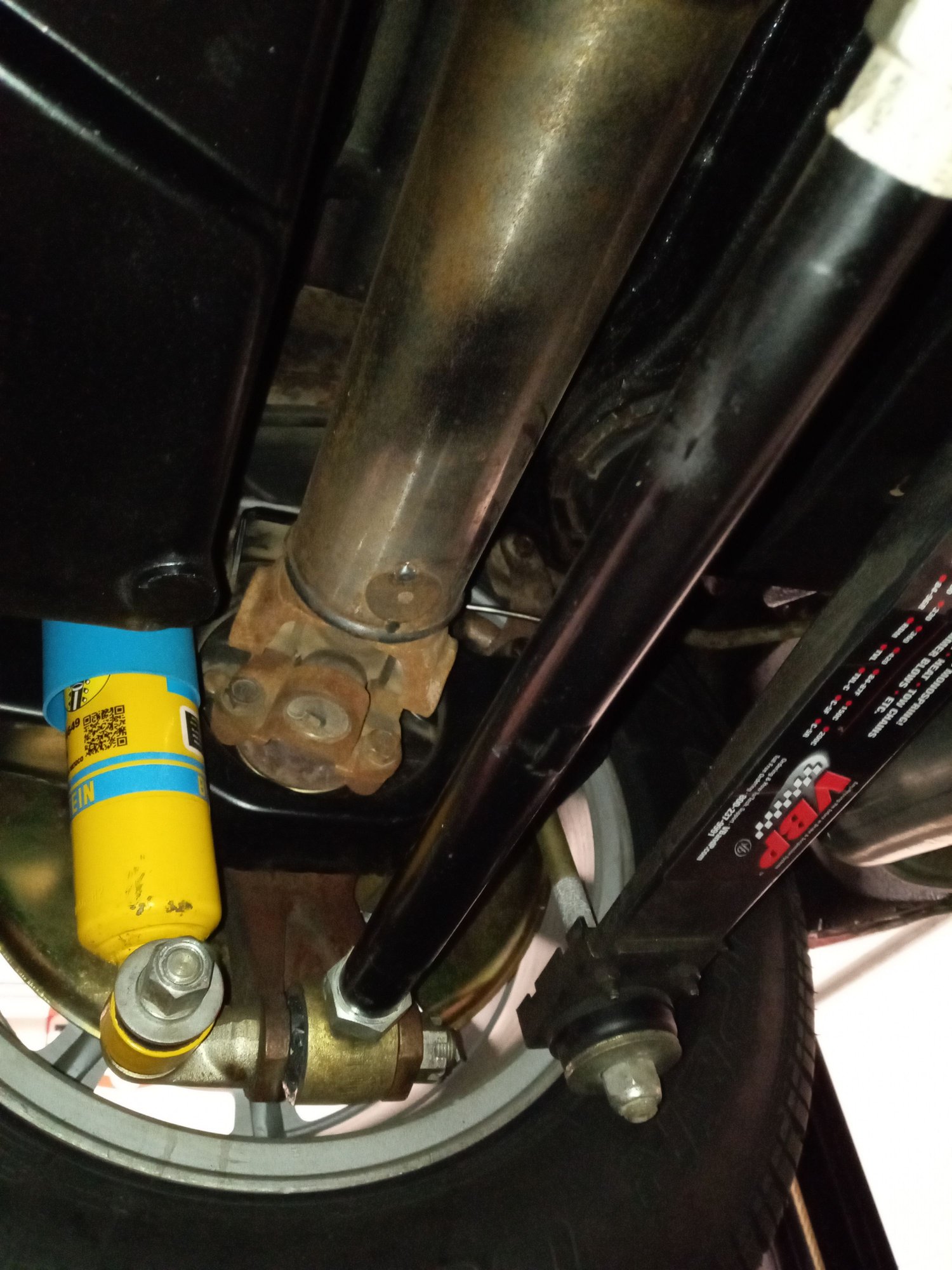

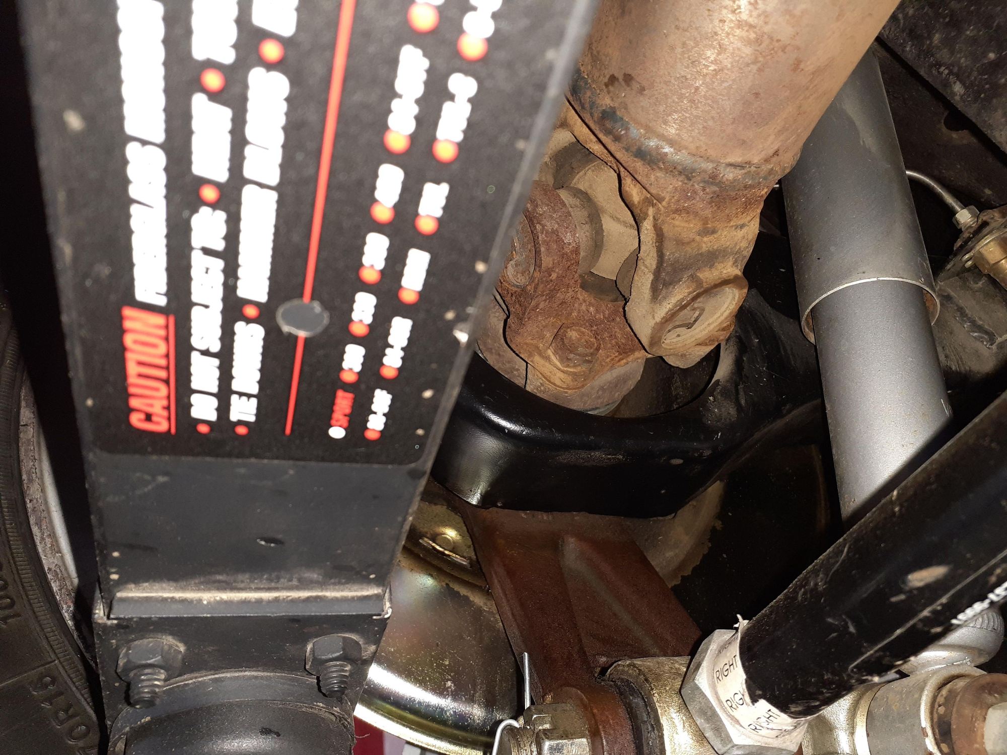

I purchased this last year and the past few times I took it out, I started to notice that the rear end seems to be too soft. My street is in need of new paving but for now there are quite a few dips and heaves in the road. Seems like the car is really bouncing over all of them. Here's a shot of what is installed, just wondering if there is a way to stiffen up the ride.

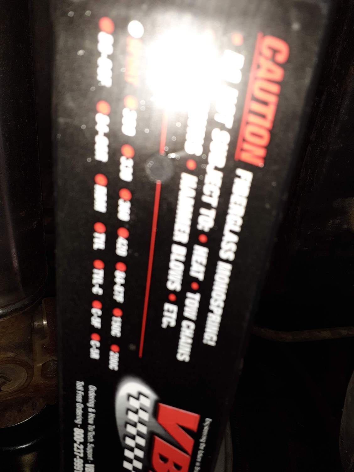

You have a composite rear spring, cant make out which rating is checked/punched out on the label but if it is 330 you already have a stiff spring.
What shock brand are those?
I suspect the shocks, invest in a good set of Bilsteins.
Looks like silver overspray on the rotting lower shock bushing.

Shocks are KYB, I think the spring is checked off as Sport.

Might be camera and maybe not related but is that shock mount bent? And that rear caliper is or was leaking.
or bushing shot as mentioned does not help.

Calipers were leaking but I recently replaced them and the rotors. I'll check the shock mount, didn't notice the angle before.

While I'm waiting for the shocks to arrive I decided to start removing the KYB's. I checked the mounting plate for the monoleaf spring and found all four bolts were loose and 1/4" out from final location. The plate rattled when I hit it so I checked the mounting bolts, nice surprise! Rockauto is sending the shocks from opposite side of the world so I won't have them till next Tuesday. Hindsight I should have paid more for a local provider and would be done by now.
