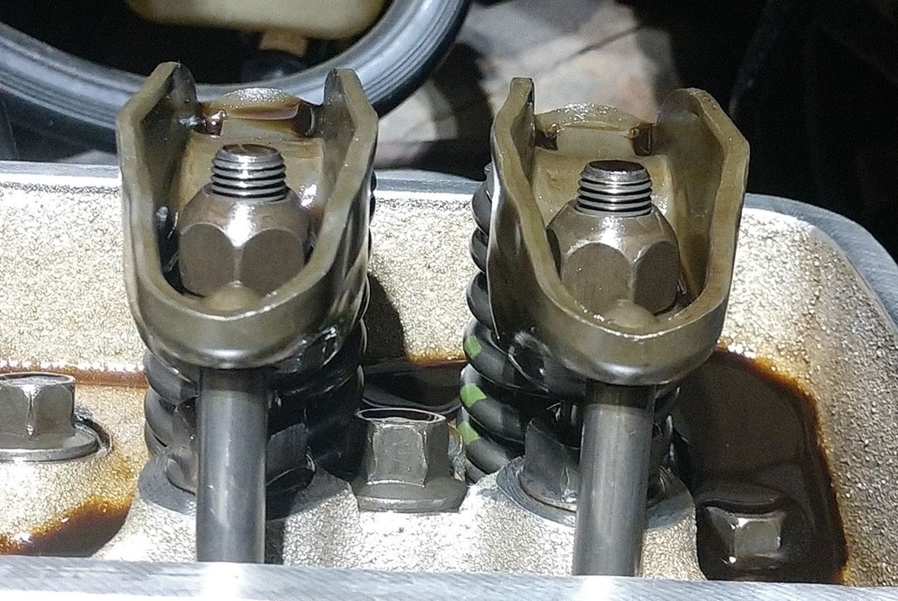

Compression is 150. Made a new spark plug wire but the cylinder is still not working. Took the cap off and everything looks ok. Letting it cool to remove the valve cover. Ugg.

Valve train looks good. Valve move up and down nice. On compression stroke the pushrods will turn with my fingers with a little resistance as I expected and the lash is good (ZZ4 is zero + 1/2 turn). Back to ignition I guess. I did tear the cap boot so I've got some on order.

It's fixed. Had my son turn over the engine while I watched the valves. They are opening/closing just fine. It's hard trying to see the valves and hold the clutch pedal in at the same time
Turned out being the plug wire. I replaced it, used my old points file to file the rotor and cap, new wire ohmed out to 116ohms vs the old wire in the K ohms range which I think was causing the spark to be weak enough to get blown out instead of igniting the air/fuel. That is why the timing like still showed electricity in the wire so it was just enough to strobe the light. Started it up with my TC connected and the temp went up where the other cylinders run @500ish on the header right near the head.
