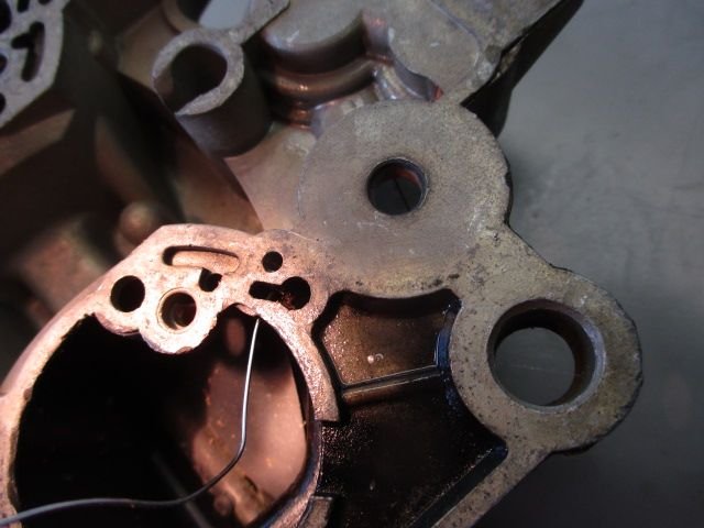

To clean out the blockage, you need to removed the airhorn and flip it upside-down.

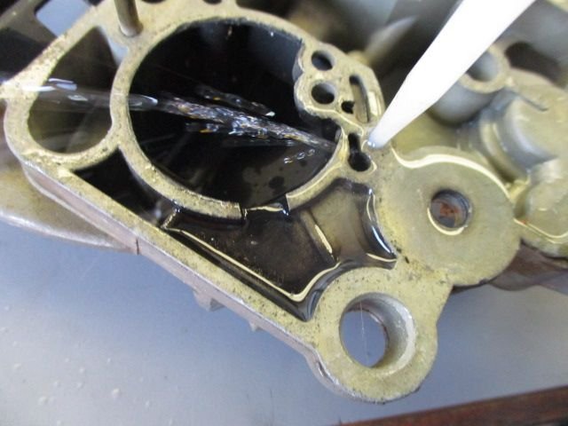

The accel pump passageway runs from the upper venturi-area of the carb, and consists of 2 holes: The first hole is from the venturi area into a "key-shaped" plenum. From the "key plenum" the hole continues in a straight line into the actual round accel pump passage channel. The hole is small: I use a 0.020" safety wire to "stake" it out. It's a little tricky getting the wire fed through both holes and all the way into the round feed passage, but you have to make sure you get the wire all the way through both holes:
To verify you got it, use a squirt bottle with solvent (I use IPA) to test and verify that you have a clear and strong discharge from the round passage all the way through. If you don't get a solid stream of fluid shooting out the discharge hole, you don't have it unplugged:
It's seldom that the hole from the key plenum to the venturi is plugged. The hole that gets plugged is the tiny hole from the round feed passage to the key plenum.

Thanks, Lars. Pulled the carb off tonight and cleaned out the accelerator pump passages as you suggested. You were 100% correct. Not sure what was plugging up the passage but once it was cleaned out we got two good streams of fuel. If it weren't for your advice, we might have figured it out eventually but it would have taken us all night. The car runs great, the problem is solved, and the owner is happy. To my ear the engine could use a little more pump shot though. Is there some way to increase the pump shot volume on a Q-jet?
